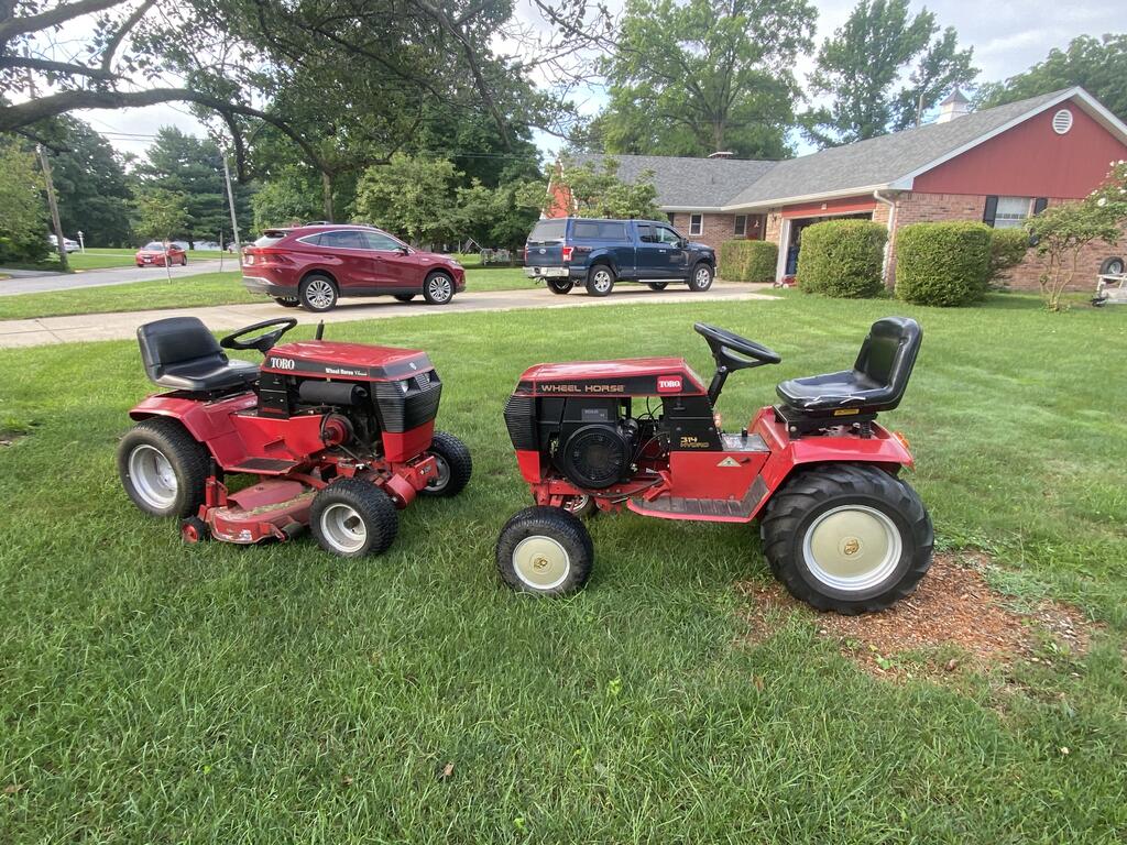

ohiofarmer 3,475 #1 Posted September 15, 2022 I sold a Black Hood 141 or 145 to my nephew that suited his needs. i then used the proceeds plus a bit more to buy a 314 with manual transmission. i took it to a rental property which had a steep hill in front of the house about 3 feet high and at a 45 degree angle. She is a very tight tractor and the deestone tires are in good shape. they were flexible enough to crawl right up the hill and cut that grass at the apex. My backup was a DeWalt string trimmer which was of course out of line, but that 314 saved me a trip to the store. Two happy people. my nephew has an automagical transmission mower , and i have a very fresh replacement for a go to extra. I never use a machine for rental mowing without a thorough deck clean because of spreading plantain seeds to my home yard. dad had tons of them as I was growing up and the seed stalks took only a day or so to make the yard look a mess. All the 314 needs is a jump wire to the solenoid to make it totally reliable as the seat switch safety is a bit sporadic to start the machine 6 Share this post Link to post Share on other sites

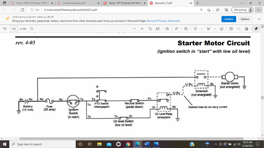

953 nut 69,161 #12 Posted September 19, 2022 On 9/15/2022 at 9:37 AM, ohiofarmer said: to make it totally reliable as the seat switch safety is a bit sporadic to start the machine The START wiring on a Wheel Horse doesn't go through the seat switch, just the PTO and CLUTCH switches and oil sentry switch relay if so equipped. 1 Share this post Link to post Share on other sites
ohiofarmer 3,475 #13 Posted September 19, 2022 5 hours ago, 953 nut said: The START wiring on a Wheel Horse doesn't go through the seat switch, just the PTO and CLUTCH switches and oil sentry switch relay if so equipped. That is good news. Maybe I should have mentioned that the Christmas Tree light panel is not lighting up as well. Probably about time to start a new discussion in the electrical threads Share this post Link to post Share on other sites
