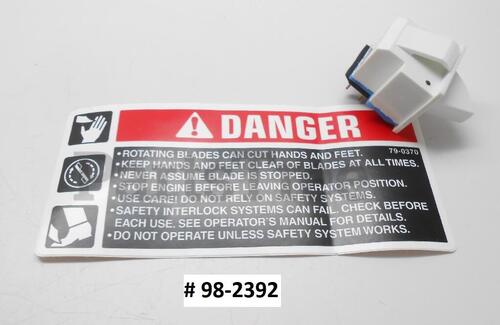

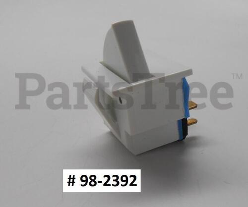

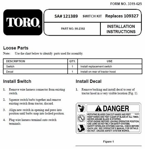

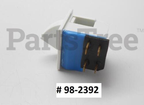

109327 replaced by 98-2392 Rocker switch kit (Wide terminals are NO=Normally open for starter circuit) (Narrow terminals are NC=Normally closed for ignition circuit) - White
98-2392 is a replacement kit following tractor production to address a recall
Service bulletin - 1983-1984 A-Series, 1983-1984 RR-Series, 1982-1984 GT-Series and 1986 models 211-3 and 211-5
