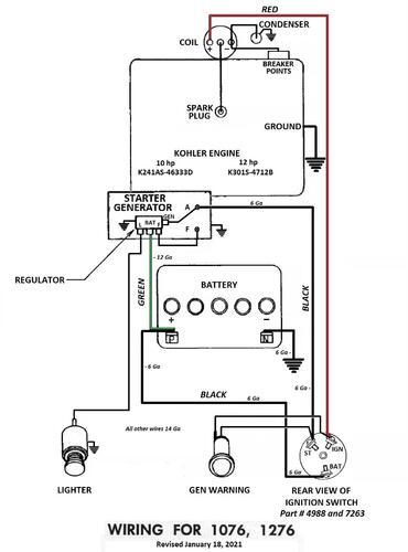

Wiring Color pdf
1 page 316KB

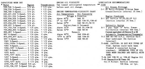

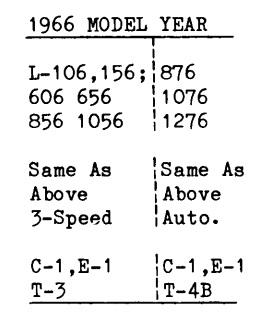

Lube chart SS

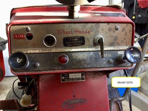

1966 model 1076 - D&A n/a Used Kohler K241AS-46333d
1966 serial numbers that have shown up for the 1076
183003
183004
183024
183358 - May be 188358
183520
214071 - See PSB #073 Nylon clutch pedal bushing changed to bronze after this serial number
214242
214522
214605
214619
214718
214731

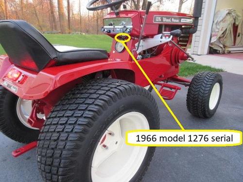

1966 model 1276
1966 serial numbers that have shown up for the 1276
154770
181640
181666
181899
205165
205328 - See PSB #073 Nylon clutch pedal bushing changed to bronze after this serial number
205910
205930
253226
