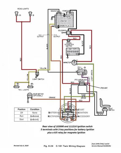

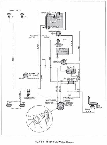

Wiring from SM
2 pages 82.81KB
Wiring from SM Color pdf
1 page 344KB
