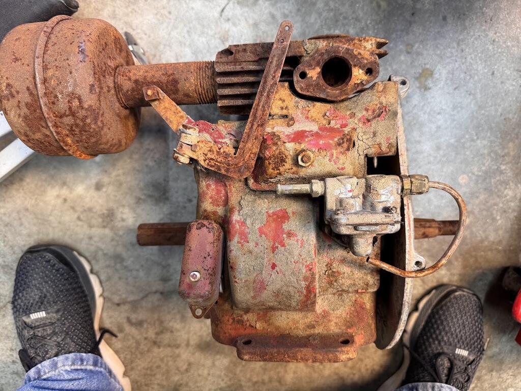

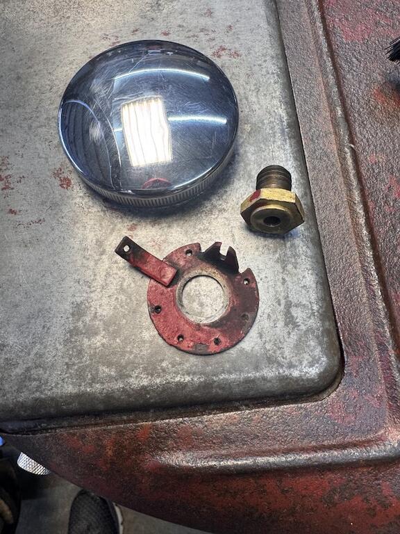

    My K161 Spec# 28626 is missing the extension on the disc, dramatically reducing the throttle lever travel to about 1" between idle and full throttle.
    Hoping someone might be able to help me out with the correct one.  I've searched eBay and other sources with no success.

    Many didn't have that little hoobie doo. I suspect stationary engines. I have brazed a few on easy enough to do.
    Didn't @squonk have some small block parts?
    Yes much better throttle with it.
