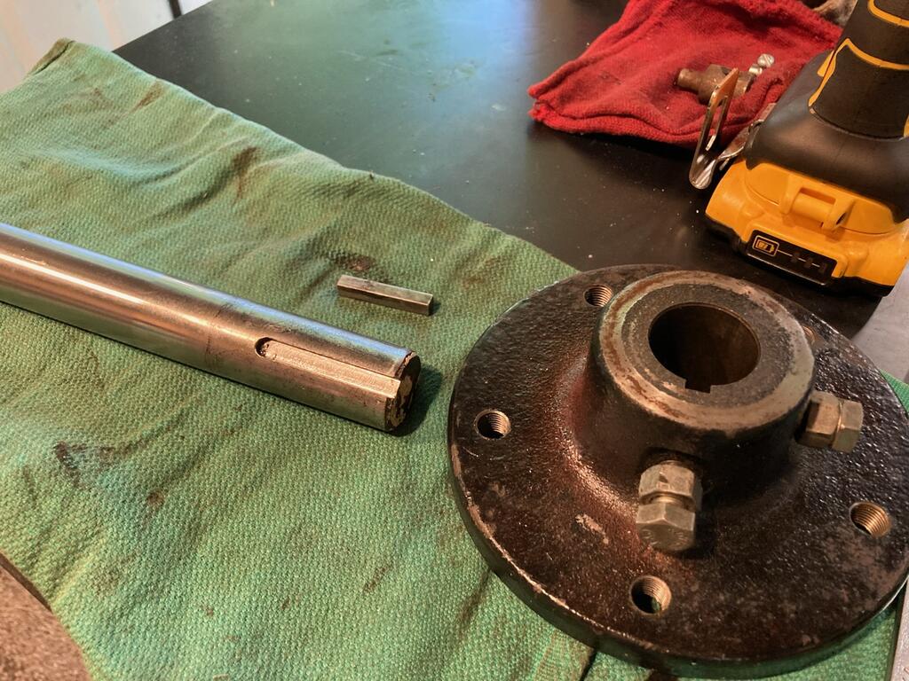

    The axles on my 1976 C-120 Auto are shot. I'm looking for a good set of axles, diff assembly, or a complete transaxle.

    IMG_2472-EDIT.jpg.477e35db25ca3d7720c2db121a1867e8.jpgIMG_2467.jpg.a6c704782b80829995ec34775a3fad23.jpg

    Thanks, but I already tried these.
    They worked great for about a year but began slipping when I was pulling on a heavy trailer. I torqued them to spec, but now thinking I should have went tighter.
    Now they slip no matter how tight I try and get them. I ended up snapping off one of the bolts from torquing on it too much.
    The axles are really mangled now.
    Unless you come across an easier solution, you're going to have to open the case and pull the axles. If it was me and the keyway is the only issue, I would have new keyways cut 180* from the originals. I've done that before and just used straight 1/4" keys. Just don't cut them at 90* or you might lose where you need to have the second set screw.
    Yes, the axle tolerance is about .005 under for these tapers. I had an axle that was almost ten under and the hub would slide around. I did get those hubs to work.
    I blocked the back of the hub with a piece of bar steel, taped (not hammered) the taper in, re torque the bolts, and repeated several times until the taper flange was almost up-against the hub. Has been holding on the xi machine with fluid filled tires over a year now.
    Yeah, I think I left a lot on the table the first go around. I used some grade 8 hex head bolts this time and have been able to draw them a lot tighter. Even if it grips, I still want to replace the axles at some point. Another Red Square member has made me a fair offer on a complete differential.
