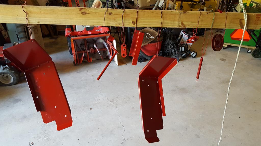

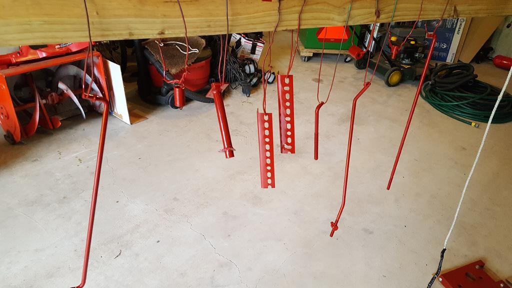

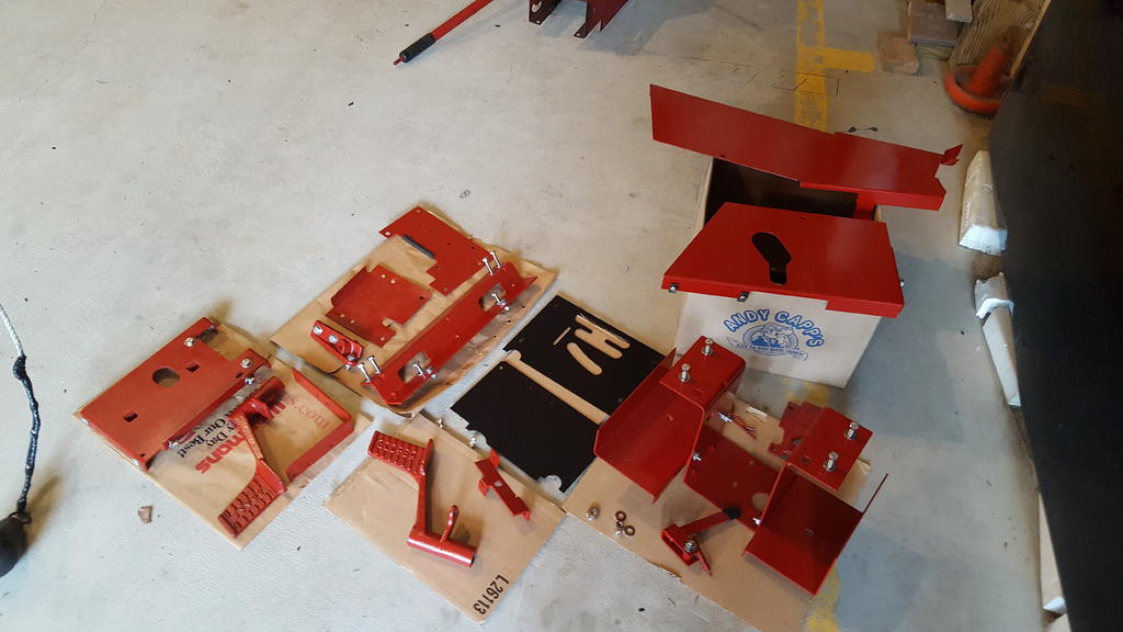

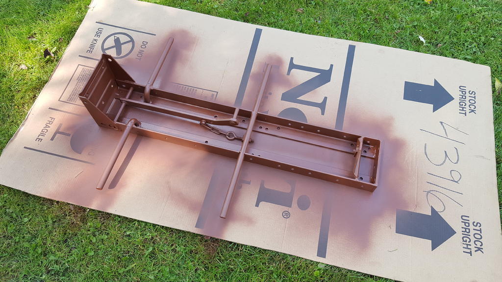

Update 9/10/17
I now have most of the parts painted and ready to go back together. Things are starting to look very good. I also have been working to swap out all the bolts for new stainless steel ones. The biggest obstacle yet will be the transmission still. I havent got the hubs of yet to change the axle seals, but I do have a brake rotor that the holes line up perfectly with. Now i just need to get ahold of a pulley puller to pull the hubs off. Should I be concerned with the condition of the gasket between the two sides of the transmission?

Painted parts look great.....:text-coolphotos:
