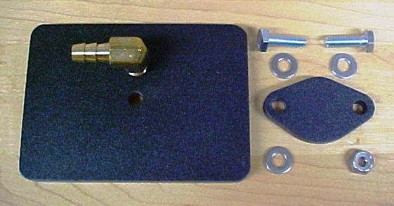

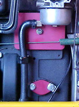

Waiting on the eBay electric fuel pump to show up for the C165. Only thing I'm not sure about is what to do with the old mechanical one. Do I just leave it in place or do I need to make a cover plate with the a gasket and remove it?
Covers can be bought for the fuel pump hole, but I would be inclined to put a loop of hose from out to in and leaver it unless it gives a problem.
  • Like 5
leave it.
  • Like 1
that's what I did
  • Like 2
Perfect thank you!
Can be had here http://www.kirkengines.com/
He's got real nice electric pumps too.... A little pricey but nice!
  • Like 3
