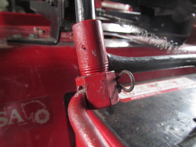

Ed Kennell 35,770 #51 Posted June 18, 2017 9 minutes ago, mikeeyre74 said: How did you attach the end of that foot control rod setup there to the hand control? I can't quite make it out in the picture.... ? I use a 3/8" pipe nipple that slides down over the vertical hand lever. I cut a slot to clear the horizontal lever and lock it with a pipe cap that is drilled for the foot control lever. 5 Share this post Link to post Share on other sites

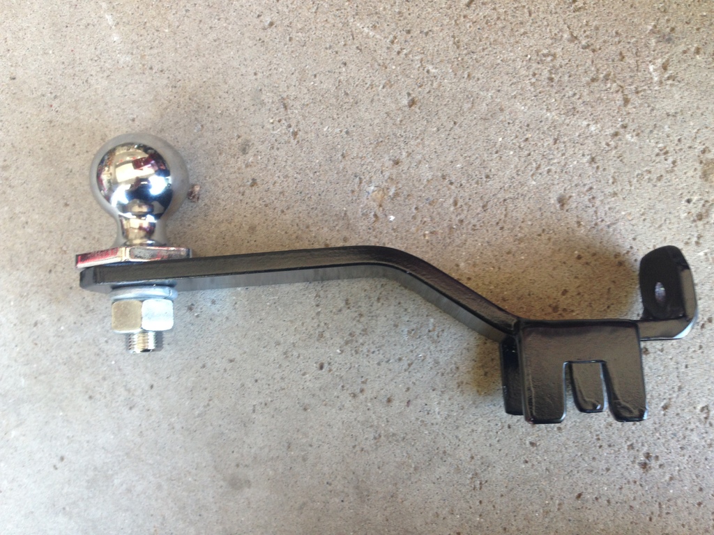

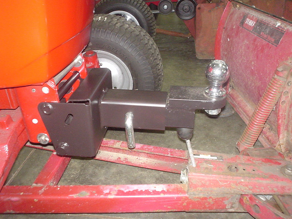

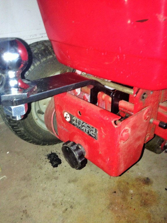

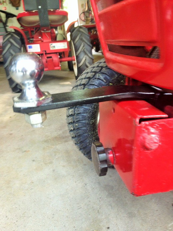

SylvanLakeWH 24,130 #54 Posted June 18, 2017 3 hours ago, Lane Ranger said: Front ball hitch on 314-8 and B-80 Wheel Horses I have been wanting a front hitch that allows me to keep the mule drive on!!! Any design / close up pics of how it's attached? That is exactly what I need (er want)... 3 Share this post Link to post Share on other sites

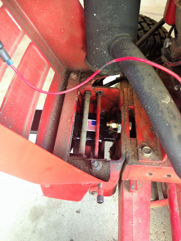

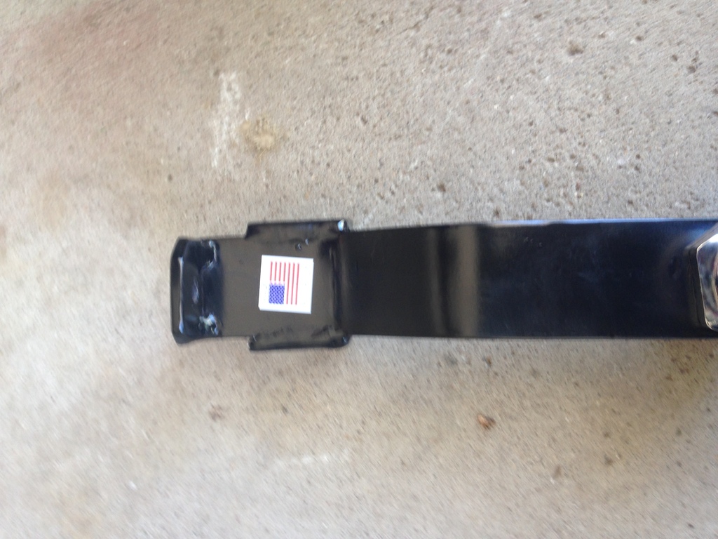

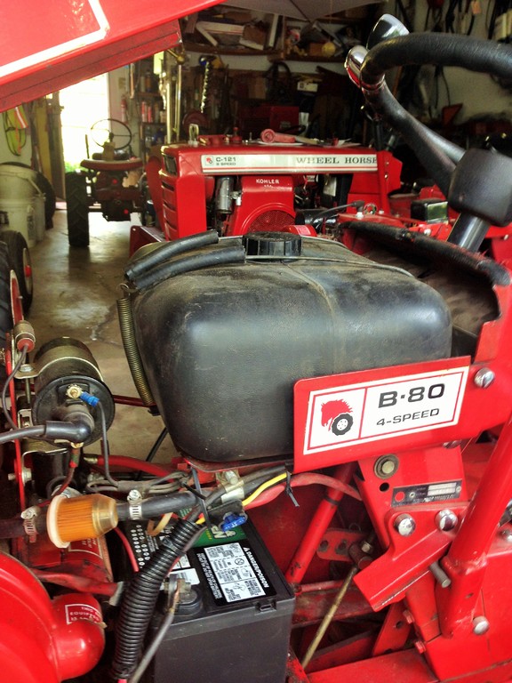

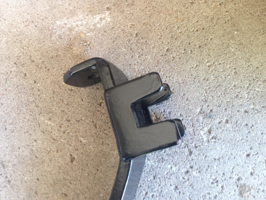

Lane Ranger 10,495 #55 Posted June 18, 2017 Sold on Ebay but you need to give exact info on your model tractor to the seller and maker. Here are some more pics First version has more of a goose neck that I put on my 314. It would not clear B-80 hood with mule drive. The second version has more of a flat line design to clear the B-80 hood for opening to refilling the gas tank and allow the mower deck mule drive to lock in place. Both front attach hitches have the same up front deign with a hex bolt holding up the front in center and the U shaped plates on each side of the hitch clearing but allowing the mule drive to fully operate in place. There is nothing like operating a front hitch to haul thinks around. There were both made by Leonard Cooke of Rhode island who makes and sells them online on Ebay. He will work with you on any issue you may have with your hitch purchased based on my experience. 5 Share this post Link to post Share on other sites

Ed Kennell 35,770 #57 Posted June 19, 2017 12 hours ago, mikeeyre74 said: And for reverse you just slip a toe Underneath the pedal and pull back, like upshifting on a motorcycle? Actually Mike, I have a spring and/or a pneumatic cylinder that pulls the pedal up directly into reverse. For safety reasons, I do not recommend this arrangement to anyone. But for me, It works. To start the engine, the left brake pedal must be pushed, which moves the motion lever to neutral making the neutral safety switch allowing the engine to start. Then the motion is controlled with the right pedal....push down for forward and release pedal up for reverse. With very little practice, I can completely control F/N/R with the pedal. If there is any concern or indecision, simply push the left neutral/brake pedal and the tractor stops. I find I still use the hand lever when I am turned in the seat to back up to an implement or into a tight space. I have the same arrangement on all my hydros and find it to be very efficient for plowing and blowing snow in the half dozen confined small driveways that I clear. For the system to work, you must also alter the console cover to a straight slot so the motion lever moves in one plane front to rear. I also relocate the spring that normally pulls the motion lever to the left into the neutral lock position so it now pulls the lever to the rear into reverse. Not recommending..... be your own judge of your abilities. 5 Share this post Link to post Share on other sites

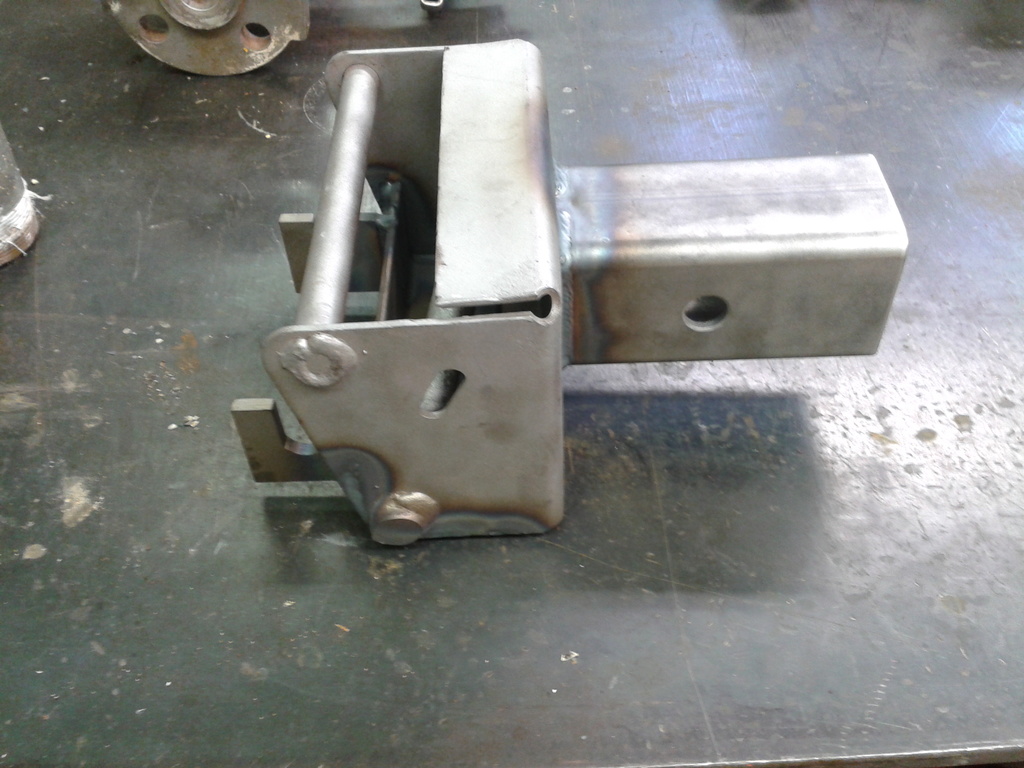

SylvanLakeWH 24,130 #58 Posted June 19, 2017 On June 15, 2017 at 10:30 PM, cleat said: Front hitch made from old mule drive. NICE WORK! Is that 2" tube just welded to the front of the mule drive? No additional bracing in the back? I'm thinking that I could do the same and maintain functionality of the mule drive adjuster knob so I can have the hitch mounted to a standard mule drive while the mule drive does its mowing duties as well... Thoughts? 2 Share this post Link to post Share on other sites
cleat 4,984 #59 Posted June 19, 2017 6 hours ago, SylvanLakeWH said: NICE WORK! Is that 2" tube just welded to the front of the mule drive? No additional bracing in the back? I'm thinking that I could do the same and maintain functionality of the mule drive adjuster knob so I can have the hitch mounted to a standard mule drive while the mule drive does its mowing duties as well... Thoughts? There is more to the back. A piece of angle iron and a couple of hooks. Here are the plans. Wheel Horse measurements for front hitch.pdf Wheel horse parts list for front hitch.pdf Cleat 3 Share this post Link to post Share on other sites
SylvanLakeWH 24,130 #60 Posted June 19, 2017 49 minutes ago, cleat said: There is more to the back. A piece of angle iron and a couple of hooks. Here are the plans. Wheel Horse measurements for front hitch.pdf Wheel horse parts list for front hitch.pdf Cleat OK - Thanks! I appreciate the details! 2 Share this post Link to post Share on other sites

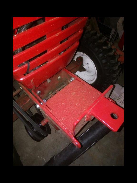

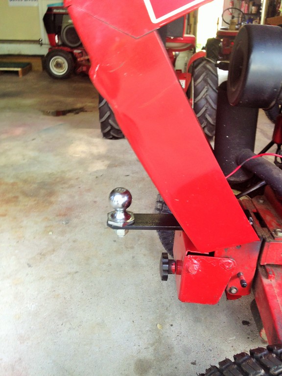

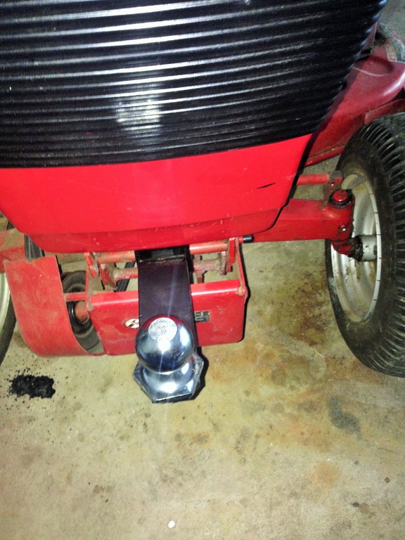

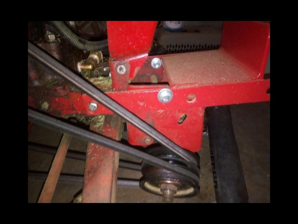

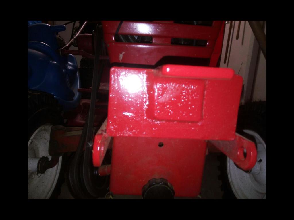

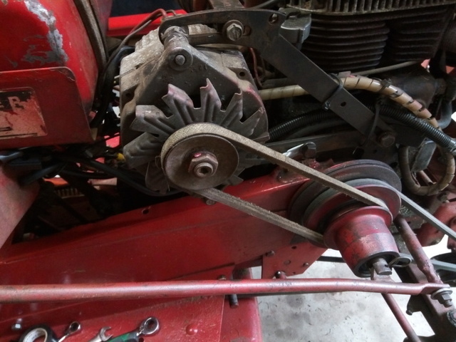

mmmmmdonuts 274 #61 Posted June 20, 2017 (edited) Here is what I did for the the front hitch. It mounts to the front tach a matic and the frame. It also allows me to use the mule drive for the mower at the same time. By having the setup to the side of the mule drive it still allows pulley adjustment without moving the hitch up or down. I use the hole up front for a hitch balls or a threaded rod with small weights. The platform I have used for weights to keep the front end down when I move my trailer around the yard. The other modification I did is add an alternator GM SI10 alternator to the electrical system possibly to use a winch in the future or linear actuator or other high current draws. Edited June 20, 2017 by mmmmmdonuts Added a sentence 6 Share this post Link to post Share on other sites
elcamino/wheelhorse 9,046 #62 Posted June 20, 2017 I like the alternator idea, but I am clueless on how to hook one up to my tractor. Share this post Link to post Share on other sites
mmmmmdonuts 274 #63 Posted June 20, 2017 8 minutes ago, elcamino/wheelhorse said: I like the alternator idea, but I am clueless on how to hook one up to my tractor. I posted a fairly detailed setup in this post and if you have any questions I would be glad to help. http://www.wheelhorseforum.com/topic/66121-electrical-upgrades-voltmeter-and-external-alternator/ 1 Share this post Link to post Share on other sites
SylvanLakeWH 24,130 #64 Posted June 20, 2017 (edited) 24 minutes ago, mmmmmdonuts said: Here is what I did for the the front hitch. It mounts to the front tach a matic and the frame. It also allows me to use the mule drive for the mower at the same time. I use the hole up front for a hitch balls or a threaded rod with small weights. The platform I have used for weights to keep the front end down when I move my trailer around the yard. Thank You! That is slick! Any more pics showing how it connects to mule drive and tachomatic? You could also use it to mount a winch plate pretty easily... I like Cleats' design shown in a previous post as well, but I really like how this one allows use of mule drive and doubles as a front hitch... Edited June 20, 2017 by SylvanLakeWH 2 Share this post Link to post Share on other sites

mmmmmdonuts 274 #66 Posted June 20, 2017 I attached some more photos. Originally, I used this mounted to the frame without the newer tach-a-matic style mower deck for my frame. I then modified the mower to use the tach-a-matic system with a mule drive and drilled a few extra holes in the bar for extra mounting locations. If I was to do it again I would have used a wider bar so it would sit slightly higher than the front tach-a-matic. This is on a 1968 Raider. 2 Share this post Link to post Share on other sites
