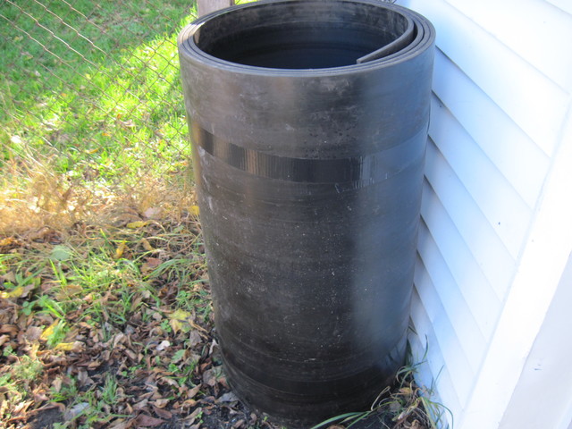

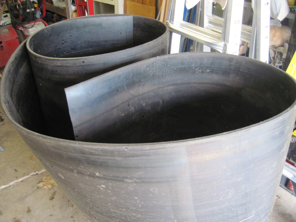

Walt 339 #2 Posted November 4, 2016 (edited) Was able to get a roll its 36" wide by approximately 17' long. I figure I could make about 32 pieces out of it. Unsure how much interest there is from our membership in having a piece of it to their decks to help keep the lawn clippings from blowing up on trans-axle. Reason I suggested having a member meet and bring to big show is I don't want to deal with shipping them since I'm giving them away. Since I already have top of my tool box with some I got 20 years or so ago I may take piece for protecting top of work bench for when I have metal items on it that could gouge surface if interest is low. Edited November 4, 2016 by Walt 2 Share this post Link to post Share on other sites

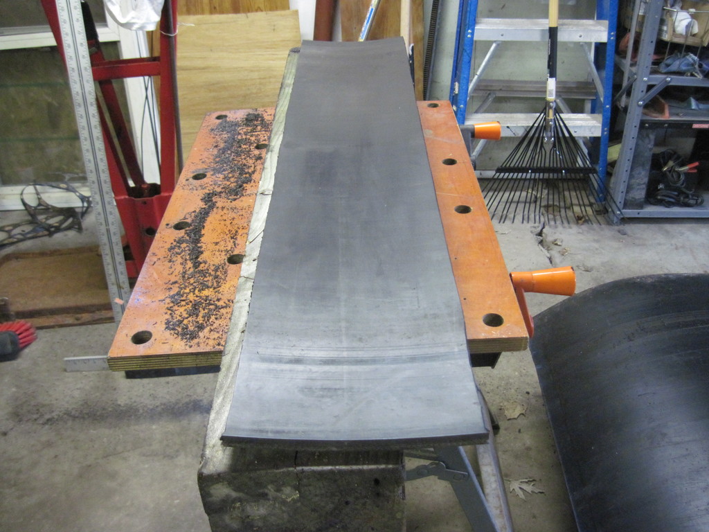

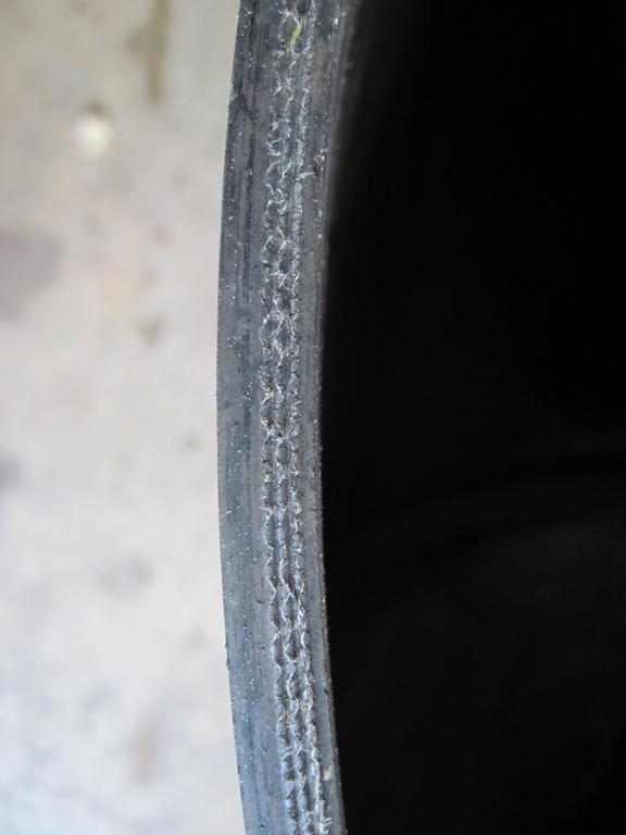

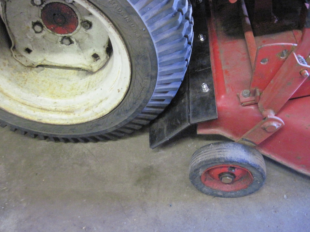

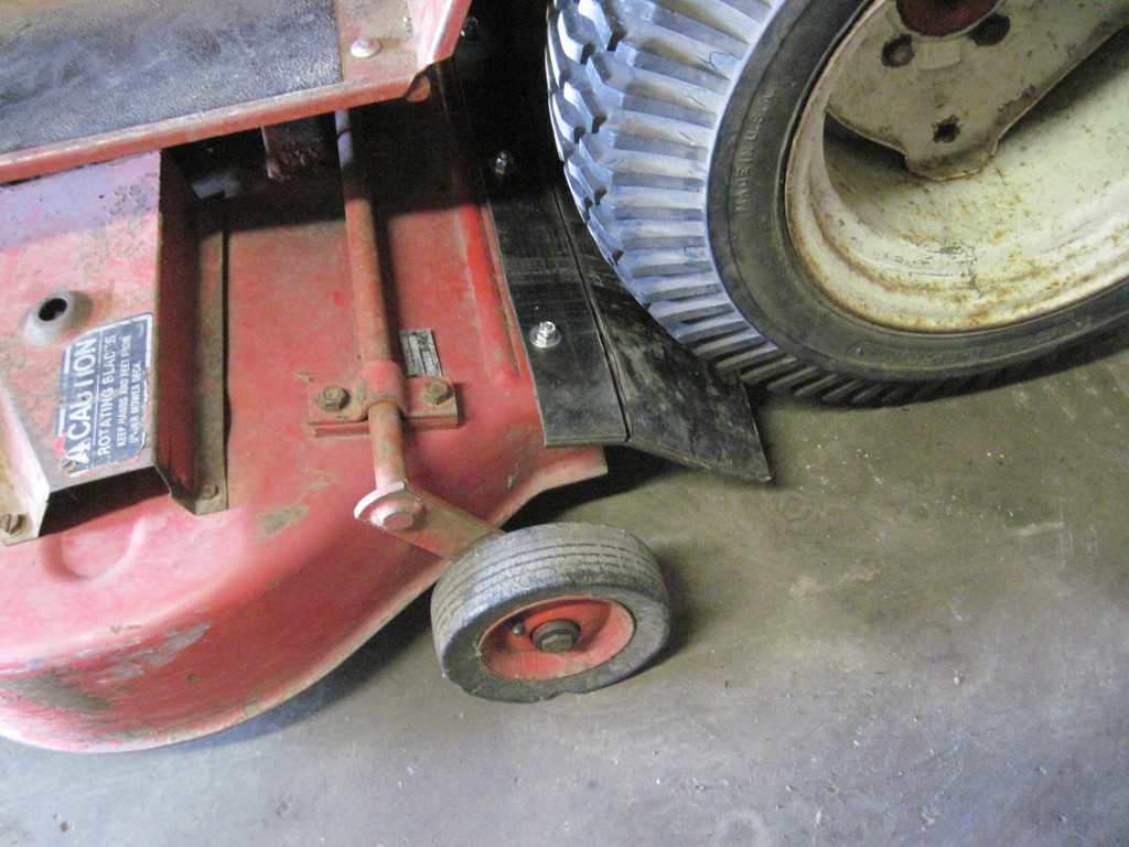

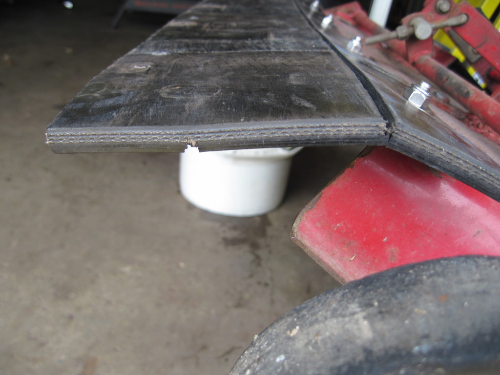

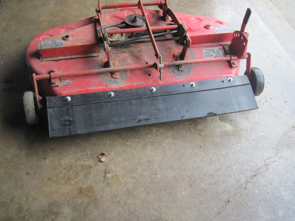

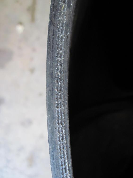

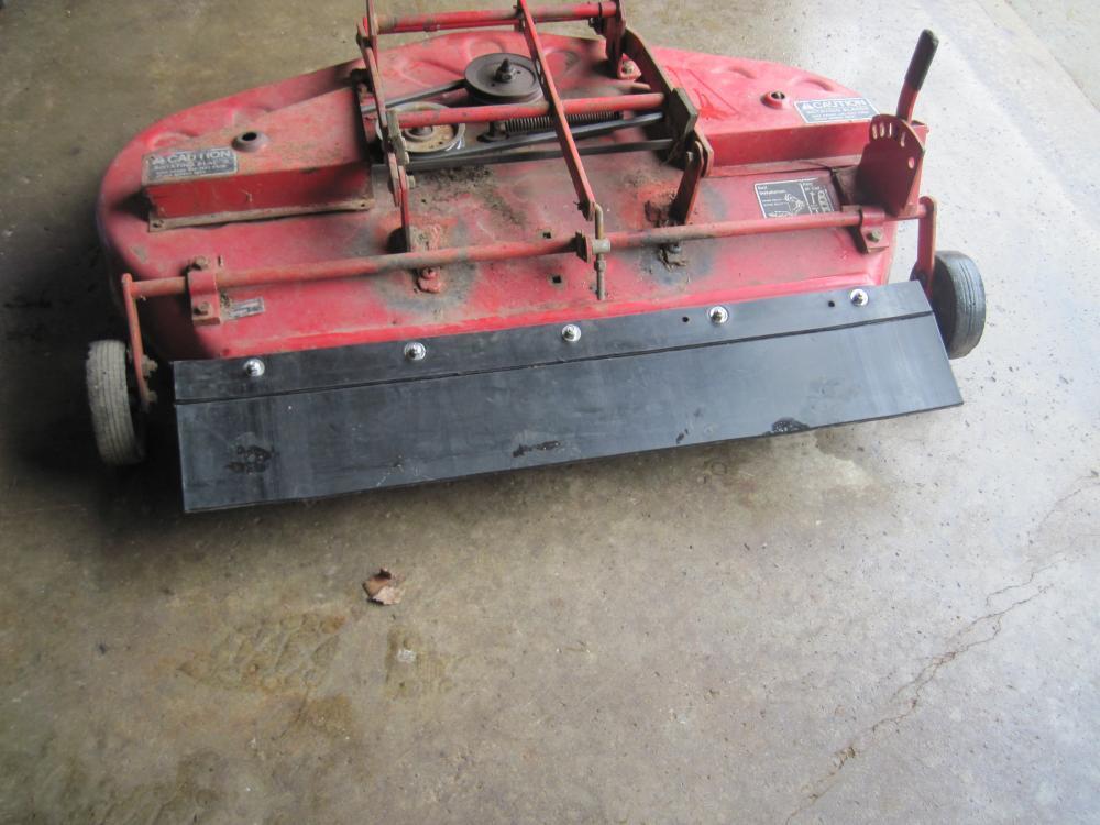

Walt 339 #14 Posted April 26, 2017 On 11/4/2016 at 4:18 PM, elcamino/wheelhorse said: I would be interested in two pieces for my 36 and 42 inch decks. Gladly pay for them in advance if you can find a way to get it to the Big Show. That looks like some tough material. On 11/8/2016 at 4:43 PM, Wishin4a416 said: I would take one for a 42" RD if you have enough. I was going to use some rubber roll roofing but it is not near as heavy. I plan on going to the big show. Thanks! I worked on this project a couple of times in last week. I decided to cut one for my mower deck at 7 inches leaving it 3 foot wide. Being as thick as it is I figured cutting a relief for flexibility to allow it to droop down would be a good idea. If you view the pictures you will see that the fibers embedded in the belt are closer to one side than the other. I choose to leave most of them intact only cutting to a depth that would leave at least one layer of them for strength. After drilling mounting holes (yes 2 holes are off by 2" ) I used 5/16 x 1" carriage bolts, flat washers and lock nuts for mounting. This first attempt didn't give me the desired droop I was looking for. Today after taking care of couple of other things I had some time to get back on this project. I removed piece I made and decided to cut to a depth that cut through all the reinforcing fibers to see if it had the flexibility I needed. It now drops down which will divert grass clippings towards the ground and did not catch on the tires when backing up. I would like to cut the required number I need to fulfill any requests in next week while we have a number of rain days that will keep me from doing outside projects. elcamino/wheelhorse and Whishin4a416 were the only 2 to state interest when I first posted this thread last fall. I will cut the 3 pieces to fulfill their requests tomorrow. I would like to clarify I am only cutting the strips the drilling of mounting holes and cutting of relief will be responsibility of each member to fit their individual needs. I will give these helpful hints for cutting and drilling. If cutting through entire thickness ( incase you don't want it 3' long or 6" instead of 7" ) a jig/saber saw with coarse blade works best. For cutting the relief a circular saw with blade set to a depth of 5/16" worked for me. As for drilling holes if you have a spade style wood bit like one I added picture if drill from side fibers are closest to till you just poke through other side then flip part and drill through to open hole. I used a 25/64 (1/64 larger than 3/8) regular drill bit for first holes I did and pushing bolts through was to much like work. Any other members going to the Big Show wanting a piece of this material please let me know soon so I can get them cut and packaged for transport. 2 Share this post Link to post Share on other sites

Walt 339 #16 Posted April 27, 2017 2 hours ago, elcamino/wheelhorse said: Walt , thanks for remembering me . can I pay you for the material? I have printed this so I will remember how to cut and drill the material. Thanks Again Like I said previously I don't need you to pay me for them. But since Glen Pettit offered to bring them to the show, I would appreciate you getting him something cold to drink for his time and trouble. So far with PM I got today I may only be cutting 2 for you. Thinking I may cut some for my bench top to protect it when I have parts I'm working with on it. I did notice in one of the pictures I posted today the end with it mounted looks like it split where I cut the relief. It did not split I made that cut all the way through to hold end of chalk line for marking a line to follow when cutting the relief. Share this post Link to post Share on other sites
