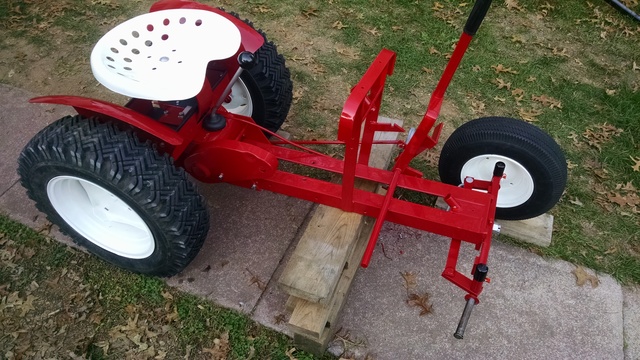

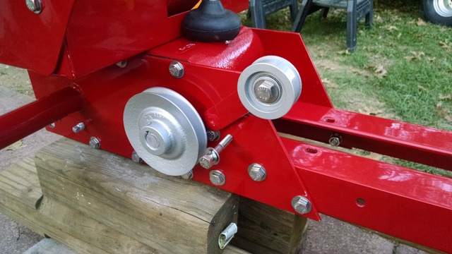

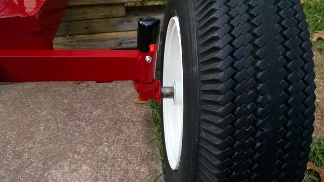

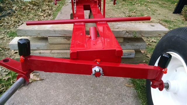

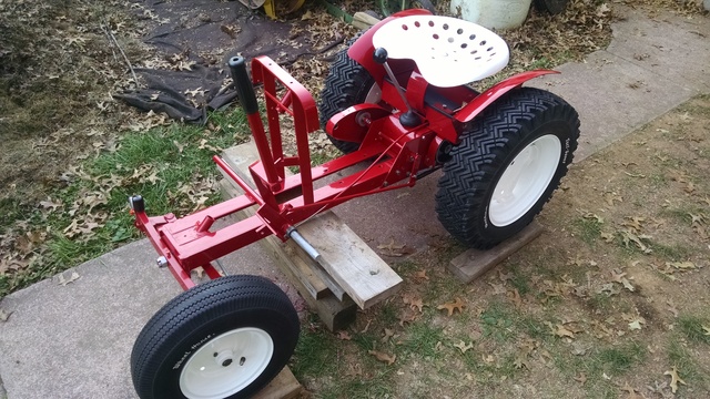

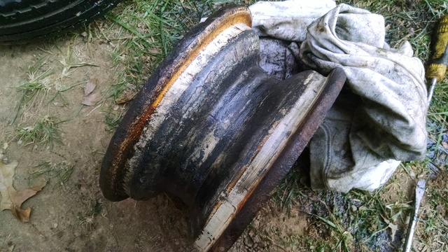

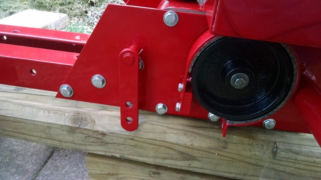

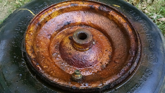

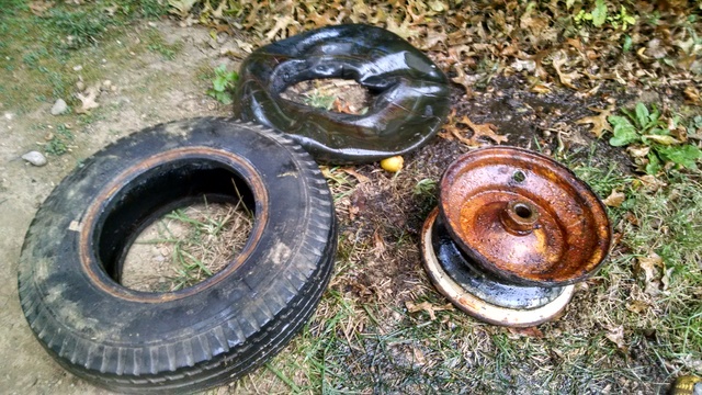

Got some more work done on the RJ today, although I ran into bad news. I'll get to that shortly. Anyway, I got the frame all polished up and after running to the hardware store for more stainless steel bolts, nuts, and washers, I was able to get it attached to the transmission. I also polished the front axle and spindles, so they were all assembled as well. After getting the idler arm, idler pulley, and the clutch arm all polished and ready for assembly, only then did I realize that the rear wheel needed to be removed. No big deal. However, when I went to slide the idler arm through the transmission covers, I couldn't get around from having the arm all scratched up. Frustration Number 1!!!

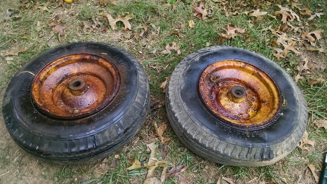

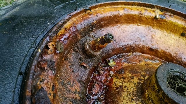

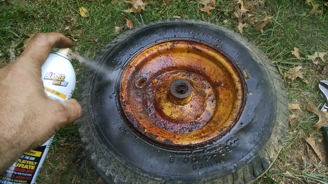

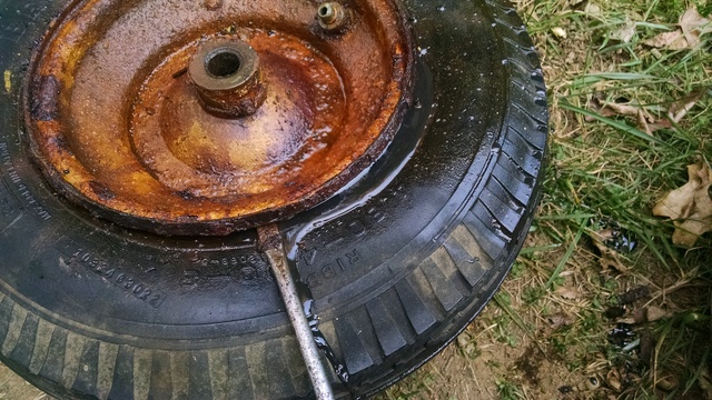

So after calming down by walking away from the project for about an hour, I figured I'll install the front wheels. After putting the first wheel on, I found that I apparently grabbed the wrong set of rims for this tractor, as the hubs on these rims aren't wide enough for the spindles. Frustrating Number 2!!! So after digging through the garage, I found another set of wheels that I'm pretty sure are the original wheels for this tractor. Only trouble is, they are full of calcium and don't appear to be in the best of shape. I couldn't break the valve stems loose, however after spraying PB Blaster around the beads, I was amazed to find out how well the beads broke. I eventually cut the valve stems off with my Dremel and cutting wheel as the stems were brass. I got the tires removed and found that the calcium was contained inside an inner tube so the insides of the rims aren't bad at all. In fact, the sides that you see in the pictures below, are the only bad areas of the rims. The backsides are in good shape and should clean up well.
After the tires were removed, I installed all of the grease zerks along with the zerk caps and spindle caps that I bought from Glenn.
  Great tip, thanks for sharing. Your work is outstanding, know your son will be proud.    :text-coolphotos:

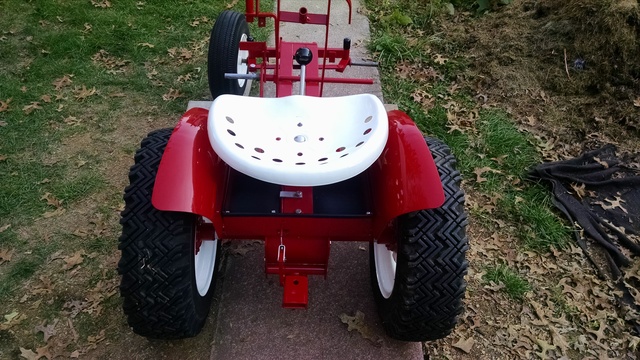

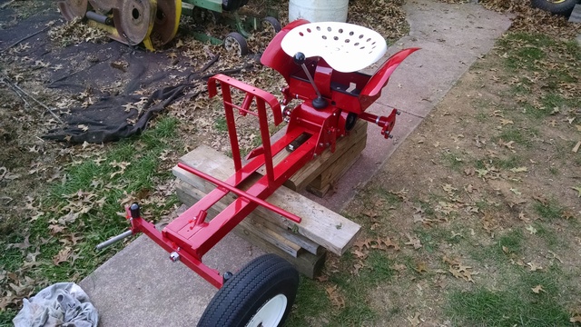

Not much progress today, as it was another disappointing day!
The good:
- I polished the belt guard and got that installed
- I got the rear lift cable, clamp, and hitch assembly installed.
- I got the brake rod and spring installed.
The bad:
- When I went to install the lift arm and brake/clutch pedal, I found that I needed to strip the paint from the cross member as there was no way to slide either of these pieces on.
- After finally getting the lift arm installed, I realized that I never painted the lever that latches in the clip while in the raised position.
- I painted the steering bushing and individual tie-rod bushing silver, however the fixed tie-rod bushing is painted red.
- When I went to install the brake/clutch pedal spring, I found that I never painted the metal plate tab that attaches to the transmission plate.
I finally called it a day and walked away from it. Tomorrow's another day!
