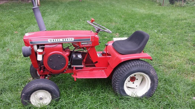

This is what I got who can help me identify tractor and motor
That is a Kohler engine with battery ignition. The large white canister is the ignition coil and the small canister on the same bracket is the condenser. Points are on the other side down low and under a small tin cover.
If you get down and look up to the flat panel in front of the shifter and below the dash housing there should be an ID plate with the model number and serial number on it.
Garry
It started with the battery being charged up??? If it started and ran then you need to see if the charging system is working.  Otherwise the battery will go dead again and she will stop running. Do you have a multimeter??? (Voltage meter??)
Looking at the non factory mounting of the ignition coil and condenser i will go out on a limb and propose this engine was a originally a breakerless type but when some part failed a previous owner converted it to battery coil points system (the Breakerless ignition parts hugely expensive).
On the engine shroud below the white coil look for a Kohler data plate Find the Specification (Spec) number
