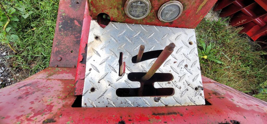

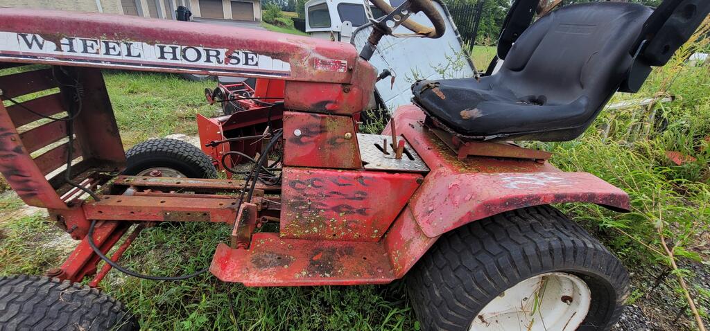

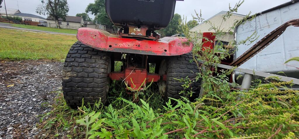

Larry schweers 17 #1 Posted September 11, 2022 (edited) Hello all I just acquired this wheel hose and need help identifying the model of tractor. It's missing the engine but would love to do a full strip restore. Also is there a good source for obtaining parts? Edited September 11, 2022 by Larry schweers Needed more detail 2 Share this post Link to post Share on other sites

The Freightliner Guy 1,364 #3 Posted September 11, 2022 Looks cool why’s is out in the rain also pics of the side? Share this post Link to post Share on other sites
Larry schweers 17 #4 Posted September 11, 2022 Just acquired it. Has been sitting in the rain for a while 1 Share this post Link to post Share on other sites
Ed Kennell 47,268 #5 Posted September 11, 2022 to the Larry. I'm guessing early '70s. Could be a C series or a no name. There should be an ID plate under the dash plate. The lights, steering wheel, and seat are not stock factory, so other parts may have been replaced. 1 Share this post Link to post Share on other sites

The Freightliner Guy 1,364 #7 Posted September 11, 2022 and is the other sides sticker more intact Share this post Link to post Share on other sites
Larry schweers 17 #8 Posted September 11, 2022 1 minute ago, The Freightliner Guy said: and is the other sides sticker more intact No pretty much the same 1 1 Share this post Link to post Share on other sites

The Freightliner Guy 1,364 #10 Posted September 11, 2022 Sorta looks like a c-161 Share this post Link to post Share on other sites

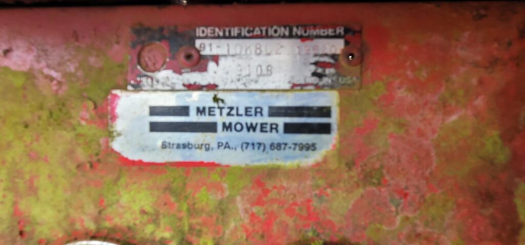

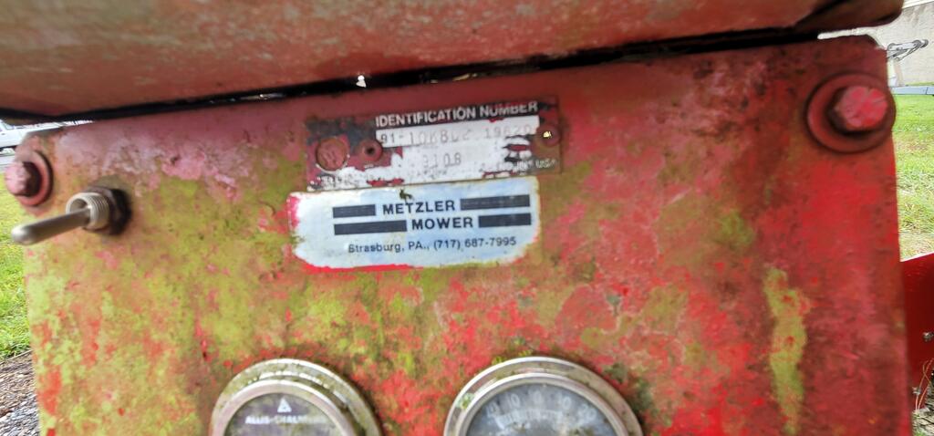

Larry schweers 17 #11 Posted September 11, 2022 Does this tag help any? 1 Share this post Link to post Share on other sites
squonk 48,078 #12 Posted September 11, 2022 (edited) 79 C-101 91-10K802 1979 C Series Garden Tractor C-101 8-Speed Kohler K241AS-46766D 10 Wheel Horse 103916 Edited September 11, 2022 by squonk 2 1 Share this post Link to post Share on other sites

Pullstart 71,215 #15 Posted September 11, 2022 Hopefully your transmission is free in all the gears, high and low. If it won’t easily shift into low, DON’T FORCE IT! The shift lever inside the transmission is not the most stout, and being outside tells me it’s gonna have water in the case. I have stripped down a few C-101’s for parts here and there. I’m sure you can find stuff closer to you, but if you need it I most likely have it. Share this post Link to post Share on other sites

Ed Kennell 47,268 #19 Posted September 11, 2022 6 minutes ago, Larry schweers said: Does this tag help any? Yep, that tells it all. Share this post Link to post Share on other sites
