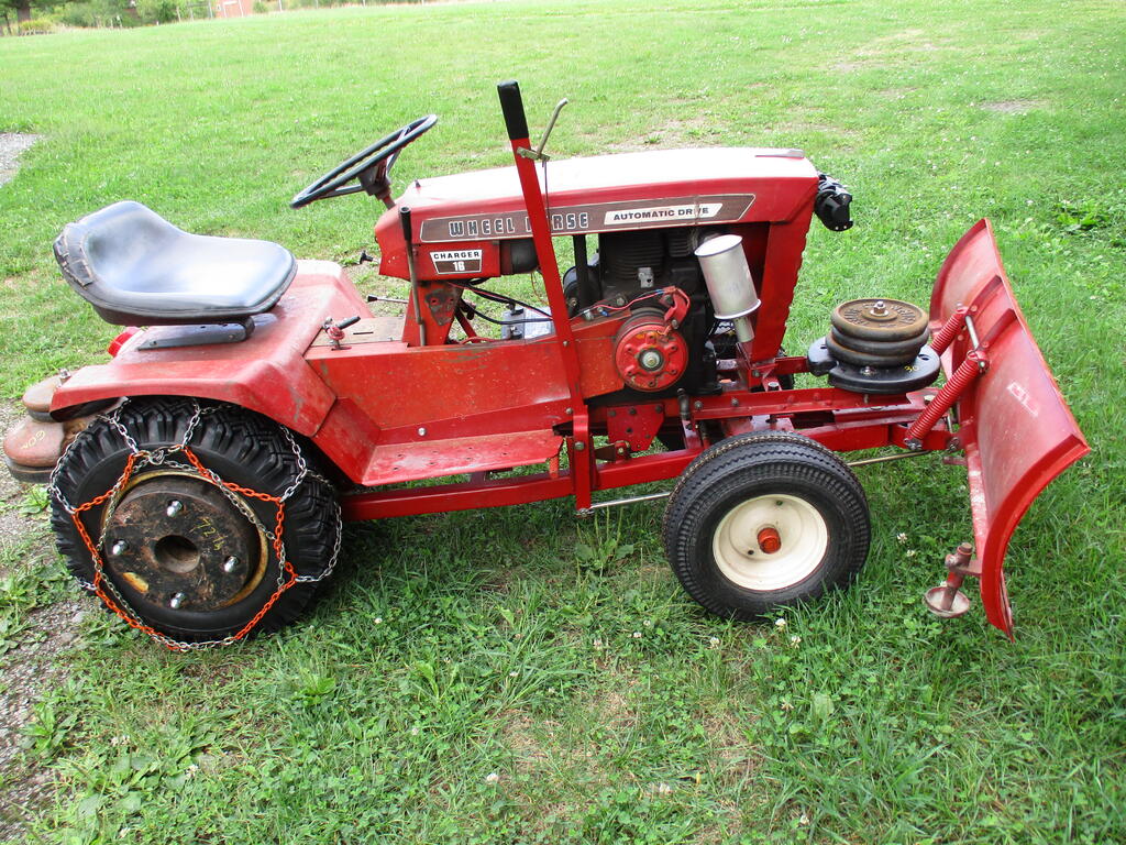

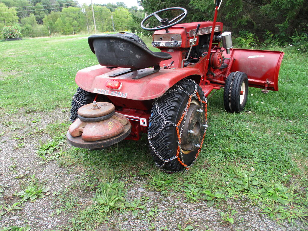

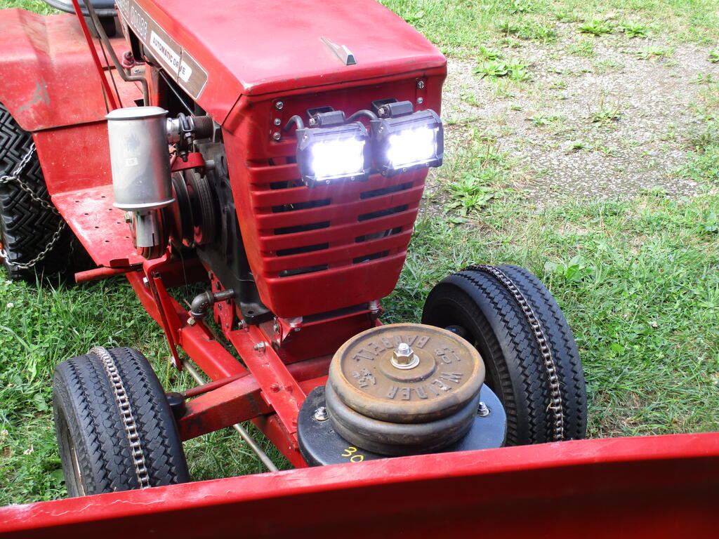

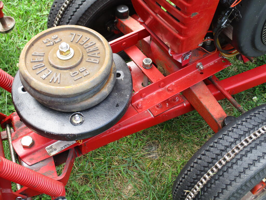

pfrederi 21,145 #1 Posted September 9, 2022 Each Horse in my herd has assigned duties. For several years my go to snow plow tractor was a Charger 12 with a 48" blade, chains and weights. She always did a good job. Last year I put on a 54" blade and some more weight. Not much snow last year but one snow was wet and heavy. The bigger blade really stressed her actually dragged down the engine pushing up hill. Usually with a plow traction is the first slippage but with weights and the LSD in a Charger that wasn't the weak point..we needed more power. So taking advantage the recent rainy days I did some swapping around and made a Charger 16 the new main snow plow tractor. Had to swap tires, weights, hood (for the headlights..odd since in 20 +years I have plowed in the dark twice...) and the plow frame ( as i have centering pin set up) . (next time i may just swap the engine The 70 lbs wheel weights are pita to mount.) She now has 16hp 54" blade and 320lbs of added weights..(took a scale out to weigh things.) . Hope she works out. The charger 12 will get the 42 ' blade with plastic edge and rubber chains to do a short stretch of pavers. Backup is an Charger 16 with the blower but she has seen very limited use the last few years... 2 10 Share this post Link to post Share on other sites

Pullstart 71,215 #5 Posted September 10, 2022 Got the weight department handled! Will your scale tell total tractor weight or is it a personal one? I started weighing my machines a while back, but the scales went to my FIL’s for race car use. 1 Share this post Link to post Share on other sites

Ed Kennell 47,268 #7 Posted September 10, 2022 Nice....I like those chains. Let's see... maybe another 3-4 years and you'll be old enough to qualify for a heated cab. 1 1 Share this post Link to post Share on other sites
