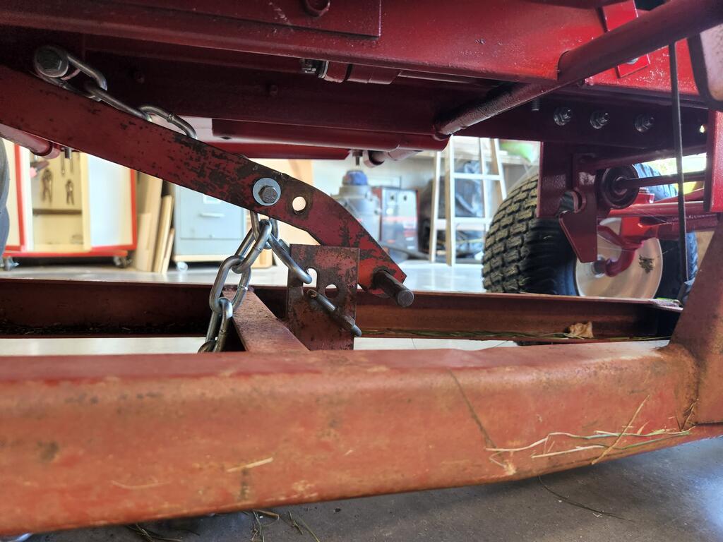

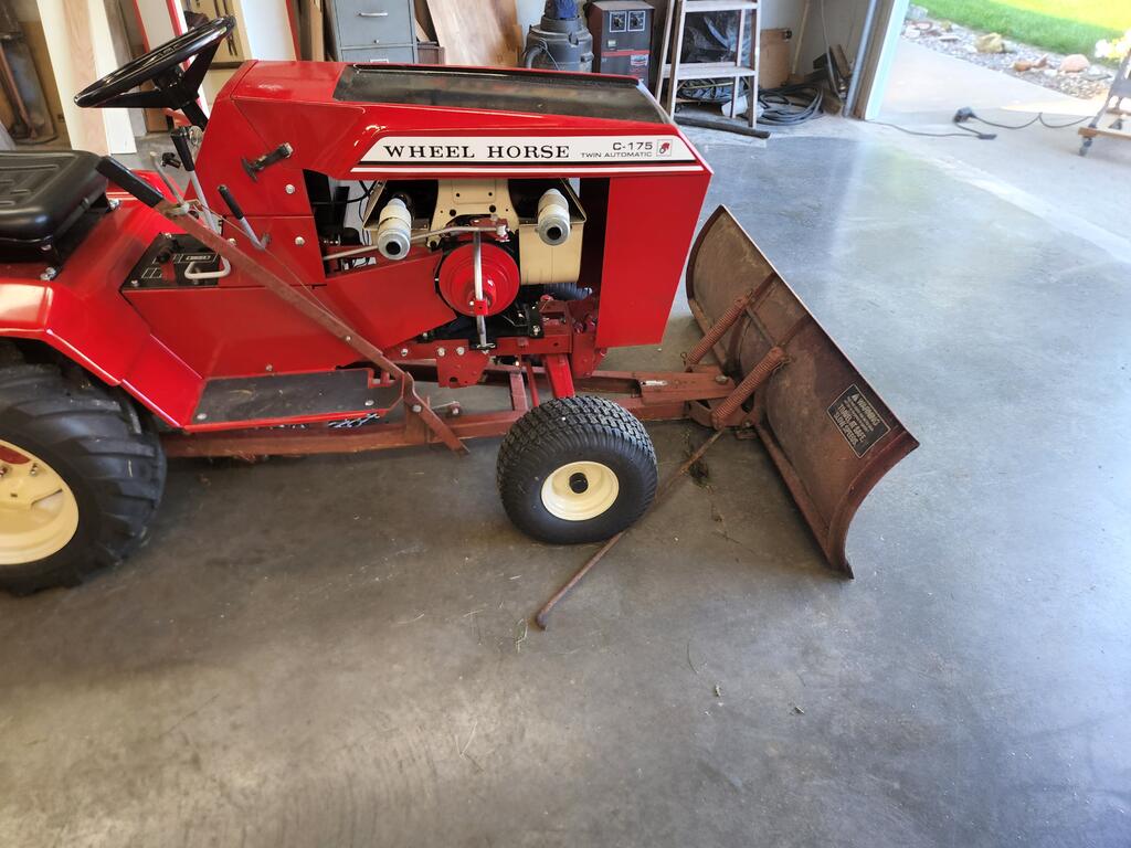

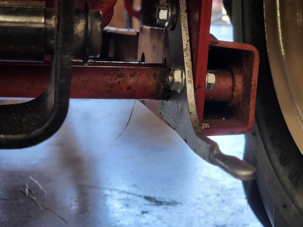

Gregor 4,848 #1 Posted September 9, 2022 I am attempting to install a front blade on my C-175 Automatic, without much success. I believe this blade actually came with my C-125 Automatic. I have never had a blade on a C series tractor. It is hydraulic lift, but the lever on the cylinder seem to move pretty much front to rear, with very little up or down motion. I have the bar with the chain hanging on the end of it, but when attached to the plow, it does not lift. How do you transfer that front/rear motion to up/down motion? Am I missing a piece? Could it be the wrong blade? There are no legible numbers on the plow. Thanks Greg Share this post Link to post Share on other sites

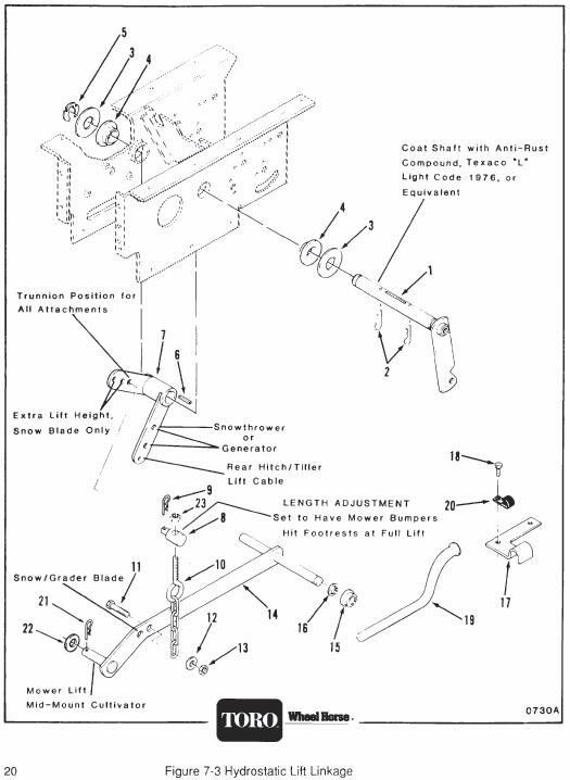

gwest_ca-(File Mod) 12,256 #2 Posted September 9, 2022 There is another arm that lifts up 1 Share this post Link to post Share on other sites
Pullstart 70,023 #3 Posted September 9, 2022 (edited) Or the mower lift arm needs to be removed and the lift link/chain direct to the lift quadrant Edited September 9, 2022 by Pullstart 1 Share this post Link to post Share on other sites

Gregor 4,848 #6 Posted September 9, 2022 OK I thought I got it, maybe I don't got it. When connecting the plow, is it necessary to use that bar that lifts and lowers the mower deck? Or just hook direct from the bell crank lever to the plow? Thanks Greg Share this post Link to post Share on other sites
gwest_ca-(File Mod) 12,256 #7 Posted September 9, 2022 You do not have to use that lower bar. With a solid link you do not use it and that will give you down pressure. 1 Share this post Link to post Share on other sites
oliver2-44 11,496 #8 Posted September 9, 2022 You can tie the mower bar up or down remove it. Share this post Link to post Share on other sites
