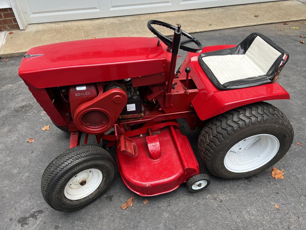

dkg520 531 #1 Posted September 7, 2022 So my brother shows up at our family reunion today and he has this 1966 Wheel Horse 856 in the back of his truck. He tells me he is looking for a good home for it and drops his tailgate and parks it in my driveway. It’s in really nice shape and fires right up and runs great. Can anyone tell me anything interesting about this model? 2 6 Share this post Link to post Share on other sites
Wild Bill in VA 1,596 #2 Posted September 7, 2022 Yes, somebody has taken a lot of time to keep it in good running shape and it even has the original "horse head" ignition key. This was a short framed Wheel Horse model with a good turning radius. If you're in Powhatan area the Wheel Horse was proably purchased at the dealer in Cartersville or maybe at Knabie in Powhatan. Outdoor Power Equipment up on Broad Street also sold Wheel Horse product in the era. Let me know what you want to do with the 856. Wild Bil in Richmond VA 1 Share this post Link to post Share on other sites
ri702bill 12,988 #3 Posted September 7, 2022 A nice looking, mostly original short frame 4 speed. A continuation of the previous 8 HP 854 and 855 with sheet metal changes. Only things missing , as I see, are the 2 plastic caps for the front spindles. Do check the tierods for excessive wear at the ends - they are known to come apart - usually at a very bad time .... Share this post Link to post Share on other sites
ebinmaine 80,651 #4 Posted September 7, 2022 41 minutes ago, dkg520 said: Can anyone tell me anything interesting about this model? Short frame 8 horse Kohler is the absolute favorite worker of the BBT here on our acreage. Piles of torque for the size. Fuel sipping. Great little working tractor. 1 Share this post Link to post Share on other sites
ri702bill 12,988 #5 Posted September 7, 2022 11 minutes ago, ebinmaine said: Short frame 8 horse Kohler is the absolute favorite worker of the BBT here on our acreage. Piles of torque for the size. Fuel sipping. Great little working tractor. And, with a little time and some later parts, replacing the 4 speed with either a 6 or 8 speed really makes it more versatile - did that with my 854 - no regrets. Share this post Link to post Share on other sites

Achto 32,639 #7 Posted September 7, 2022 Very sweet score!! I really like my 856, 857 and 867. Very handy little tractors. 2 Share this post Link to post Share on other sites
Retired Wrencher 6,979 #8 Posted September 7, 2022 dkg529. Nice tractor for its age. I have the younger brother in Commando 8. Great little tractors. Enjoy the ride. Plowes are everywhere just have to look in your spare time. Share this post Link to post Share on other sites
ebinmaine 80,651 #9 Posted September 7, 2022 28 minutes ago, ri702bill said: And, with a little time and some later parts, replacing the 4 speed with either a 6 or 8 speed really makes it more versatile - did that with my 854 - no regrets. Absolutely recommend doing a SIX speed for two reasons. 1. 6 speeds have limited slip differential. 2. Having tried to replace a 6-speed with an 8-speed, the linkage is different and if you want to use it for plowing it will not be using friendly because the back forth back forth back forth action will wear out the belt faster. 21 minutes ago, dkg520 said: short frame snow blade Does not need to be a short frame plow. You can use either short or long frame from most Wheel Horses. 1 Share this post Link to post Share on other sites

squonk 48,078 #11 Posted September 7, 2022 1 hour ago, ebinmaine said: Absolutely recommend doing a SIX speed for two reasons. 1. 6 speeds have limited slip differential. 2. Having tried to replace a 6-speed with an 8-speed, the linkage is different and if you want to use it for plowing it will not be using friendly because the back forth back forth back forth action will wear out the belt faster. Does not need to be a short frame plow. You can use either short or long frame from most Wheel Horses. The long frame plow needs to have the extra holes in it to use it on a short frame tractor. Not all do. If it doesn't the plow will bolt up but the angle lever will hit the foot stirrup you need 8 foot arms to run it! 1 Share this post Link to post Share on other sites
