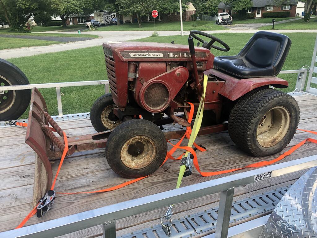

hcminis 1,796 #1 Posted September 6, 2022 Did a little Horse trading yesterday with a good friend. Was left in a covered fabric Harbor Freight awing type tent I guess you call it. Few items were robbed for the Cub Cadet the previous owner had. She is rough but hopefully get it going. Saved many in worse condition. The rear axle bracket is real creative. 3 6 1 Share this post Link to post Share on other sites
Ed Kennell 47,268 #2 Posted September 6, 2022 Nice save. I am surprised that blade has enough lift. That is a new one. Glad it didn't break the case. 6 Share this post Link to post Share on other sites
Pullstart 71,215 #3 Posted September 6, 2022 That extendo hitch pin literally made me cringe! 2 Share this post Link to post Share on other sites
ri702bill 12,988 #4 Posted September 6, 2022 (edited) 2 hours ago, hcminis said: The rear axle bracket is real creative. But a mite scary - OK to transport the plow, but I would advise against using it for any real work. A sudden stop hitting a solid object , tripping the blade, transfers all that force thru the overhung 3/4 inch diameter rod into the weak area of the Unidrive. A contest for sure to see if the rod bends first to a point where it is no longer removable or the Unidrive pops and spits it out ..... and it looks like you need to remove a rear wheel to slide the pin sideways to drop the plow - or both rear wheels it you need to thump on it - it just keeps on getting better, eh ?? Edited September 6, 2022 by ri702bill 2 1 Share this post Link to post Share on other sites

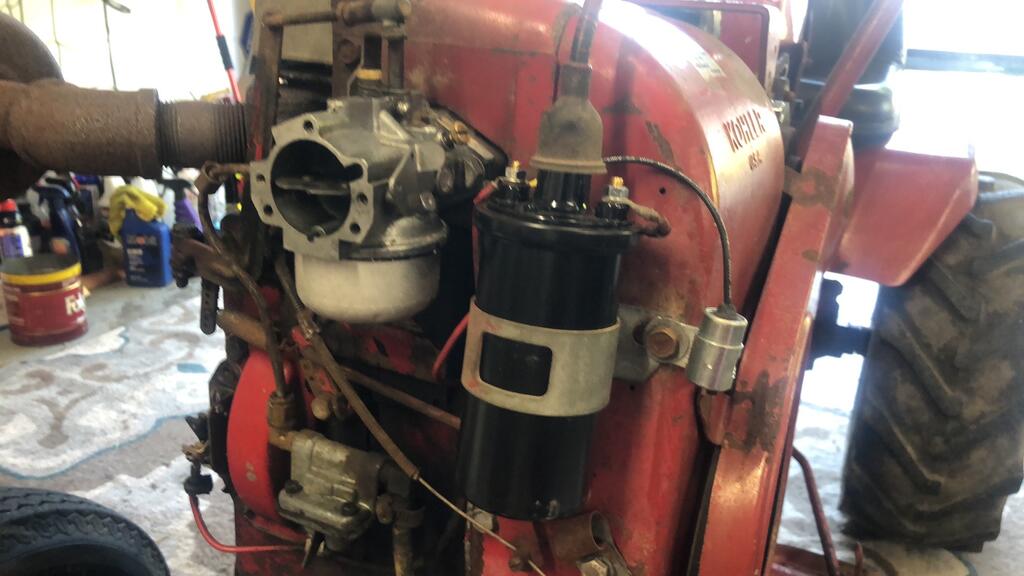

hcminis 1,796 #8 Posted September 9, 2022 Cleaned the carburetor and installed new coil and condenser. It fired on starting fluid. Need more minor items fixed and should be ready to run 2 1 Share this post Link to post Share on other sites

953 nut 69,163 #10 Posted September 9, 2022 On 9/6/2022 at 8:33 AM, ri702bill said: A contest for sure to see if the rod bends first to a point where it is no longer removable or the Unidrive pops and spits it out . I bought a parts tractor with a 3/4" rod like that, the rod was bent so badly that it was a struggle getting it out after being cut off flush . On 9/6/2022 at 7:24 AM, hcminis said: She is rough That is a trailer queen compared to some projects we see, nice save. 1 Share this post Link to post Share on other sites
ri702bill 12,988 #11 Posted September 9, 2022 1 hour ago, 953 nut said: I bought a parts tractor with a 3/4" rod like that, the rod was bent so badly that it was a struggle getting it out after being cut off flush No more calls, folks, we have a winner ...!!! 1 Share this post Link to post Share on other sites
