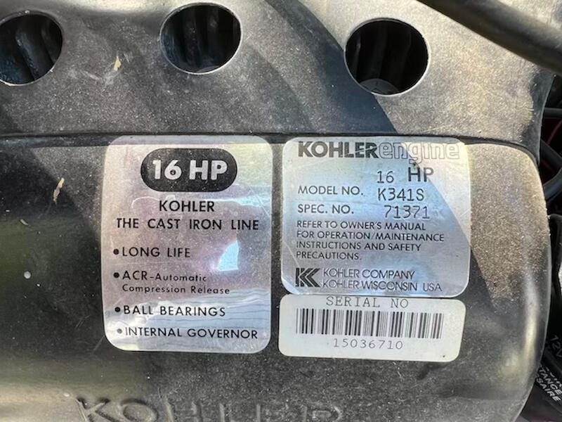

Jeff-C175 7,209 #26 Posted September 7, 2022 Is the label with the SPEC NUMBER still on that engine? Maybe you posted that already? I'll look... Share this post Link to post Share on other sites
Jeff-C175 7,209 #28 Posted September 7, 2022 Thanks... I'll look that up later... just got the chow call... unless you get to it first. Check the MANUALS section of the website. I think there's a document there under the Kohler Engines section that explains what's what with the spec numbers. It should tell you if that is the stator you actually want to use with that tractor. Share this post Link to post Share on other sites

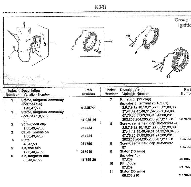

MilanWH 26 #29 Posted September 7, 2022 I read somewhere that it has a 3 amp and 15 amp stator. 3 for charging the battery, 15 to run the headlights. Maybe I could wire in a regulator to charge the battery with the 15 amp circuit, and run a batt.+ wire to the headlight switch? 1 Share this post Link to post Share on other sites
pfrederi 20,992 #30 Posted September 7, 2022 The spec number is for a Wheel Horse but the stator is not original should have a 15 amp stator Your engine is variant 9 for Ignition so you should have item# 7 1 1 Share this post Link to post Share on other sites
Jeff-C175 7,209 #31 Posted September 7, 2022 11 minutes ago, pfrederi said: 15 amp stator The list calls both 7 and 9 15 Amp? I thought the ones with fewer coils were lower output? 1 Share this post Link to post Share on other sites
Jeff-C175 7,209 #32 Posted September 7, 2022 (edited) @MilanWH I see it now! As Paul said, you have the wrong stator. The one you have does have two outputs! And I believe that being grounded is correct for that stator ONLY! You can't use that stator with the regulator I posted earlier. Models that used that stator did not use a regulator at all AFAIK. just a single diode. Edited September 8, 2022 by Jeff-C175 Share this post Link to post Share on other sites
MilanWH 26 #33 Posted September 7, 2022 Great, so the stator being grounded is correct. Is there a regulator that I can use with this stator? It would be great if I could get the battery charging with what I have instead of replacing this stator. Share this post Link to post Share on other sites
953 nut 68,154 #34 Posted September 7, 2022 1 hour ago, MilanWH said: Maybe I could wire in a regulator to charge the battery with the 15 amp circuit, I like the way you think, unfortunately it won't be much help. A rectifier passes the positive portion of the alternating current and rejects the negative parts of the sign wave. as a result you will only receive about 40% of the power that was available as AC power, perhaps six amps. Time for a 15 amp stator. 1 Share this post Link to post Share on other sites
pfrederi 20,992 #35 Posted September 8, 2022 for about $30 take a chance on an after market 15 amp stator or a used one... 1 Share this post Link to post Share on other sites
MilanWH 26 #36 Posted September 8, 2022 Wow, amazing. I just checked Amazon and there are a bunch of 15 amp stators with regulator available. Are these aftermkt kits reliable? Can you still get OEM stators from Kohler? Share this post Link to post Share on other sites
953 nut 68,154 #37 Posted September 8, 2022 If it has good feedback ratings I wouldn't be afraid to buy it. 2 Share this post Link to post Share on other sites
Snoopy11 5,731 #38 Posted September 8, 2022 15 hours ago, Jeff-C175 said: Models that used that stator did not use a regulator at all AFAIK. just a single diode Yeah... and if the stator is proven GOOD... there you CAN put a diode inline of the battery +lead coming from the stator and use it like it is. For a 30$ investment... while you have the flywheel off... it might be worthy to go ahead and throw a 15 amp stator with regulator on it... as others here have stated. I possibly plan to swap my K341's 3 amp stator to a 15 amp stator in the future so I can easily run LED lights... etc... Don Share this post Link to post Share on other sites
MilanWH 26 #39 Posted October 13, 2022 Well, I bought a stator/regulator combo on Amazon for $35. After an afternoon with a Dremel, to get it to fit the k341, it works great! It now charges fine, even if I turn on the lights. I'm loving this tractor! Now I need a good mower deck and the hard part, deciding what to do with my 416-8. The 520 is just more comfortable. May just have to keep both.... this forum makes me feel normal, my family thinks I'm crazy! 4 Share this post Link to post Share on other sites
