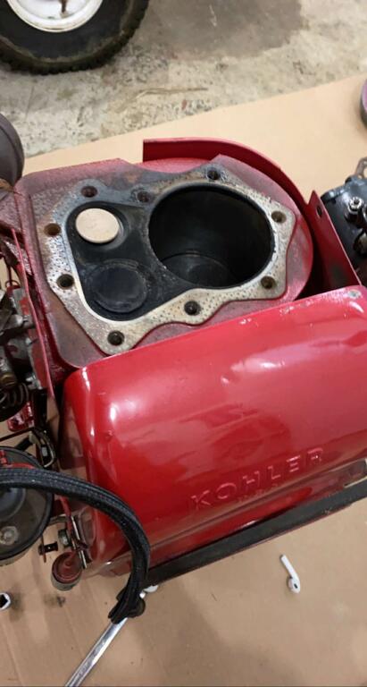

Thompson1276 257 #1 Posted September 4, 2022 (edited) Was cutting 8 70ft pine trees my cub LoBoy couldn’t go there because it was too rocky here on the Appalachians, but I hooked up a tow rope to my horse a 1276 K301-ST with the HydroGear duel pump hydro from 66 never been serviced internally had the original oil pan gasket and the tractor sat for 30+ years before I got it, I hooked it up and I have the gov raised to run at 4500 rpm pulled 3 trees on the 4th tree it made a grinding sounds it pulled it where it should be and drove it about 1/8 or 1/4 mile back home and still was running when I parked it oil everywhere not a drop inside the engine was hotter than 400 degrees just on the oil pan , the paints boils off at 380 that I put on and it was just starting to boil up off. Tore it down no scoring on the conrod or crank like new the piston has some but not any that’s bad at all can’t feel any the inside the cylinder is like new. Only needs needs gaskets and oil. And this here is proof and why old Kohler engines are bulletproof gotta love em I’ll have this complete soon but if you read the story part I’m impressed myself when I first saw it almost all new and is all OEM inside not a single part was replaced before Edited September 5, 2022 by Thompson1276 6 Share this post Link to post Share on other sites
Heatingman 977 #2 Posted September 5, 2022 What gave way to begin with? 1 Share this post Link to post Share on other sites
Thompson1276 257 #3 Posted September 5, 2022 3 minutes ago, Heatingman said: What gave way to begin with? The head gasket has a small small leak in it already because the fin was chipped one time not by me or previous owner but the 2nd owner since I’m the 4th one but it was actually the oil pan gasket it was hard as a rock when I tore it off 1 Share this post Link to post Share on other sites

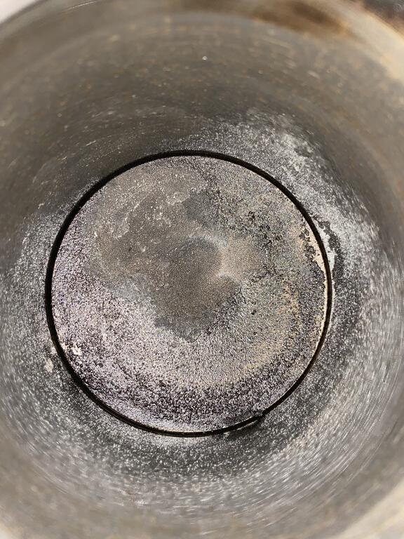

oliver2-44 11,694 #4 Posted September 5, 2022 You might want to check the cylinder bore while you have it apart. The attached thread is a great way to verify wear not seen by the naked eye. 4 Share this post Link to post Share on other sites
oliver2-44 11,694 #5 Posted September 5, 2022 You might want to check the aluminum head for flatness. Many of us hand surgace them using wet dry sandpaper on a piece of glass. Rotate the head in a figure 8 3 1 Share this post Link to post Share on other sites
Thompson1276 257 #6 Posted September 5, 2022 48 minutes ago, oliver2-44 said: You might want to check the aluminum head for flatness. Many of us hand surgace them using wet dry sandpaper on a piece of glass. Rotate the head in a figure 8 Checked it on a flat seems good never had problems with the head or cylinder Share this post Link to post Share on other sites
Thompson1276 257 #7 Posted September 5, 2022 1 hour ago, oliver2-44 said: You might want to check the cylinder bore while you have it apart. The attached thread is a great way to verify wear not seen by the naked eye. It’s good from what I saw I went over with a micro and seemed good enough to still run the stock .010 1 Share this post Link to post Share on other sites

clueless 3,437 #11 Posted September 5, 2022 I'm thinking the engine you show in the post is not the original engine. 1 1 1 Share this post Link to post Share on other sites

Thompson1276 257 #15 Posted September 8, 2022 On 9/5/2022 at 5:24 PM, clueless said: I'm thinking the engine you show in the post is not the original engine. It’s the original engine for the 1276 , it’s a K301-ST , 1276 is 12HP kohler , 7 for hydro , 6 for last digit of the year made 1966 same exact one in the manual listed too Share this post Link to post Share on other sites

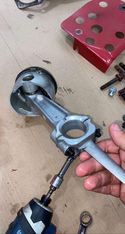

oliver2-44 11,694 #16 Posted September 8, 2022 On 9/4/2022 at 10:44 PM, Thompson1276 said: It’s good from what I saw I went over with a micro and seemed good enough to still run the stock .010 The 0.010 piston is usually not an original factory bore size. There is a good chance someone has bored and rebuilt that engine earlier in its life. Of course the important thing is that it runs good and has lots of life left in it. On 9/4/2022 at 6:57 PM, Thompson1276 said: a 1276 K301-ST with the HydroGear duel pump hydro from 66 You mention a “dual pump Hydrogear”. Are you possible referring to the Hydro pump and Hydro motor. 2 Share this post Link to post Share on other sites
Thompson1276 257 #17 Posted September 8, 2022 12 hours ago, oliver2-44 said: The 0.010 piston is usually not an original factory bore size. There is a good chance someone has bored and rebuilt that engine earlier in its life. Of course the important thing is that it runs good and has lots of life left in it. You mention a “dual pump Hydrogear”. Are you possible referring to the Hydro pump and Hydro motor. No it has 2 hydro pumps it has a LSD Hydro has 2 pumps next to each other , say I’m wroooong but I rebuilt this tractor from the frame down and up a few times and tore lots of stuff on it apart without needing a manual to tell me what to do. As for the piston and crank and such the crank is original so is the cam and the valves , the piston and conrod has been placed reasons idk why the conrod and pistons are both Forged so to my guess someone tried to restore it before me but failed which I do know is true there was bondo in places I had to pound out and stuff Share this post Link to post Share on other sites
Snoopy11 5,731 #18 Posted September 9, 2022 25 minutes ago, Thompson1276 said: the conrod and pistons are both Forged I could be reading this wrong... are you saying that the connecting rod in THIS picture is forged? Don Share this post Link to post Share on other sites

Snoopy11 5,731 #22 Posted September 9, 2022 14 hours ago, Thompson1276 said: I have the K Series engine We know that you have the K-series engine. What we don't know is if you affirm that: 16 hours ago, Thompson1276 said: conrod and pistons are both Forged Very important to know...? Don Share this post Link to post Share on other sites
