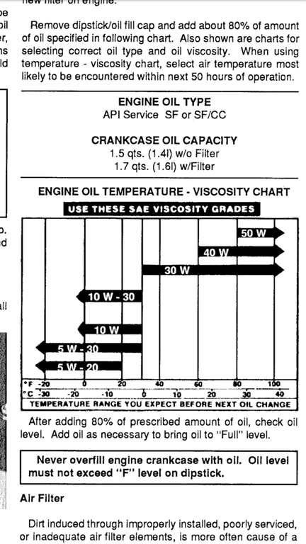

23 Reo
Is 40 W good for summer months? I acquired my first Onan this year.

lynnmor
The 1997 Owners Manual shows 10-30 & 10-40 up to 80 degrees.  Download that manual for the later information, the engine didn’t change but Onan changed their specifications to reflect the newer grades of oil.
