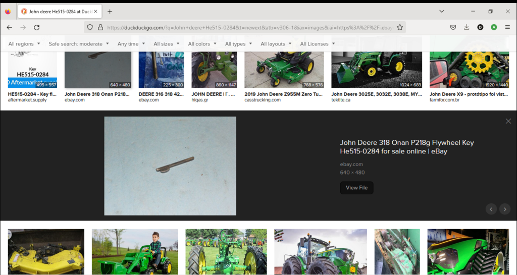

Snoopy11 5,731 #17 Posted October 28, 2022 17 hours ago, petermil12833 said: Have made substantial progress (and repairs) on this engine since last post. The only remaining item needed before I put the 520H back in service is a flywheel key - Onan # 515-0284. They're backordered everywhere. If anyone has a spare, please let me know. THANKS! Be honest which'ya... this isn't the first time that I have seen that type of key. This is where it helps to have knowledge of various equipment, including GREEN!!! I think you are going to have to get away from Onan and Cummins manufacturing to get that part. Check into John Deere part HE515-0284... there are places online that have the part you need. I could personally order the part from my local Wright Implement since I have various green equipment and have a parts order account with them... but it would cost you the same as buying the part online. https://www.greenpartstore.com/John-Deere-Key-HE515-0284.html Personally, I'd take the jungle option... https://www.amazon.com/John-Deere-Original-Equipment-HE515-0284/dp/B00NPC3N22 Don Share this post Link to post Share on other sites

petermil12833 16 #19 Posted October 28, 2022 Thanks, Don! I was aware of the JD equivalent, but I wanted to look around before spending $30 for this tiny part. But if I must . . . . 1 Share this post Link to post Share on other sites
Snoopy11 5,731 #20 Posted October 28, 2022 9 minutes ago, petermil12833 said: But if I must . . . . da' beagle thinks you must.... $30 bucks is a lot to spend on that part... butuh... there aren't any other legitimate options that I know of fa' 'dat... Don Share this post Link to post Share on other sites
