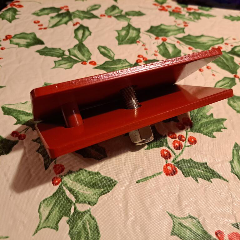

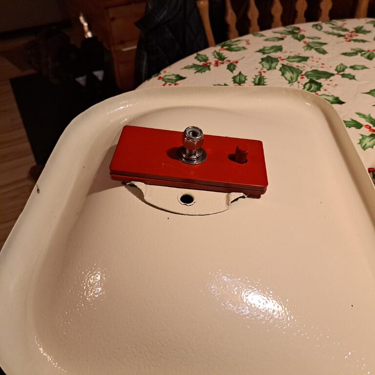

WHX?? 58,388 #51 Posted January 8, 2023 (edited) Found some what of a pic ...laying on the seat spring 702 build. There's a pin that locks the two pieces together. The pin also goes into the other spring hole to prevent pivoting. Just remembered I have a set earmarked for the 701 build. BTW @Achto last set i have things get a little slow at work... Edited January 9, 2023 by WHX?? 3 4 1 Share this post Link to post Share on other sites
Handy Don 17,740 #52 Posted January 9, 2023 13 hours ago, WHX?? said: Found some what of a pic ...laying on the seat spring 702 build. There's a pin that locks the two pieces together. The pin also goes into the other spring hole to prevent pivoting. Excellent and clever, sir! Thank you for sharing this. Time to rummage in the scrap pile for some plate! 3 Share this post Link to post Share on other sites
WHX?? 58,388 #53 Posted January 9, 2023 (edited) No problem Don... plus if your a long legged chap you can even go a tad higher. Just a longer pin and carriage bolt. Problem is many times that plate on the bottom of the seat is rotted away or been repaired multiple times. Getting hard to find a correct round or square that is decent shape. Edited January 9, 2023 by WHX?? 2 Share this post Link to post Share on other sites
Handy Don 17,740 #54 Posted January 9, 2023 3 minutes ago, WHX?? said: No problem Don... plus if your a long legged chap you can even go a tad higher. Just a longer pin and carriage bolt. I'm looking to raise it about 1” or a tad more. I may use your plates idea and sandwich some sort of spacer between. Having that pin catch the other hole in the seat was inspired. 2 Share this post Link to post Share on other sites
WHX?? 58,388 #55 Posted January 9, 2023 Other thought too is to fashion the plates in a cross pattern to support the pan side to side. 1 inch is quite abit may get side to side rock. 2 Share this post Link to post Share on other sites
