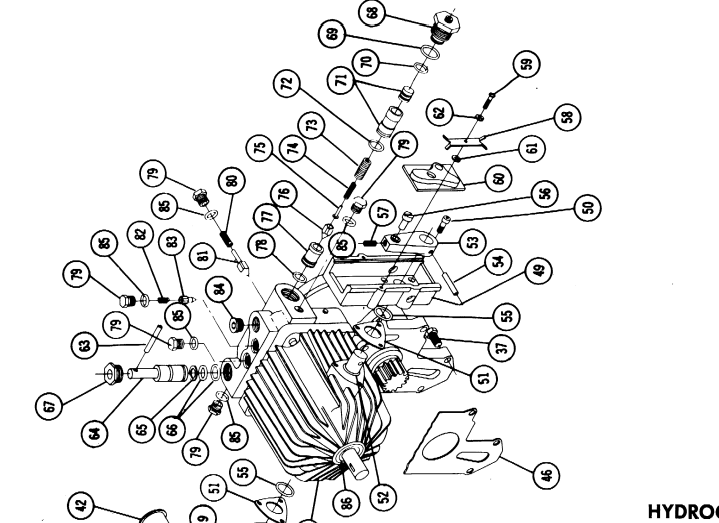

Maxwell-8 4,371 #1 Posted August 30, 2022 (edited) A local WheelHorse owner I know needs some help on his C161 ( 91-16BS02-18159 ) It's a sundstrand hydro and he can not control the speed of his tractor, it slows down, then it raises speed. There is a plastic (eton) plate (60) that is connected to a pin he says. He says there is a lot of play in that connection . He wonders if he is missing something that leads to that play. If claims that plastic plate (60) is pretty much new. I have a picture with the plate (60) but without the handle Any Help is much appreciated. Edited August 30, 2022 by Maxwell-8 Share this post Link to post Share on other sites
squonk 48,207 #2 Posted August 30, 2022 worn pin #56 Broken frame where the trans bolts on or broken tab on lest side of tractor where the hydro linkage passes thru the tunnel 1 Share this post Link to post Share on other sites

squonk 48,207 #5 Posted August 30, 2022 Possible broken acceleration spring too 1 Share this post Link to post Share on other sites
gwest_ca-(File Mod) 12,505 #6 Posted August 30, 2022 Here is an original parts list for this model 1 Share this post Link to post Share on other sites
