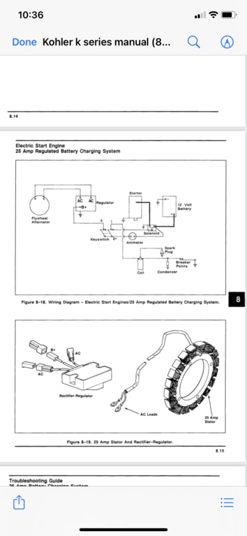

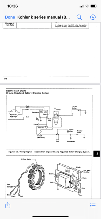

Heatingman 977 #1 Posted August 30, 2022 Thumbing through the K series engine manual, I noticed that on the general schematics, they dont show a light wired in on the 25 amp alternator coil, but they do on the 30 amp. Does that indicate the 25 amp wont support head lights? Share this post Link to post Share on other sites

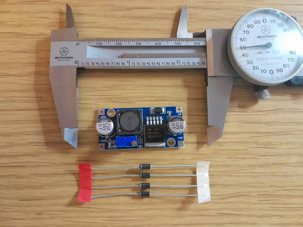

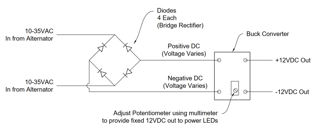

subvet720 179 #3 Posted August 30, 2022 (edited) I made a few post on the regulated 12VDC power supply I made using 4 diodes and a buck converter. With LED headlights ( https://www.amazon.com/dp/B075QZHXC6?psc=1&ref=ppx_yo2ov_dt_b_product_details ) and the 12VDC power supply, my K241 runs lots of LED lights because the current draw in minimal. Edited August 30, 2022 by subvet720 Add Photo 2 Share this post Link to post Share on other sites

Heatingman 977 #7 Posted August 31, 2022 16 hours ago, subvet720 said: I made a few post on the regulated 12VDC power supply I made using 4 diodes and a buck converter. With LED headlights ( https://www.amazon.com/dp/B075QZHXC6?psc=1&ref=ppx_yo2ov_dt_b_product_details ) and the 12VDC power supply, my K241 runs lots of LED lights because the current draw in minimal. Whats the necessity of a second rectifier/regulator? Or is this in place of the OEM? Share this post Link to post Share on other sites

subvet720 179 #9 Posted August 31, 2022 (edited) 9 hours ago, Heatingman said: Whats the necessity of a second rectifier/regulator? Or is this in place of the OEM? This is in addition to the OEM rectifier/regulator. This allows you to set up multiple DC voltages (3V, 5V, 12v) for LED components that may be sensitive to unstable voltage spikes. Additionally, it's cool because you made it for ~$4 Edited August 31, 2022 by subvet720 2 Share this post Link to post Share on other sites
