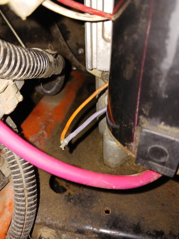

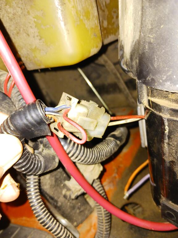

1973Auto 84 #1 Posted August 29, 2022 (edited) Hi. I found 2 detached wires from my Kohler courage 18hp SV540. I believe the orange wire is attached to the rectifier. I can not see where the purple wire is attached without removing the starter. I am thinking this may be the reason my battery is not charging. I can not tell which wires coincide with the correct wires on the opposite side of the wire jack. The wires on the opposite side of the jack are Red orange black blue white. The side where the orange and purple wires detached are red and white. I tried to push the wires back in the holes but they do not stay so I will pigtail them to the opposite side. So after all this what dies the orange and purple wires marry up to on the other side of the jack? I hope the pics are clear. Thanks Edited August 29, 2022 by 1973Auto Wrong pics Share this post Link to post Share on other sites

1973Auto 84 #3 Posted August 29, 2022 (edited) It is from a Husqvarna, my junk mowing tractor. The engine is about 7 years old. I will download the pics from a different computer. New phone, Edited August 29, 2022 by 1973Auto Share this post Link to post Share on other sites
1973Auto 84 #4 Posted August 30, 2022 Hope this helps Share this post Link to post Share on other sites
gwest_ca-(File Mod) 12,455 #5 Posted August 30, 2022 I noticed the wiring diagrams in the manual above show some color to some of them but it is faint. Share this post Link to post Share on other sites
1973Auto 84 #6 Posted August 30, 2022 12 minutes ago, gwest_ca said: I noticed the wiring diagrams in the manual above show some color to some of them but it is faint. I noticed it also. I was hoping that some had this engine and they could take a pice of this wire jack Share this post Link to post Share on other sites
