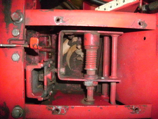

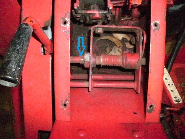

Here a pic I forgot to ad.
Torino
How hard should it be to move the friction adjustment?  I can barely move it.  Is this the part that could be rusted?
