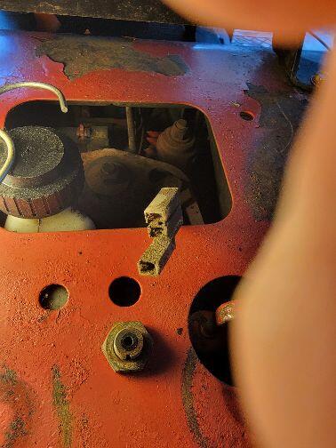

TheMooseIsLoose 14 #20 Posted September 11, 2022 Yes, that is the switch, but i don't think that's the problem. It's been disconnected for a while & never had trouble with it., The motor dies when PTO is engaged but I can start tractor and not be in the seat. It worked fine until I took seat pan off to install new fuel line, remove mower deck to grease & change belt & sharpen blades Share this post Link to post Share on other sites
ineedanother 1,808 #21 Posted September 11, 2022 1 hour ago, TheMooseIsLoose said: Yes, that is the switch, but i don't think that's the problem. It's been disconnected for a while & never had trouble with it., The motor dies when PTO is engaged but I can start tractor and not be in the seat. It worked fine until I took seat pan off to install new fuel line, remove mower deck to grease & change belt & sharpen blades Unplugging that switch is like getting off the seat so it shouldn't have been that simple. Why was is unplugged? Have you tested the switch or tried just plugging it back in? Do you have a multi-meter? You should have continuity between the two spades on the switch when it is depressed. Share this post Link to post Share on other sites
TheMooseIsLoose 14 #22 Posted September 11, 2022 (edited) 1 hour ago, ineedanother said: Unplugging that switch is like getting off the seat so it shouldn't have been that simple. Why was is unplugged? Have you tested the switch or tried just plugging it back in? Do you have a multi-meter? You should have continuity between the two spades on the switch when it is depressed. Yes, i unplugged it years ago. The picture I added above shows the mating connector in the seat pan which is a push button type which will contact the seat when depressed but the push button is broken. So if I can start it with it unplugged why wont the PTO work. Its been working right along. Sorry about the confusion. Edited September 11, 2022 by TheMooseIsLoose Share this post Link to post Share on other sites
ineedanother 1,808 #23 Posted September 11, 2022 Yep, a bit confusing because without that safety switch, you shouldn't be able to engage the PTO unless the wiring had been modified (by jumping the connector or wiring) which it sounds like you didn't do. A short piece of wire with male spate connectors on each end would work to test it. Those two wires need to be in contact as if you're sitting on the seat or depressing the push button on a working switch. Share this post Link to post Share on other sites
TheMooseIsLoose 14 #24 Posted September 16, 2022 All fixed, I replaced the seat switch. 2 Share this post Link to post Share on other sites
