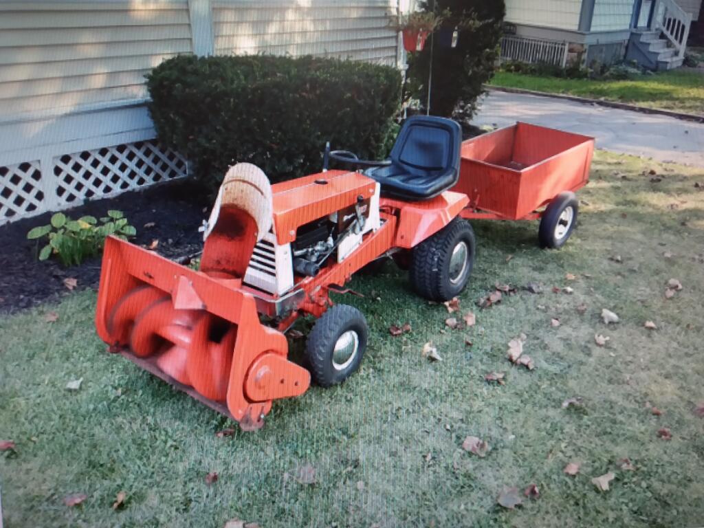

D_Mac 9,333 #5 Posted August 31, 2022 I picked up a Simplicity Broadmore couple years ago for free. I have told the story as of how hard I had to work to get that SOB in my truck. Rear end locked up, no help, had to drag by hand 75 yards in the pouring rain then get it up my ramps onto my truck while the previous owner just watched me. After I did all he could say was" I can't believe you got that in there". I was supposed to give him 30 bucks for it but after he watched me struggle and not give up he gave it to me. Day later it was running and driving. Gave it some love and passed it on. 4 1 Share this post Link to post Share on other sites

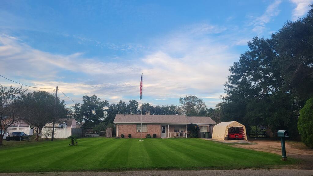

RED-Z06 2,718 #7 Posted September 20, 2022 Getting there. Engine purrs, lift works, power steering smooth, gauges work including fuel level, all lights work, engine fully serviced, all missing air filter parts were replaced, just rebuilt the deck (6 new bearings, 2 new V idlers, 1 flat idler, 2 belts, changed oil in gearbox, freed up the pto shaft). Gave it a quick cut and buff... New seat will be in tomorrow 4 Share this post Link to post Share on other sites
