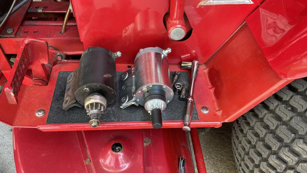

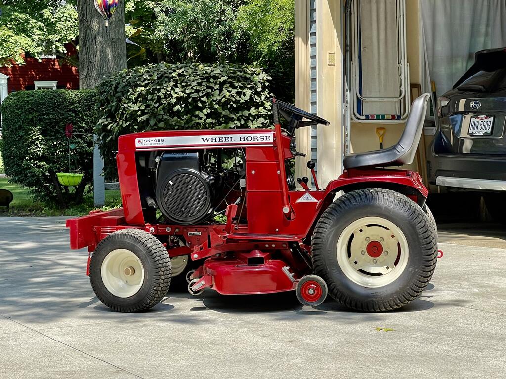

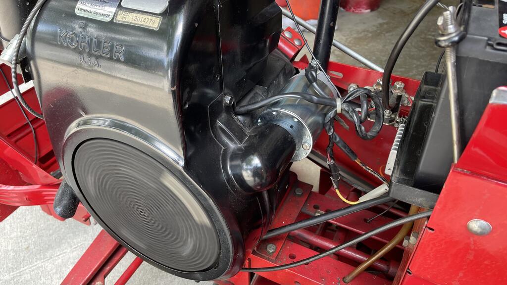

Al C. 1,480 #1 Posted August 26, 2022 (edited) I’ve been nursing a weak starter on my Wheel Horse SK-486 16hp K341 Koehler engine for the past four years. I finally broke down and replaced it this week. Bought an after market replacement off Amazon. It’s a 15 minute swap. Wow!!! What a difference! The starter is smooth, powerful, and fast. Engine starts on first turn! Should have done this years ago … $47.00. See pics. Edited August 26, 2022 by Al C. 2 2 Share this post Link to post Share on other sites
peter lena 10,107 #2 Posted August 26, 2022 @Al C. nice looking unit there ! clean / maintained , did you use any graphite on that drive gear area ? good price on that too , pete Share this post Link to post Share on other sites
Al C. 1,480 #3 Posted August 26, 2022 I had the same question. I read a number of posts and talked to a local mechanic. They said to leave it dry. 1 Share this post Link to post Share on other sites
pacer 3,181 #4 Posted August 26, 2022 I'd go dry too..... I got one of those 'aftermarket' starters for my small Mitsubishi couple yrs ago, it is also really nice and preforms great, was also $50-60? The bendix failed on it and there was so little difference in the bendix cost and the complete starter, soooo ....... Share this post Link to post Share on other sites
gwest_ca-(File Mod) 12,533 #5 Posted August 26, 2022 The biggest cause of a weak or slow starter is worn bushings the armature turns in. 2 Share this post Link to post Share on other sites
ri702bill 13,316 #6 Posted August 26, 2022 Don't toss your original - it can be rebuilt for short $$ IF the magnets are not damaged.... 1 Share this post Link to post Share on other sites
pacer 3,181 #7 Posted August 26, 2022 7 minutes ago, ri702bill said: be rebuilt for short $$ IF the magnets are not damaged.. This is very true, and I have been into several with nothing but a good leaning brought them back, replaced one bushing, and one set of brushes. ..... but I cant see any way to repair the bendix??? anybody??? Share this post Link to post Share on other sites
Al C. 1,480 #8 Posted August 26, 2022 I tried to “fix” the Bendix. Removed the head nut. Got a new spring at ACE Hardware - cut it to size. Hammered the gear mechanism to increase friction. It made it better, but nothing like the new starter. Share this post Link to post Share on other sites
