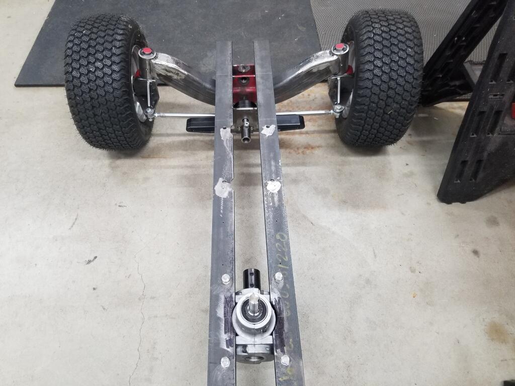

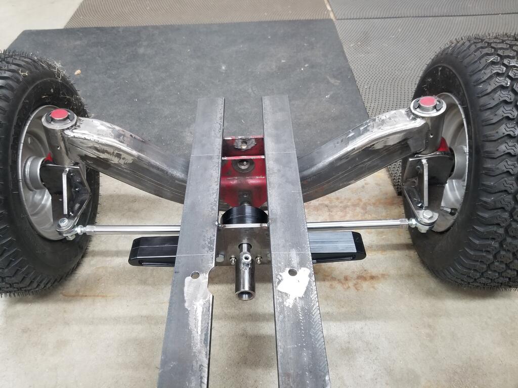

Wild Bill 633 943 #27 Posted December 12, 2022 (edited) Assembled the altered 520H 1" spindles, rack & pinion and tie rods. Need to do a little fine tuning and then add spindle turn stops to front axle. Edited December 12, 2022 by Wild Bill 633 2 8 Share this post Link to post Share on other sites

stevebo-(Moderator) 8,744 #30 Posted December 13, 2022 Bill, I won’t be asking you to race me on the senior this year! 1 5 Share this post Link to post Share on other sites
Wild Bill 633 943 #31 Posted December 13, 2022 36 minutes ago, stevebo said: Bill, I won’t be asking you to race me on the senior this year! Initial design will not go real fast due to cast iron pulley maximum ft/min. To go faster safely, the pulleys would have to be machined from steel. 3 1 Share this post Link to post Share on other sites

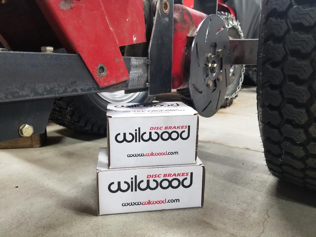

Wild Bill 633 943 #36 Posted December 22, 2022 Sneak peek of the brakes. 1 8 Share this post Link to post Share on other sites
ebinmaine 81,204 #37 Posted December 22, 2022 13 minutes ago, Wild Bill 633 said: Sneak peek of the brakes. Will the setup you are using still work if an axle breaks or the belt breaks? Share this post Link to post Share on other sites
Handy Don 17,702 #38 Posted December 22, 2022 17 minutes ago, ebinmaine said: Will the setup you are using still work if an axle breaks or the belt breaks? It looks like a disk instead of a drum but on the same shaft, right? So same effects as a drum but with stronger stopping power. 32 minutes ago, Wild Bill 633 said: Sneak peek of the brakes This is a very cool idea! 1 Share this post Link to post Share on other sites
Snoopy11 5,731 #39 Posted December 22, 2022 Hey Bill, Very nice work so far. My only thought as I look at your workmanship so far... is the clearance between the frame and the axle. I don't see a lot of clearance in this picture... I'm just thinking that maybe it would be beneficial to lock the front axle up so it doesn't have any play. It would probably make it stiffer as well... Just an observation... I have utmost respect for what you are putting together here, and I won't take up more of your thread. Don Share this post Link to post Share on other sites
Oldskool 6,678 #40 Posted December 22, 2022 What do you figure top speed will be? 2 Share this post Link to post Share on other sites
Wild Bill 633 943 #41 Posted December 22, 2022 1 hour ago, Snoopy11 said: is the clearance between the frame and the axle. I don't see a lot of clearance in this picture The OEM WH 633 tractor has 8 degrees of axle rotation each direction from level for a total 16 degrees. The flanges on the frame rails between the axle mounting plates will be machined up to allow for the same axle rotation. 2 Share this post Link to post Share on other sites
