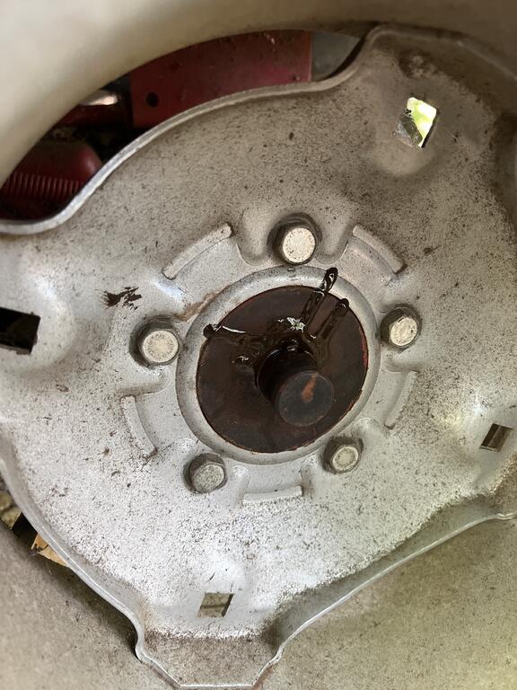

Zachary Kosinski 1 #1 Posted August 25, 2022 This wheel horse has sat for a while and recently pulled it out of its hole. It has the 8 speed transmission but recently started leaking out where the axle meets the rim (shown in pic). Obviously something is wrong so my question is what needs to be replaced? Share this post Link to post Share on other sites

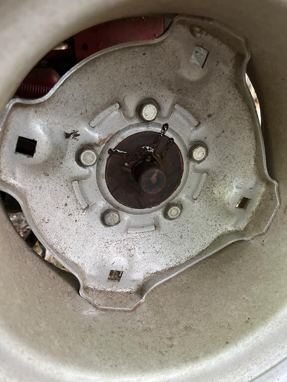

Zachary Kosinski 1 #2 Posted August 25, 2022 (edited) This wheel horse has sat for a while and recently pulled it out of its hole. It has the 8 speed transmission but recently started leaking out where the axle meets the rim (shown in pic). Obviously something is wrong so my question is what needs to be replaced? My guess is the hub went bad. My reasoning for that is the other one seems to be newly replaced by previous owner. Edited August 25, 2022 by Zachary Kosinski Left something out Share this post Link to post Share on other sites
squonk 45,590 #3 Posted August 25, 2022 You have an axle seal leaking. May be due to old age, sitting or worse bad axle bearing causing the axle to squash the seal. 2 Share this post Link to post Share on other sites
SylvanLakeWH 30,629 #4 Posted August 25, 2022 Probably just a seal, but I’d drive it a bit, clean it up, then see what it does… my guess is you’ll be putting a new seal on it… 2 Share this post Link to post Share on other sites
rjg854 12,859 #5 Posted August 25, 2022 (edited) As wet as that looks, you shouldn't have a problem getting the hub off Once it's off check the keyways for wear. Edited August 25, 2022 by rjg854 Add 2 Share this post Link to post Share on other sites
Zachary Kosinski 1 #6 Posted August 25, 2022 19 minutes ago, squonk said: You have an axle seal leaking. May be due to old age, sitting or worse bad axle bearing causing the axle to squash the seal. I did a little looking. You seem to be right! Do you know where I find can find one or if you know the part number? Thanks a lot 1 Share this post Link to post Share on other sites
rmaynard 16,885 #7 Posted August 25, 2022 Is that a 1" or 1-1/8" axle? Share this post Link to post Share on other sites
Zachary Kosinski 1 #8 Posted August 25, 2022 1 minute ago, rmaynard said: Is that a 1" or 1-1/8" axle? 1” Share this post Link to post Share on other sites
rmaynard 16,885 #9 Posted August 25, 2022 1" seal is Toro 100863 or local auto parts store SKF9815 1 Share this post Link to post Share on other sites
rmaynard 16,885 #10 Posted August 25, 2022 (edited) See the complete cross reference chart at the beginning of this section of the forum Edited August 25, 2022 by rmaynard Share this post Link to post Share on other sites
stevasaurus 23,619 #11 Posted August 25, 2022 Your hub may also be loose. The outside should be flush with the end of the axle. 2 Share this post Link to post Share on other sites
Cee245 852 #12 Posted August 25, 2022 Welcome @Zachary Kosinski Zachary!... looks like it needs a seal at least. The hub shouldn't be so far in on the axle so take a good look for wear in that area. Good luck Share this post Link to post Share on other sites
953 nut 64,270 #13 Posted August 25, 2022 My guess would be the hub has been rubbing against the seal and has torn it. The set screws should be torqued to 35 ft/lb. When you jack up the rear wheel see if the axle bearing is causing the seal to fail. If the axle moves in and out a quarter inch or so that is fine. If the axle moves up/down or front/back then the axle bearing is bad and would need replacement. 2 Share this post Link to post Share on other sites
Zachary Kosinski 1 #14 Posted August 25, 2022 2 hours ago, stevasaurus said: Your hub may also be loose. The outside should be flush with the end of the axle. Turns out the keyway is worn so the only way to keep it tight is to have the axle sticking out Share this post Link to post Share on other sites
lynnmor 8,644 #15 Posted August 25, 2022 Don’t keep running it, a loose hub or bad bearing will cause additional damage. Jack it up, remove the wheel and hub to inspect. Share this post Link to post Share on other sites
stevasaurus 23,619 #16 Posted August 26, 2022 You can fix the axle and hub so it doesn't slide and sits where it should be. Share this post Link to post Share on other sites
