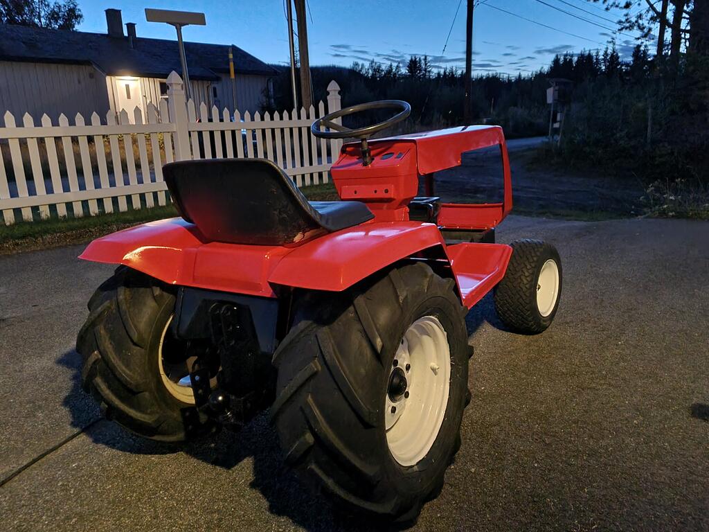

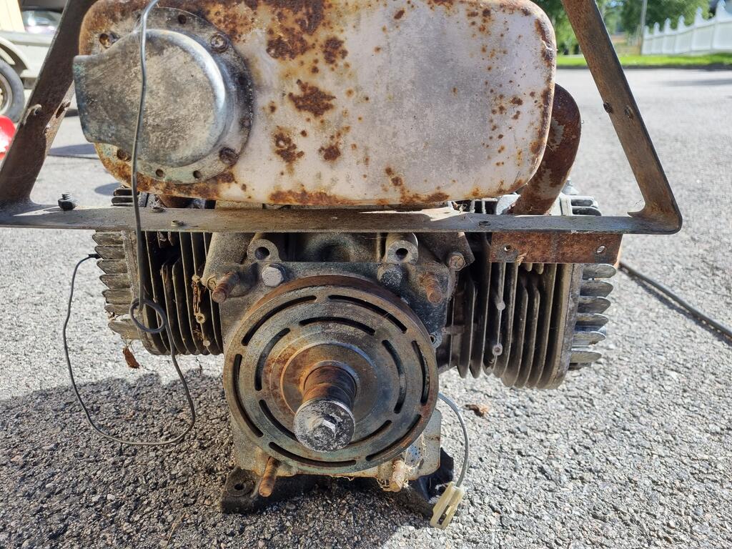

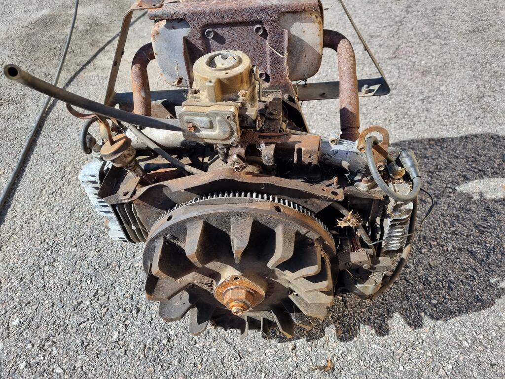

Tommy Andersen 3 #1 Posted August 24, 2022 Hello all I live in Norway and have now bought my first Wheelhorse, its a restauration prodject i have just started with. Found this tractor in an add on fb sold in the neighborhood, and wanted to save this tractor, i have used days (and nights) searching the web for pothos to try to identify the type with no luck... Hope you can help me. The main issue right now is to find the correct startermotor for the Kohler engine (startermotor was missing when I bought it). The engine in mounted with shavt pointing aft connected to hydrostat with axle. Hope someone can help me with this. Attached pict. 2 Share this post Link to post Share on other sites
Wild Bill in VA 1,596 #2 Posted August 24, 2022 (edited) I'm going to take guess, but it looks like a late 1970's MTD with the heavy-duty Peerless transaxle. Wild Bill in Richmond VA Edited August 24, 2022 by Wild Bill in VA 1 1 Share this post Link to post Share on other sites

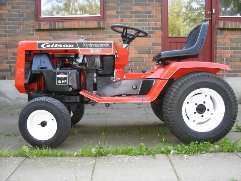

Achto 32,053 #3 Posted August 24, 2022 (edited) My guess is that it is a Gilson. Not sure on the model. Edited August 24, 2022 by Achto 4 1 Share this post Link to post Share on other sites
Achto 32,053 #4 Posted August 24, 2022 (edited) 2 hours ago, Tommy Andersen said: Engine is a Briggs & Stratton, model number in this range. (253400 thru 422700 and 460700, 461700-461799) Identified by the fuel pump with the 3 screw cover. If you have the tins, the exact model number should be stamped into them. Edited August 24, 2022 by Achto 5 Share this post Link to post Share on other sites

Tommy Andersen 3 #6 Posted August 26, 2022 Thank you so very mutch all of you! This was a greate help for me and i have now found starter motor (I was shure it was a Kohler engine, but B&S parts was the correct one) It a little bit sad it is not a WheelHorse, but I think this Gibson is a cool tractor also😎 Thanks again 1 Share this post Link to post Share on other sites
