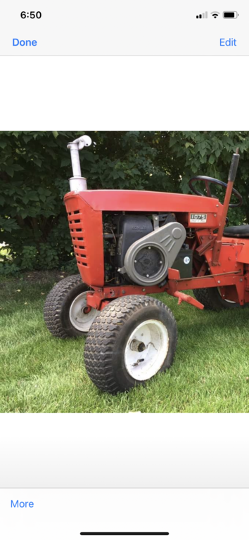

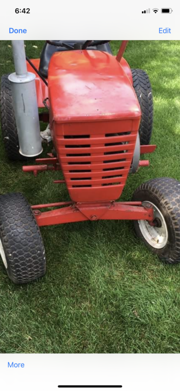

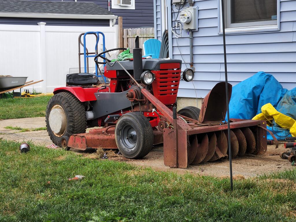

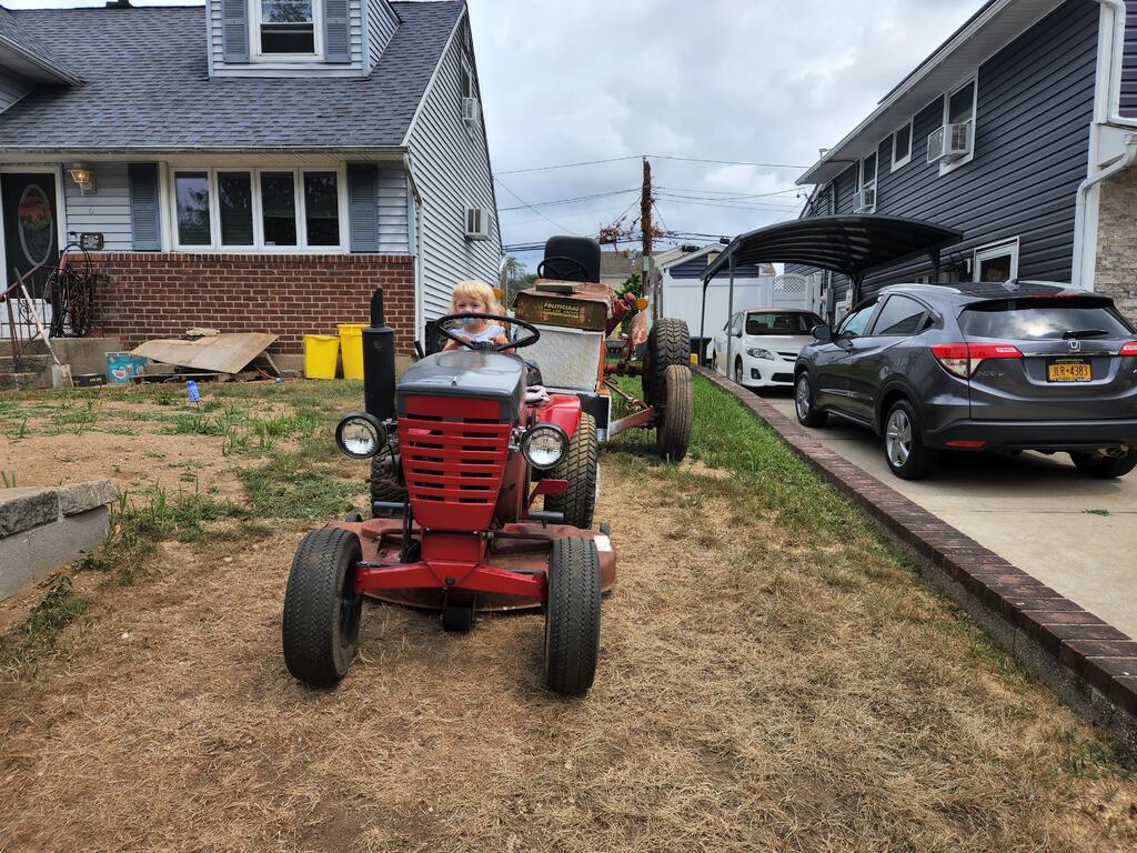

Heatingman 977 #1 Posted August 23, 2022 Im looking at possibility buying this machine to double my wheel horse collection. I have a B80, the deck for it and a plow for it also. hoping the attachments would be interchangeable between the 2 machines. Ideally one machine would be for plowing, the other for mowing. At least thats the idea in my mind. But after looking at the pictures, looks like the front hitch is either missing, or a totally different style on this tractor. Can almost make out a mid hitch on the photos, but almost looks like an empty bolt hole where the front hitch may have attached. Share this post Link to post Share on other sites
Pullstart 71,215 #2 Posted August 24, 2022 There were some models around then that only had a mid mount tach-a-matic and mid mule drives too.. nothing mounted off the front. Snow blowers were mounted through the frame. Share this post Link to post Share on other sites

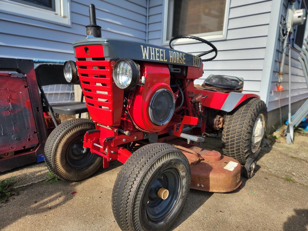

Monstrosity 1,153 #3 Posted August 24, 2022 My 1277 didn't have one. I found NOS on ebay for a decent price. Works good too bolts to the side of the frame in existing holes you do need to cut hood mount a little bit tho 2 Share this post Link to post Share on other sites

squonk 48,078 #6 Posted August 24, 2022 (edited) The short frame 1075 has a different distance from the front axle to mid hitch. The add on front tach a matic adapter will not bolt on without mods. The adapter will hit the mid hitch instead of bolting in in front of it. Edited August 24, 2022 by squonk 1 Share this post Link to post Share on other sites
squonk 48,078 #7 Posted August 24, 2022 13 hours ago, Heatingman said: Im looking at possibility buying this machine to double my wheel horse collection. I have a B80, the deck for it and a plow for it also. hoping the attachments would be interchangeable between the 2 machines. Ideally one machine would be for plowing, the other for mowing. At least thats the idea in my mind. But after looking at the pictures, looks like the front hitch is either missing, or a totally different style on this tractor. Can almost make out a mid hitch on the photos, but almost looks like an empty bolt hole where the front hitch may have attached. Decks do not interchange. A long frame snow plow (B80) can be used on short frame (1075) if the plow has the extra holes in the rear bar mounting. 1 Share this post Link to post Share on other sites

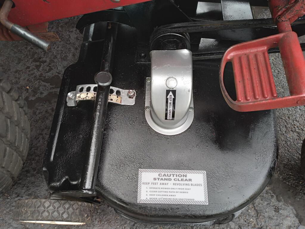

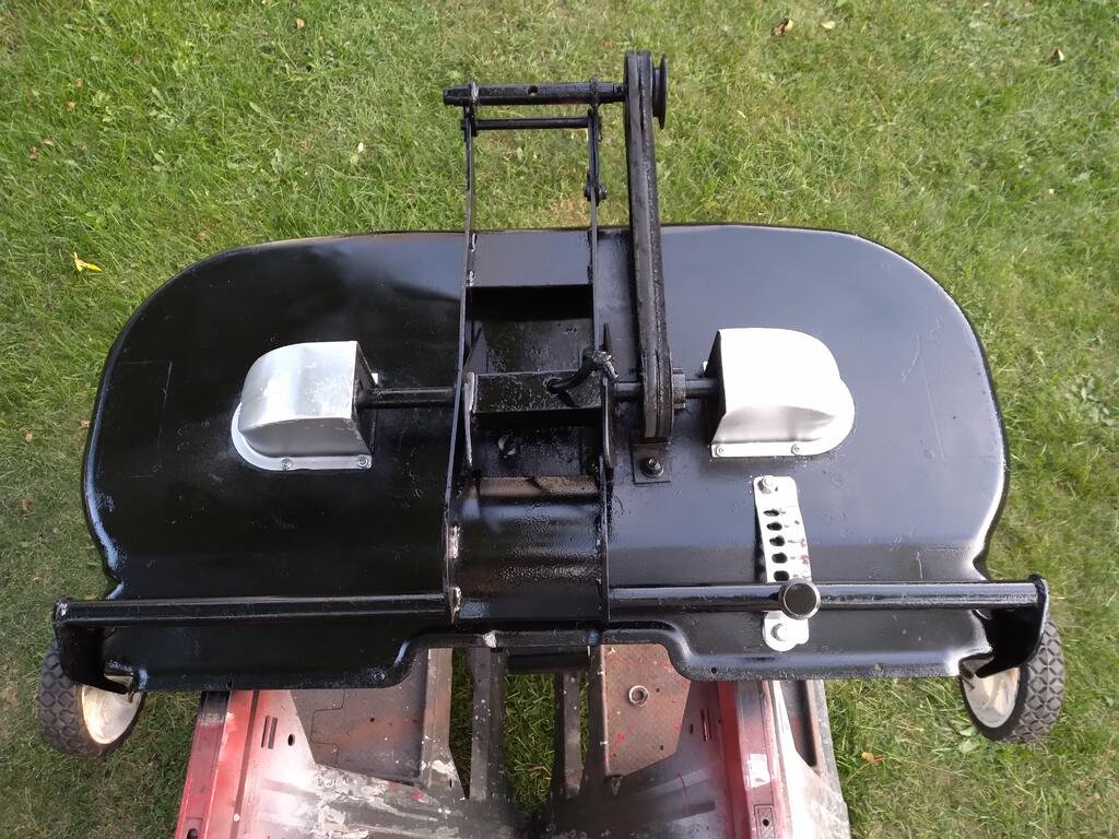

D_Mac 9,339 #8 Posted August 24, 2022 (edited) For that tractor the money isn't in the decks or plows. Sure it would be great to have them but they are available pretty cheap. Finding a proper one I think would be easier then modifying something to fit. Here is what deck you need. I would use the 1075 to plow though and the b80 to mow. There should be a small pulley about under that stack muffler. Mounts under there as well. No mule drive on the front. Edited August 24, 2022 by D_Mac 1 Share this post Link to post Share on other sites
