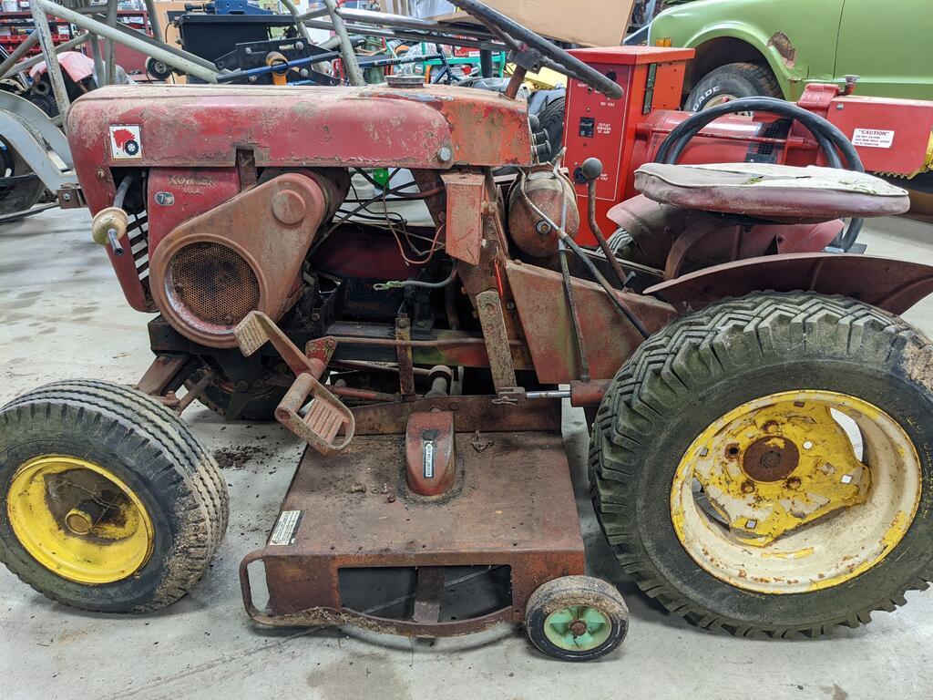

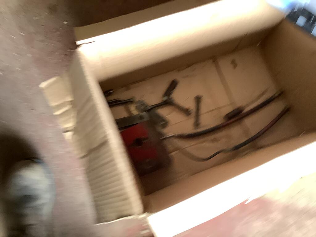

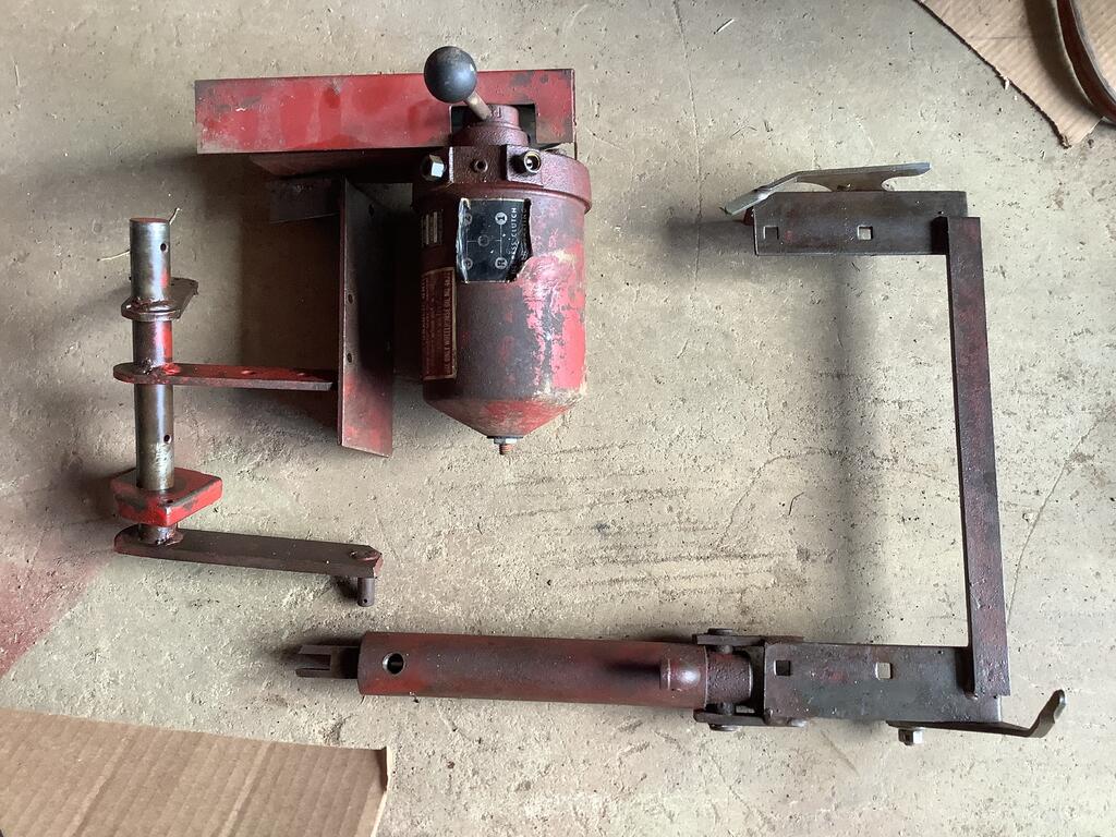

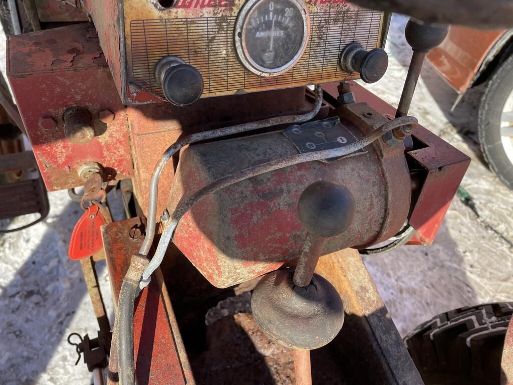

Pullstart 68,534 #1 Posted August 23, 2022 I picked this HY-2 kit up on trade last weekend. I’m just in the state of research. The pump control lever is stuck and will need taking apart. I believe short of the modified shifter, it’s complete which is awesome! 4 2 Share this post Link to post Share on other sites

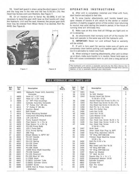

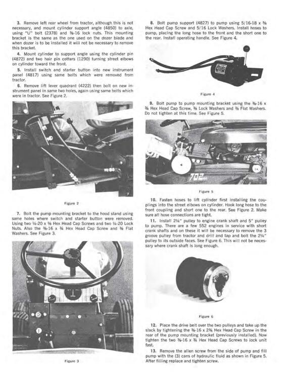

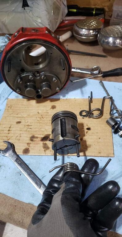

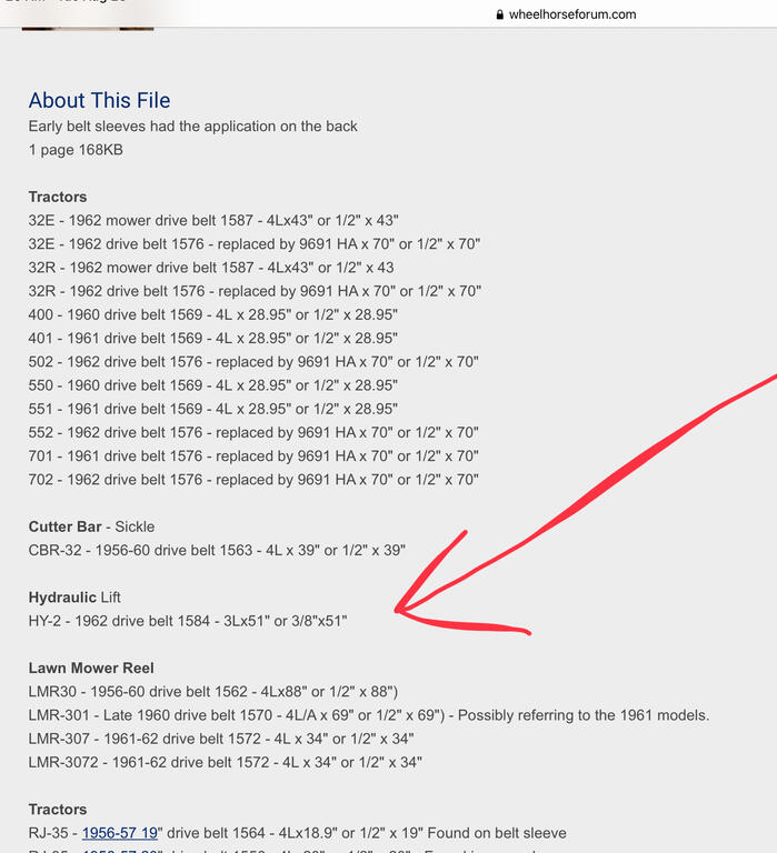

Pullstart 68,534 #2 Posted August 23, 2022 Browsing through manuals and pictures from Lane and Jim, I’ve compiled a little collection. 1 2 Share this post Link to post Share on other sites

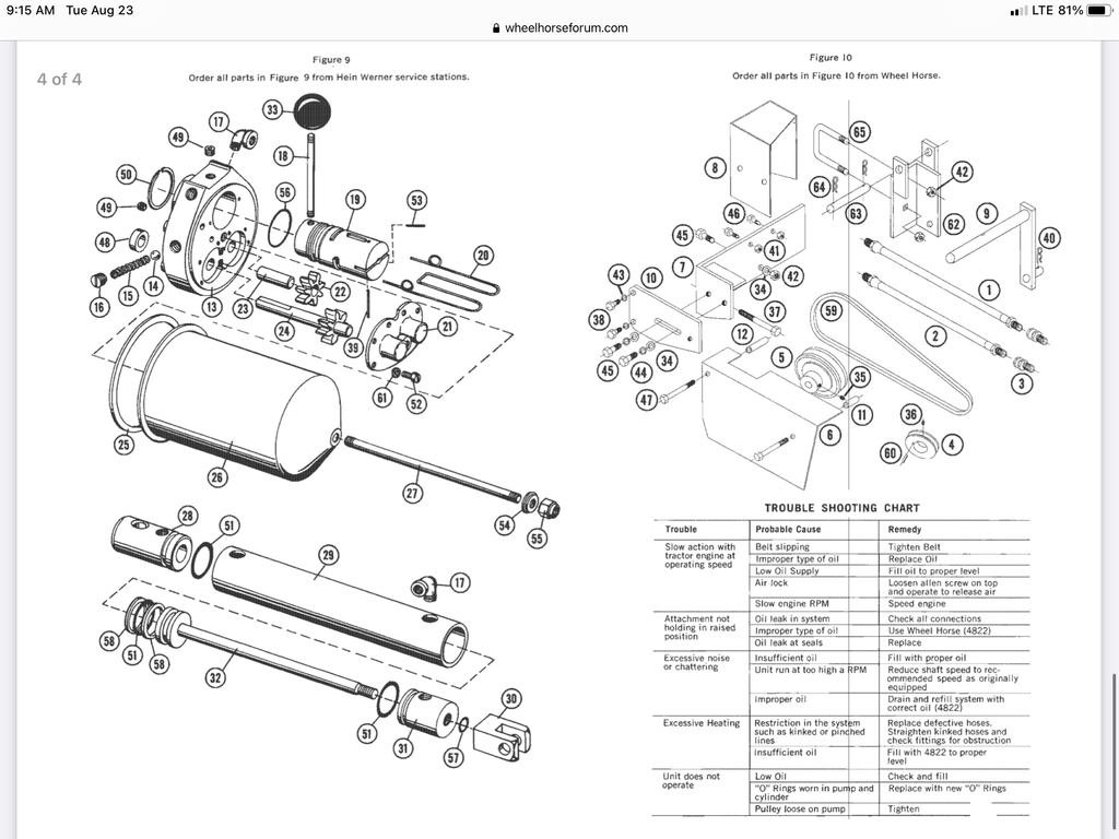

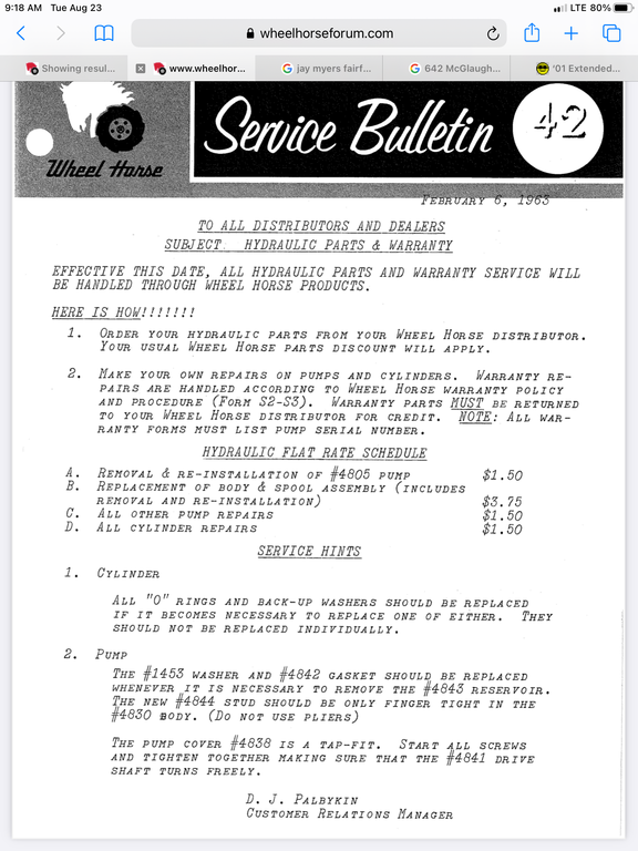

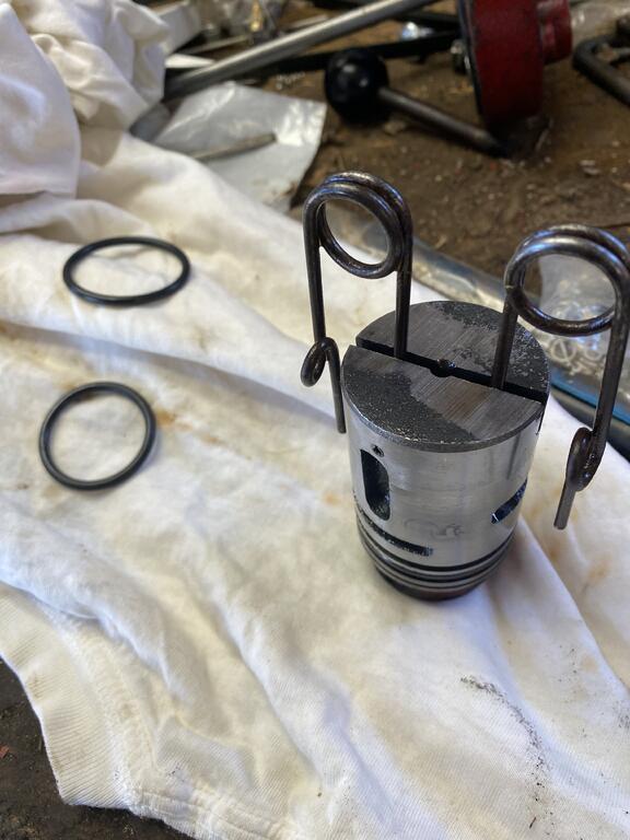

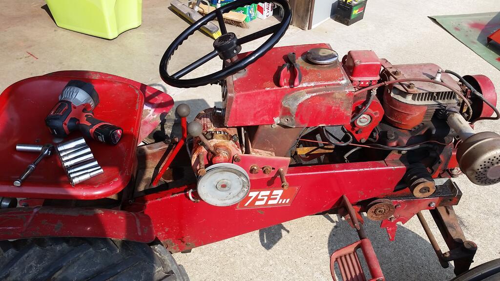

Pullstart 68,534 #3 Posted August 23, 2022 I stole some stuff from Phil’s 753 post too! 5 Share this post Link to post Share on other sites

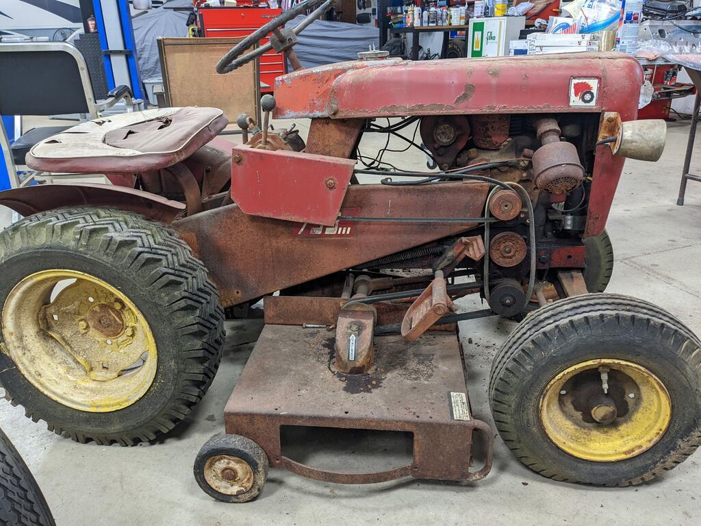

The Freightliner Guy 1,363 #5 Posted August 23, 2022 I’ve never seen a mower deck so boxy Share this post Link to post Share on other sites
ri702bill 10,618 #6 Posted August 23, 2022 38 minutes ago, The Freightliner Guy said: I’ve never seen a mower deck so boxy The ols style "suitcase" deck (missing at least one side plate). Bill Share this post Link to post Share on other sites

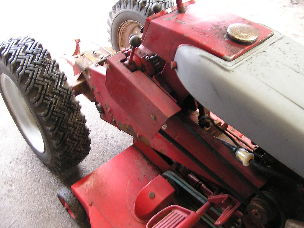

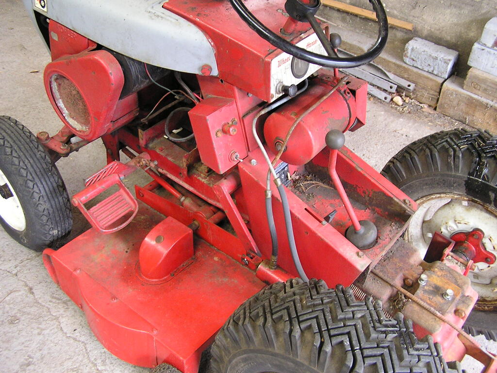

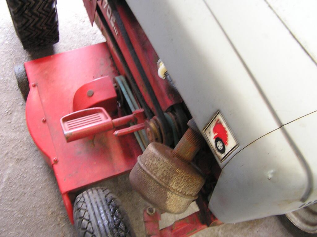

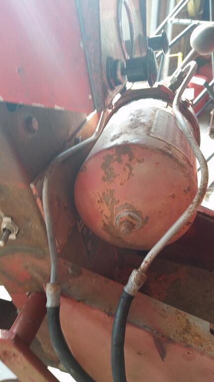

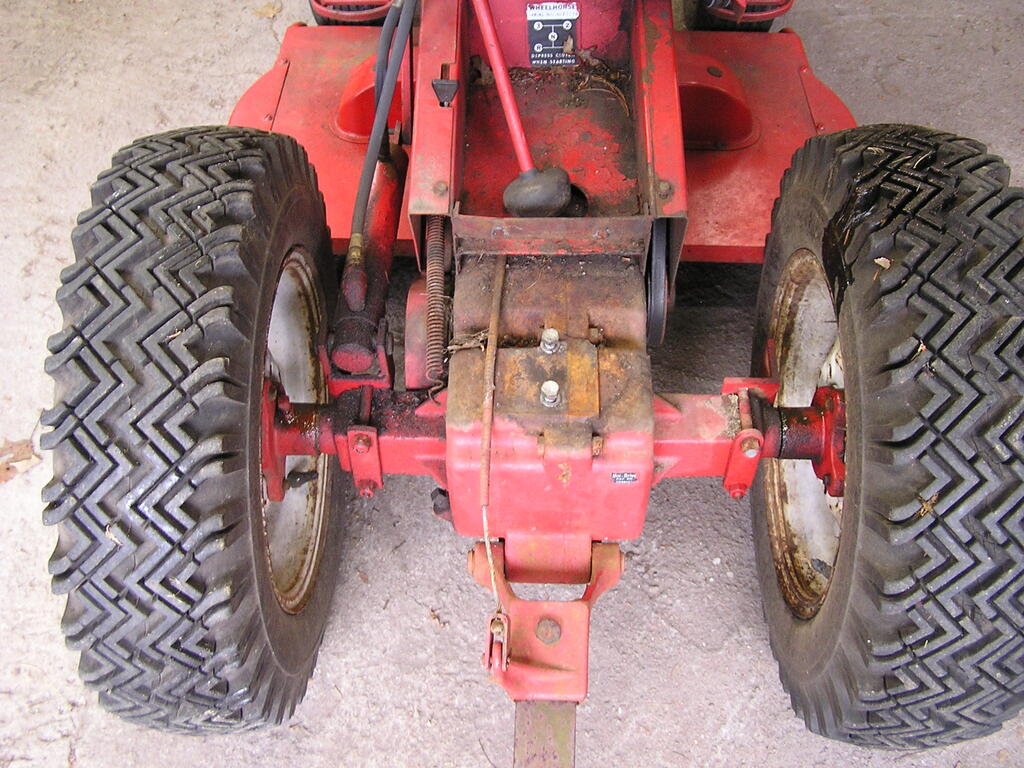

ri702bill 10,618 #7 Posted August 23, 2022 (edited) 1 hour ago, Pullstart said: I stole some stuff from Phil’s 753 post too! The 753 used a HY-3 kit - same pump, different rockshaft assembly - actually a LOT easier to install than a 502/552/702. getting the original lever and rockshaft removed is a true PIA on those - rates right up there wit removing overmolded steering wheels and rusted up hitch pivot pins. Did you get the ignition / starter switch relocation box with it ?? Lowell has the rebuild parts for the pump & cylinder - and the upgraded design centering spring. Pictures below are of the HY-2 I picked up - not one of my tractors. It has the 2 piece axle mount without the tiebar. I have the one like yours on the 854.... Edited August 23, 2022 by ri702bill 2 Share this post Link to post Share on other sites

peter lena 9,562 #10 Posted August 23, 2022 @Pullstart would not hesitate to use super lube on any o ring replacement point , made for dissimilar metals / contact , lets o rings be where they want to be , would also detail function of any / all related linkage points , look like an interesting project , pete 2 Share this post Link to post Share on other sites
Mike'sHorseBarn 3,372 #11 Posted August 23, 2022 Get a rebuild kit from lowell and go to town on it! It wouldn't surprise me if the neutral return spring was broken inside and jamming things up. They're almost always broken. I have an Hy-2 setup on my 753 and I like it. Mine leaks like a sieve though no matter how many seals I put on it. That just hasn't gotten far enough up my list of things to do though to get it fixed! 3 Share this post Link to post Share on other sites
Achto 30,210 #12 Posted August 23, 2022 (edited) @Pullstart Just remember that spool valve has a slight tapper to it. It has to push in to remove it, if you pull out on it you will damage it and it will be hard to get it to seal again. What ever you do, do not tap on the shaft to remove the pulley. You will risk shattering the pump gears. I found this out the hard way. Edited August 23, 2022 by Achto 1 1 1 Share this post Link to post Share on other sites
Pullstart 68,534 #13 Posted August 23, 2022 1 hour ago, ri702bill said: Did you get the ignition / starter switch relocation box with it ?? Yes I did, it’s in the box 1 Share this post Link to post Share on other sites
