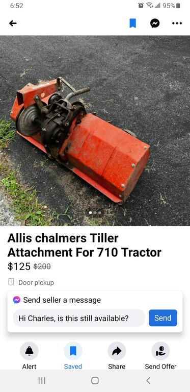

Hampton 95 #1 Posted August 23, 2022 Wondering if I can make this work on a 310-8. Share this post Link to post Share on other sites
Pullstart 71,366 #2 Posted August 23, 2022 I’m sure it COULD be, but I think the pulley is on the other side of what we call NORMAL Share this post Link to post Share on other sites
Hampton 95 #3 Posted August 23, 2022 Probably too much work. Share this post Link to post Share on other sites
sergeant 350 #4 Posted August 23, 2022 Look Over On My tractor forum dot com Somebody there did convert a Simplicity tiller to work On a Wheel Horse I think about 10 years ago or so 2 Share this post Link to post Share on other sites
gwest_ca-(File Mod) 12,510 #5 Posted August 23, 2022 Many/most Simplicity models have the engine located with the pto on the left side. Wheel Hose has the pto on the right side so drive belt direction of travel is opposite. 1 1 Share this post Link to post Share on other sites
Hampton 95 #6 Posted August 24, 2022 10 hours ago, gwest_ca said: Many/most Simplicity models have the engine located with the pto on the left side. Wheel Hose has the pto on the right side so drive belt direction of travel is opposite. While researching the forum, I found an old thread where someone had mounted a tiller on the front. Can't remember who though. That could put the everything on the correct side. Share this post Link to post Share on other sites
gwest_ca-(File Mod) 12,510 #7 Posted August 25, 2022 15 hours ago, Hampton said: While researching the forum, I found an old thread where someone had mounted a tiller on the front. Can't remember who though. That could put the everything on the correct side. Then you would have to till in reverse Share this post Link to post Share on other sites
Hampton 95 #8 Posted August 25, 2022 26 minutes ago, gwest_ca said: Then you would have to till in reverse That what this person was doing. Will probably get the correct tiller in the long run. I'm not much of a fabricator. Share this post Link to post Share on other sites
