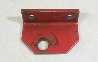

Jeff-C175 7,209 #58 Posted August 27, 2022 (edited) 19 hours ago, kpinnc said: PTO side Looks like I'll need to fabricate a bracket for the bottom of the PTO hoop since it's on the shaker plate which will go away. I think I can use the existing bolt hole and that 'extra' one on the mid-mount hitch to attach a bracket to the frame. What have others done in this situation? Is there a bracket already made for this from WH? Edited August 27, 2022 by Jeff-C175 1 Share this post Link to post Share on other sites
kpinnc 18,756 #59 Posted August 27, 2022 23 minutes ago, Jeff-C175 said: Is there a bracket already made for this from WH? Yes. I don't know the part number, but they are very common. Goes under the bolts in the belly hitch. 1 Share this post Link to post Share on other sites
Jeff-C175 7,209 #60 Posted August 27, 2022 (edited) 20 minutes ago, kpinnc said: Yes. I don't know the part number, but they are very common. Goes under the bolts in the belly hitch. I was just looking through the parts lists for non-shaker machines. I think that is this #99, which is p/n 102870: (edit: appears that the same basic part has a number of numbers! 22847, 22997, 18977 , at least according to ebay listings) Easy enough to make one if I can't find one. Since I'm a cheapskate, I'll make one. Plenty available but around $20 or so. Yeah, I'm that cheap! LOL! Edited August 27, 2022 by Jeff-C175 1 Share this post Link to post Share on other sites

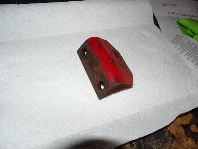

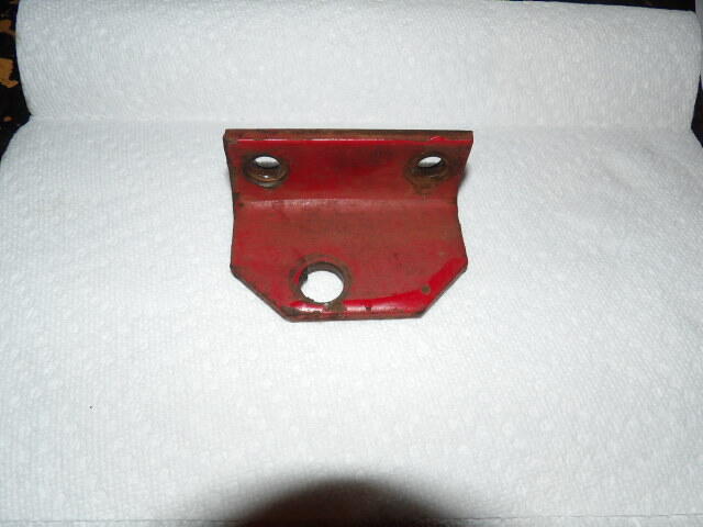

Snoopy11 5,731 #62 Posted August 28, 2022 3 hours ago, kpinnc said: Yes. I don't know the part number, but they are very common. Goes under the bolts in the belly hitch. 3 hours ago, Jeff-C175 said: if I can't find one. Sorry I'm late Jeff, but I have one of those if you need it. It's yours for the price of shipping. Shoot me an email if you want it... Don Share this post Link to post Share on other sites
Snoopy11 5,731 #63 Posted August 28, 2022 Some pictures of what I have in stock for your pleasure, @Jeff-C175... Don 1 Share this post Link to post Share on other sites

Snoopy11 5,731 #66 Posted August 28, 2022 Package with your part will be in the mail tomorrow afternoon! Don 1 Share this post Link to post Share on other sites

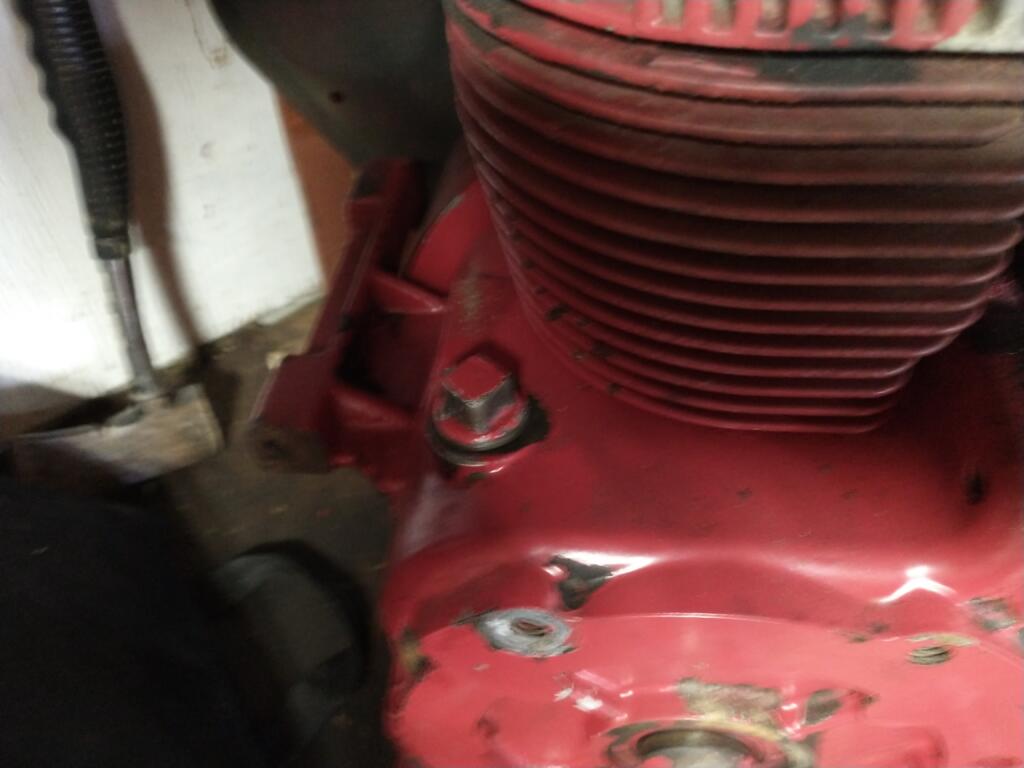

Jeff-C175 7,209 #69 Posted August 29, 2022 (edited) Yet another difference in the two blocks: The EP engine has the dipstick on the cam gear cover on the front of the engine which would be inaccessible when the muffler is mounted. I had planned to use the cover from the AS engine... I suppose I could figure out a way to do something different with the exhaust. Since the shaker plate will be gone, there's no place to bolt the bracket on the muffler anyway. I'd have to fabricate a bracket for that. And on the front of the block there is no provision for mounting the dipstick in the location on the front where the AS engine is. I had hoped to find a blank plate there after I removed the starter... but noooooo... Also, there's a plug in a tapped hole where the AS engine has none. I could use that location for the dipstick and try to find the correct length (or modify the existing) dipstick. I would need to find the correct tube (if one exists) (or make one) for that location. I suppose I could also machine the block to accept the dip tube and stick from the old engine... sounds tedious to me. Was it @Achto who suggested just rebuilding the old engine? Looking more and more like a good idea at this point. I still have the option of putting the generator back together ... didn't break anything ... yet! Edited August 29, 2022 by Jeff-C175 3 Share this post Link to post Share on other sites
squonk 47,421 #70 Posted August 29, 2022 (edited) 1 hour ago, Jeff-C175 said: Where that plug is is where most old Kohlers had the oil fill/dipstick. You could probably get that plug/stick from AZ Tractor. Edited August 29, 2022 by squonk 1 Share this post Link to post Share on other sites
Jeff-C175 7,209 #71 Posted August 29, 2022 46 minutes ago, squonk said: dipstick Although that would make it more trouble to check the earl level! I did see a few of those on eBay as well. Share this post Link to post Share on other sites
pfrederi 20,883 #72 Posted August 29, 2022 If you go with eh screw dipstick Big block ones are different from small. K301 used either 235320 8-7/8 " or 235747 8-3/32 K181s use 6-9/16 230097 Share this post Link to post Share on other sites
Jeff-C175 7,209 #73 Posted August 29, 2022 29 minutes ago, pfrederi said: If you go with eh screw dipstick Big block ones are different from small. K301 used either 235320 8-7/8 " or 235747 8-3/32 K181s use 6-9/16 230097 Good info Paul, thanks! Pretty sure I can make the rod in the pipe plug variety easily. At the moment though, I'm thinking that I'll make a tube somehow and use the original stick, assuming of course that I can make it work with the tube I fabricate. Share this post Link to post Share on other sites
