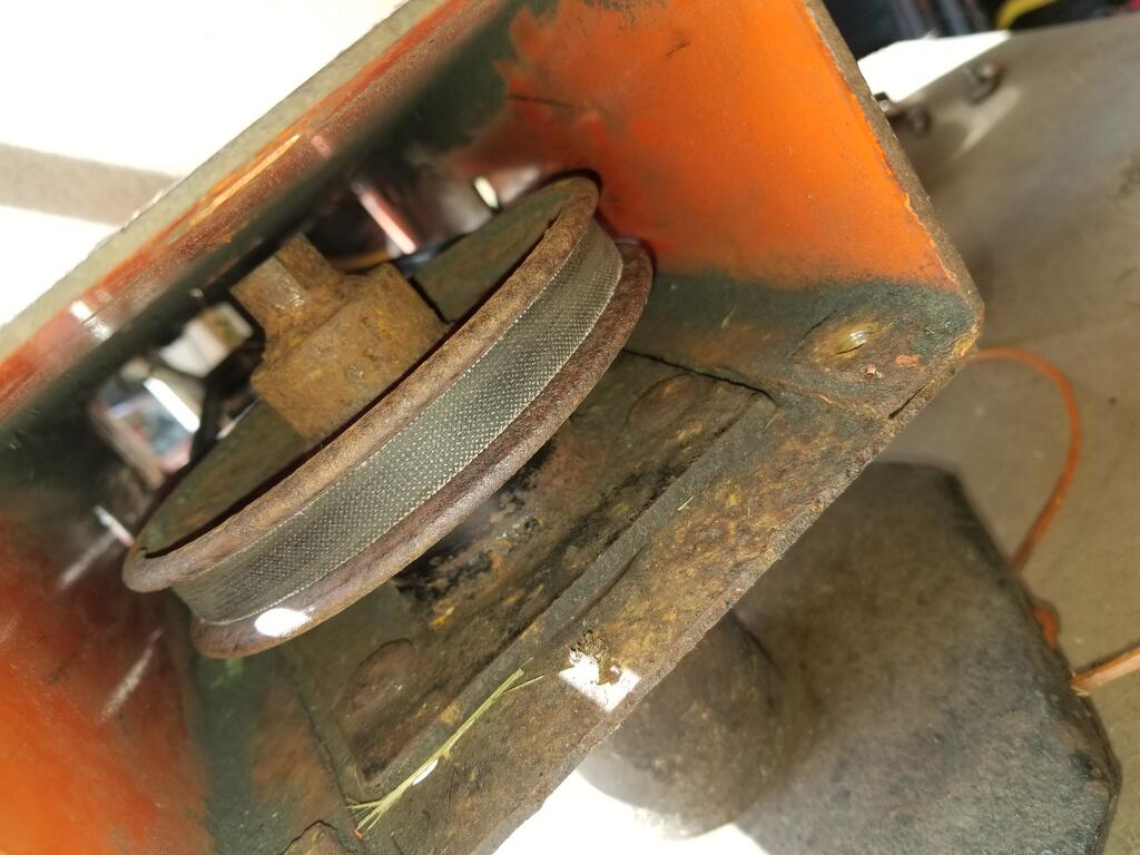

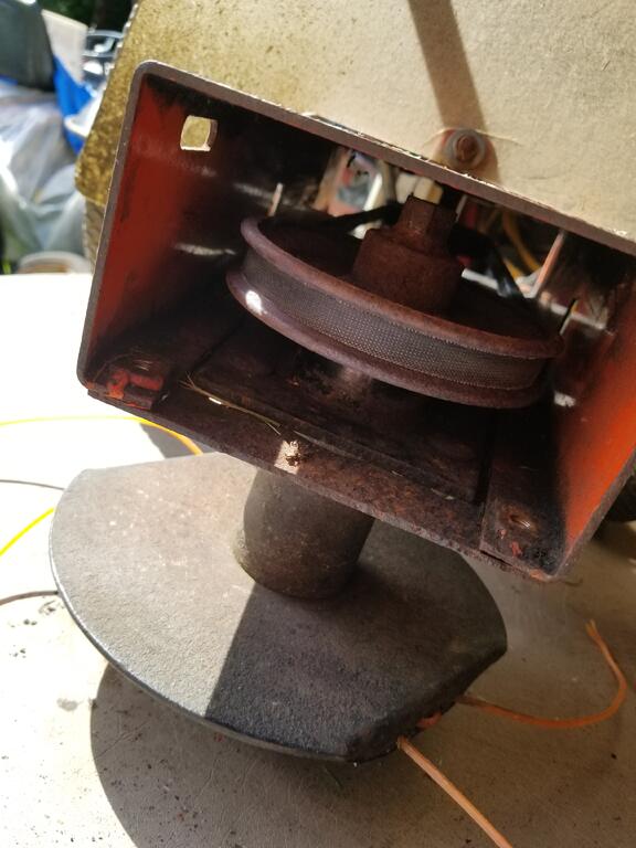

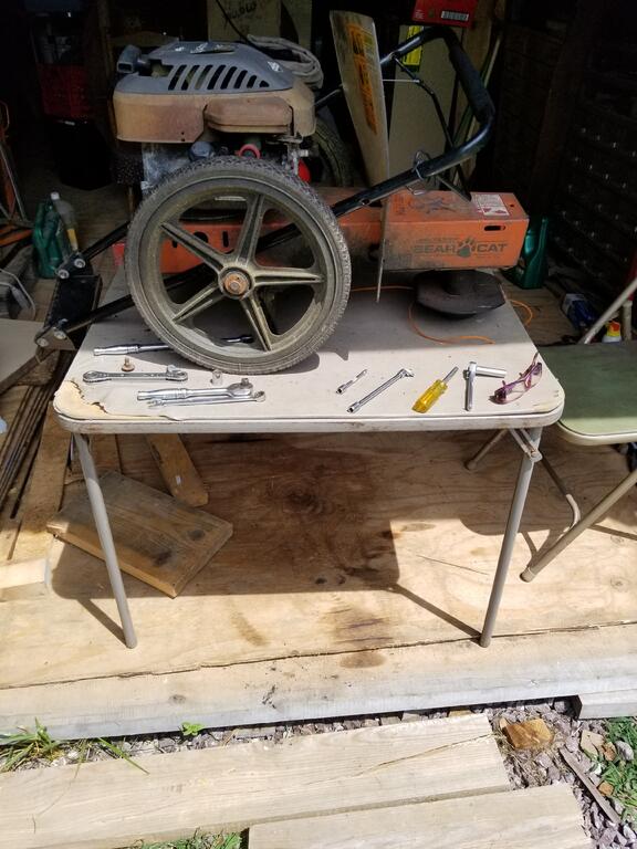

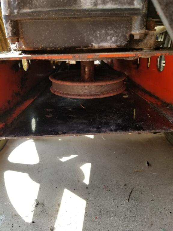

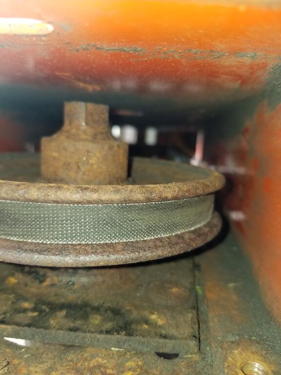

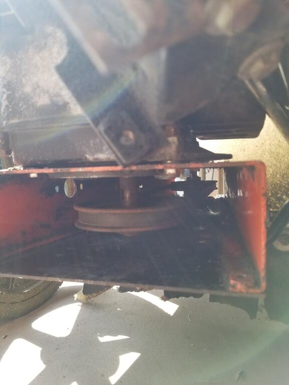

cafoose 3,853 #1 Posted August 21, 2022 I got this Bearcat 73040 trimmer and the belt keeps jumping off after about two minutes of running. It's a pain to put it back on because I have to remove 7 bolts to get to it and reach inside a very small opening to feed it back on the pulleys. I took a straight edge and made sure the pulleys were aligned properly. The bearings are good and the belt is new and tight. What could be causing it? Share this post Link to post Share on other sites
Ed Kennell 47,397 #2 Posted August 21, 2022 Is the belt width OK Chuck? Entire belt in the Vee? 1 1 Share this post Link to post Share on other sites

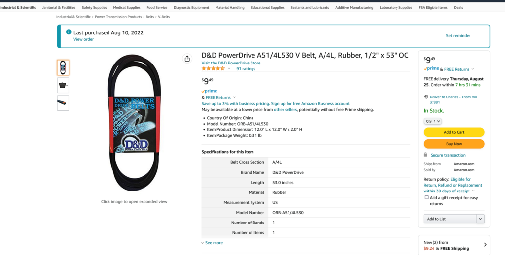

cafoose 3,853 #3 Posted August 21, 2022 Yes entire belt is in the Vee. I ordered this from Amazon. Maybe I should have gotten a Kevlar belt? I may try and return it. https://www.amazon.com/dp/B00E42CID2?psc=1&ref=ppx_yo2ov_dt_b_product_details Share this post Link to post Share on other sites
Ed Kennell 47,397 #5 Posted August 21, 2022 Hard to believe the belt can get out of those pulleys. What's with the empty key slot in the one pic? 1 Share this post Link to post Share on other sites
cafoose 3,853 #6 Posted August 21, 2022 (edited) 7 minutes ago, Ed Kennell said: What's with the empty key slot in the one pic? I think the engine was made for different applications Edited August 21, 2022 by cafoose 2 Share this post Link to post Share on other sites
