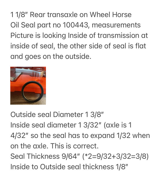

Willie 14 #1 Posted August 21, 2022 This might help someone someday. 2 1 Share this post Link to post Share on other sites
Appalachainedge 0 #2 Posted August 22, 2022 Hey Willie, you wouldn't know the axle bearing replacement numbers would you? An where I can purchase? I have a couple of tractors tranny's tore down & would be very expedient with numbers & supplier info one is 1'" & one is 1 1/8 Share this post Link to post Share on other sites

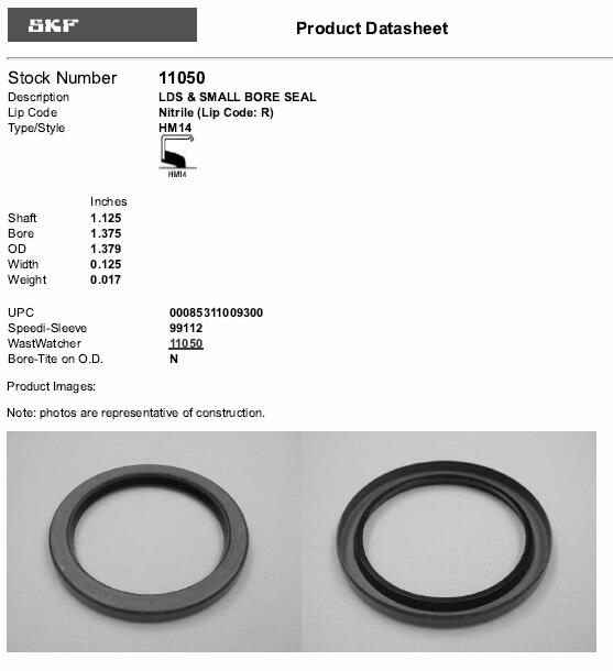

gwest_ca-(File Mod) 12,418 #3 Posted August 22, 2022 Wheel Horse 100443is SKF/CR 11050 Share this post Link to post Share on other sites
