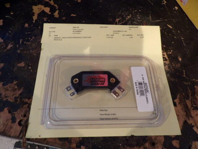

Snoopy11 5,731 #51 Posted August 25, 2022 14 hours ago, ebinmaine said: Amaz'n ? Yeah, I guess Tarzan must have caught the mail truck before it left the jungle... 'cause they were able to cancel the order. I'm off to purchase the correct sensor... @Heatingman... I think I am going to go with a '99 ABS wheel speed sensor off an F150... like the guy in the video did. What do you think? \ By the way... my ignition module is... out for delivery today. I JUST ORDERED IT YESTERDAY!!!!!!!! Don 2 Share this post Link to post Share on other sites

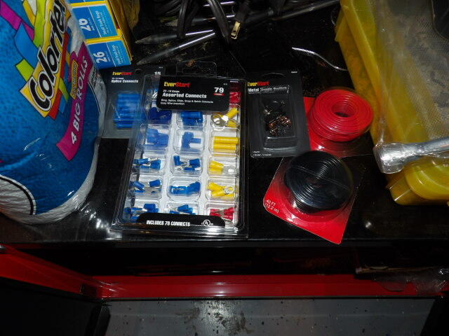

Snoopy11 5,731 #54 Posted August 25, 2022 I forgot to mention, I picked up a good bit of wiring and connectors yesterday, along with a switch for the ignition system. I am most likely going to make some sort of mounting bracket on the engine for all of the new ignition electronics. This mounting location will have room for an added voltage regulator later on. Don 2 Share this post Link to post Share on other sites

Snoopy11 5,731 #58 Posted August 25, 2022 56 minutes ago, ebinmaine said: If you only want a carburetor just to be able to hear it run you can use a Kohler carb. You know I could make that work... Only K series carb I have is on the 341 though... On a different note, look what showed up today... (these part's people OVERNIGHTED it to me...) Electrical supplies to add to my collection... I've got to find that coil before it finds me! Don 2 Share this post Link to post Share on other sites
