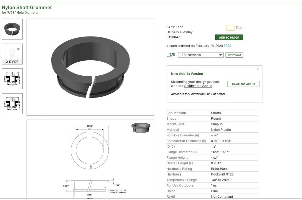

pfrederi 20,878 #5 Posted August 20, 2022 McMaster various sizes available Share this post Link to post Share on other sites
