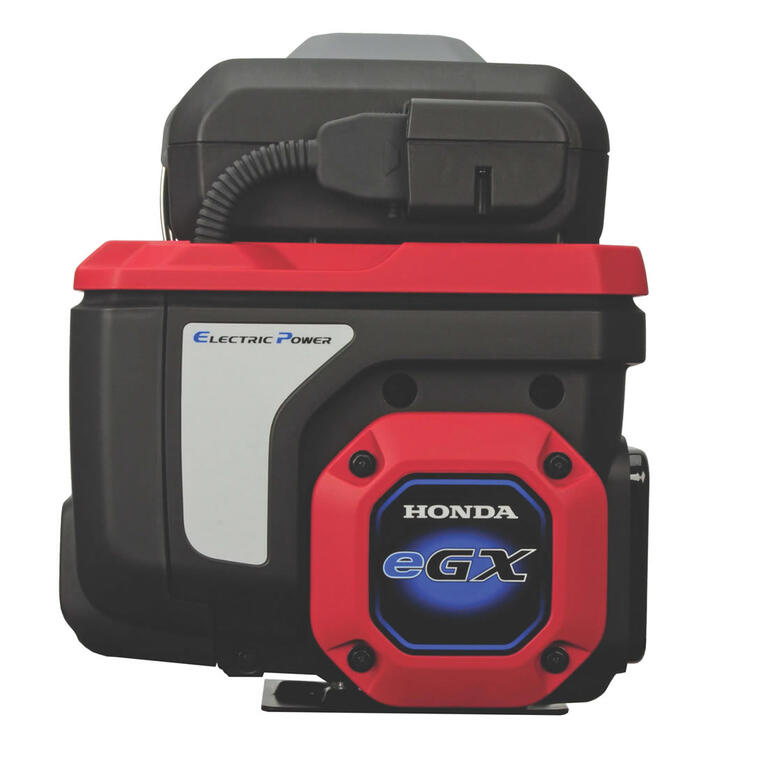

wh500special 2,359 #1 Posted August 17, 2022 (edited) I was engine shopping on Honda's website today and found these new electric power units (battery/controller/motor). So far these are only in the 2.4-HP class, but I'd bet we see bigger ones soon. I would think one in the 5-hp range would be a perfect swap into a smaller Wheel Horse like a shortframe/suburban. Honda GXE2.0 Even this one would work well as a drive motor for the transmission on a C-series if you also added electric power to the attachments separately. I think this is brilliant packaging that will permit easy swapping and seamless integration into legacy equipment. They do also offer a divorced battery/motor version. I didn't do the math on runtime/chargetime/etc. But would bet that runtime would approximate whatever a normal tank of gas would provide on an engine this size. This is quite exciting! Steve Edited August 17, 2022 by wh500special 4 2 Share this post Link to post Share on other sites
SylvanLakeWH 29,821 #2 Posted August 17, 2022 (edited) Right along lines of what I’m thinking of doing for a backyard cruiser repower for little guys… thanks for posting! Doesn’t look like available yet for aftermarket…? Edited August 17, 2022 by SylvanLakeWH Share this post Link to post Share on other sites

wh500special 2,359 #7 Posted August 17, 2022 Curiosity got to me... The spec shows this has a 748 W-hr battery. The motor is 1.8 kW. That suggests that the battery life under full load is only about 25 minutes if drawn down completely. Assuming the battery management system allows only 80% discharge, this translates to 20 minutes at full load. It's doubtful that the machines to which this would be mounted would ask for 100% load 100% of the time, so actual battery life may not be so bad. But it's clearly limited by trying to maintain the same physical envelope as a normal engine and fuel tank. And certainly an OEM would outfit these to only run when under load so there would be no idling, warmup, etc. Before we scream "that won't work!" we probably need to wait for better specs and find out what accessories and additional battery sizes might be offered. But this does temper my enthusiasm. I'll probably chime in on the renewable and clean aspects later. But the general implications of electrification are for gained overall efficiency in most (not all!) cases. Steve 3 Share this post Link to post Share on other sites

wh500special 2,359 #10 Posted August 17, 2022 27 minutes ago, 8ntruck said: ...How many kWh does a gallon of gas equal? How many gallons of gas are burned daily? Though the theoretical number is higher, 33.7 kW-hr/gallon is commonly used. Chemists would calculate or measure this this in joules or calories. So the "tank" in our Honda eGX is 0.02 gallons or about 3oz. For comparison, a typical push mower holds about a quart (32 oz) but will expel 2/3 of that gas energy as waste heat in the exhaust and cooling air. Steve 1 Share this post Link to post Share on other sites
