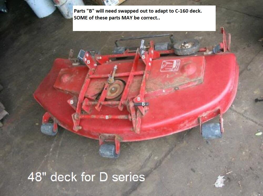

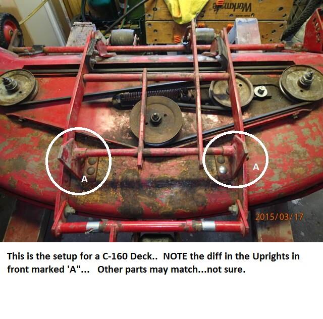

richmondred01 2,372 #1 Posted August 16, 2022 From what I can recall the 48” attach o matic deck from a c series or 300/400/500 will fit on the d200. I seem to recall the only difference was the the attachment bar was a bit different but they are interchangeable. Am I correct? Thanks Share this post Link to post Share on other sites
daveoman1966 3,882 #2 Posted August 16, 2022 There is little difference between a 48" deck for a 'C' 300, 400, 500 series and the 'D' series. Mostly the tach-o-matic hardware, but the deck, spindles, blades are the same. Share this post Link to post Share on other sites
