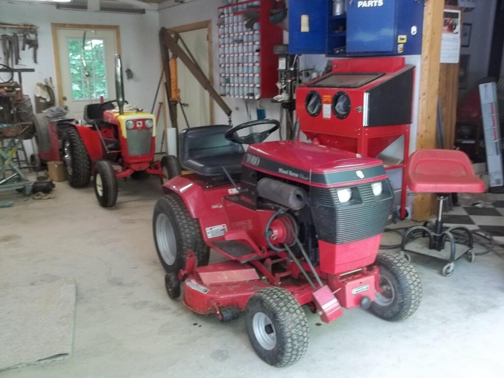

Hampton 95 #1 Posted August 15, 2022 I have one on the 310-8 I bought. What's it for? Share this post Link to post Share on other sites
davem1111 2,274 #2 Posted August 15, 2022 Don't you have a deck on the tractor? The mule drive is to transfer power from the horizontal crank and PTO on the engine to the vertical drive pulley shaft on the deck. 4 Share this post Link to post Share on other sites
Ed Kennell 46,132 #3 Posted August 15, 2022 Here's the old style frame mount spring loaded mule drive. slt. Your 310-8 has the newer attach-a-matic mount with a screw to apply tension to the deck drive belt. 3 Share this post Link to post Share on other sites

Hampton 95 #6 Posted August 16, 2022 I have the attach o matic. Thanks folks Share this post Link to post Share on other sites

ri702bill 12,170 #16 Posted August 17, 2022 Awww, OK, back to mule drives - mower belt goes on the larger pulley of the PTO, as pictured above... you'll wonder why it does not cut well if is on the smaller one! Share this post Link to post Share on other sites
