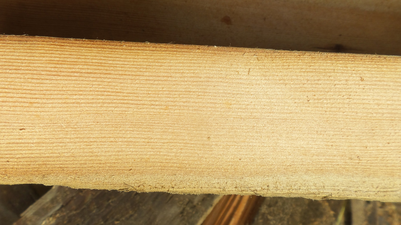

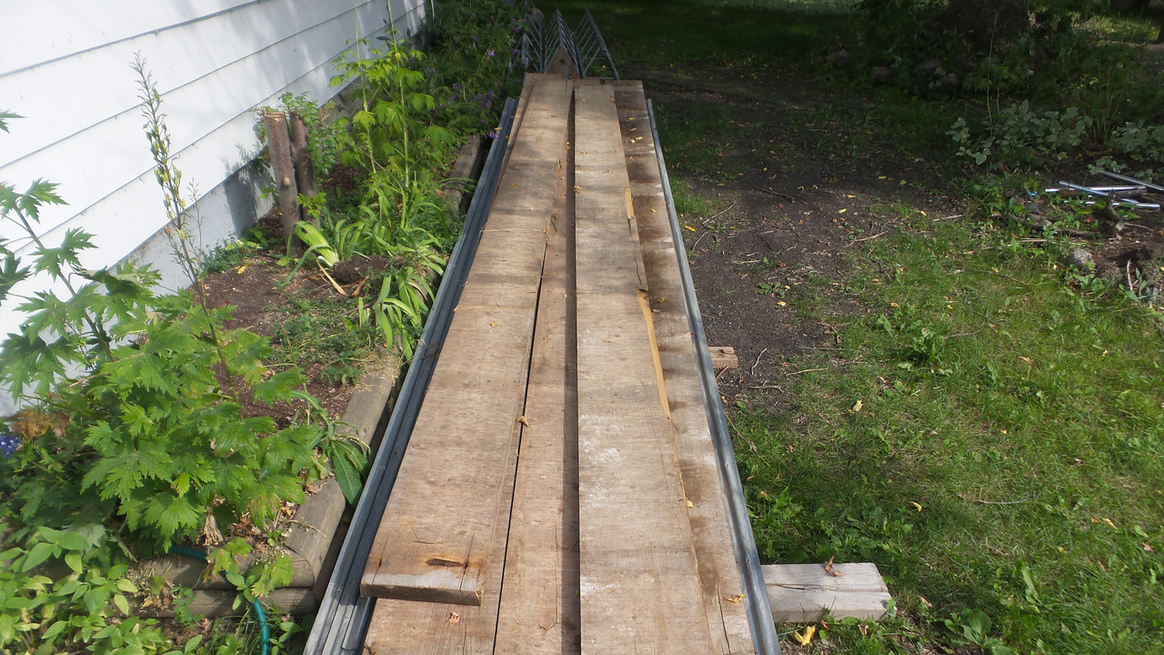

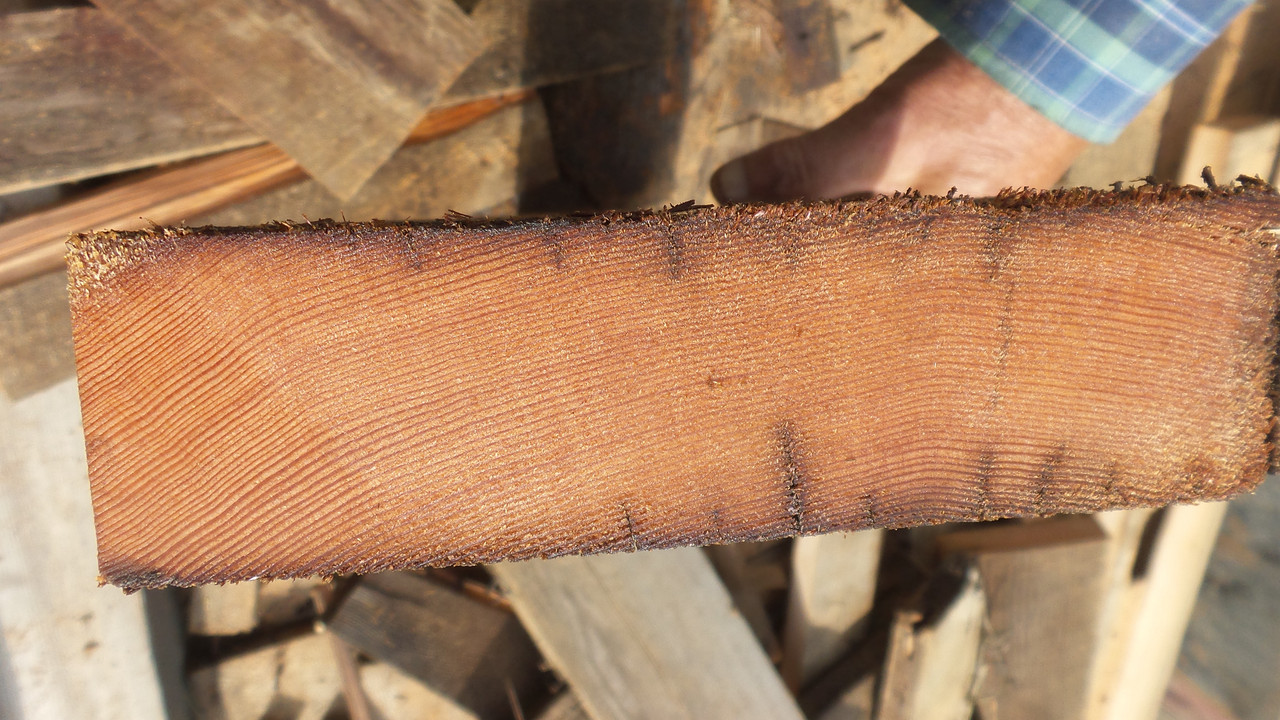

bc.gold 3,406 #1 Posted August 15, 2022 The demolition almost completed, salvaged. 1. Galvanized roofing. 2. 2"x12" x 16 ft. 3. 2"x8" x 20 ft. All of the lumber is first growth Douglas Fir, number one clear. Thoughts on using Canola oil as a wood preservative, this oil soaks into the wood with good penetration but it's a non drying oil. On the test piece I did the water sloughs right off. 1 Share this post Link to post Share on other sites
Handy Don 15,676 #2 Posted August 15, 2022 Nice save on the lumber. Any reason why you need to treat it now and now wait until you use it for a project? Kept dry and under cover it shouldn't degrade. 1 1 Share this post Link to post Share on other sites

Handy Don 15,676 #4 Posted August 16, 2022 2 hours ago, bc.gold said: Ardox nails Yep, they are great for making sure things stay together but killers for reusing materials. A prime Doug Fir 2in x 8in x 20ft beam around here goes for $36+ and it won't be nearly as dense a grain as what you've got there. 1 Share this post Link to post Share on other sites
Jeff-C175 7,207 #5 Posted August 16, 2022 On 8/15/2022 at 9:29 AM, bc.gold said: lumber Hopefully you don't have the dreaded "Powder Post Beetle" up your way? Inspect carefully for tiny pinholes if you do have them there. "TIMBOR" treatment would be advised if they are present. Share this post Link to post Share on other sites
bc.gold 3,406 #6 Posted August 16, 2022 (edited) 1 hour ago, Jeff-C175 said: Hopefully you don't have the dreaded "Powder Post Beetle" up your way? Inspect carefully for tiny pinholes if you do have them there. "TIMBOR" treatment would be advised if they are present. Only thing noted was a ton of mouse poop and the husks from choke cherry pits. Edited August 16, 2022 by bc.gold 2 Share this post Link to post Share on other sites

bc.gold 3,406 #12 Posted August 24, 2022 Any Archers on the forum, I see some nice arrow blanks being cut in the near future. D-Fir first growth, tight grain. Share this post Link to post Share on other sites
