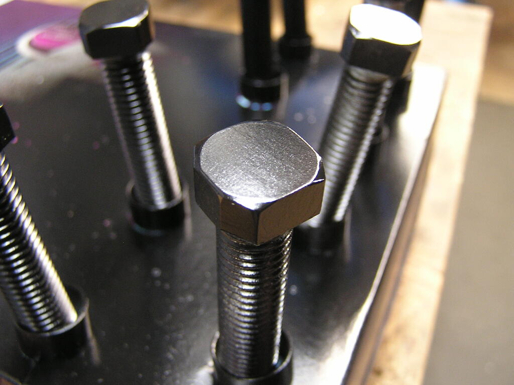

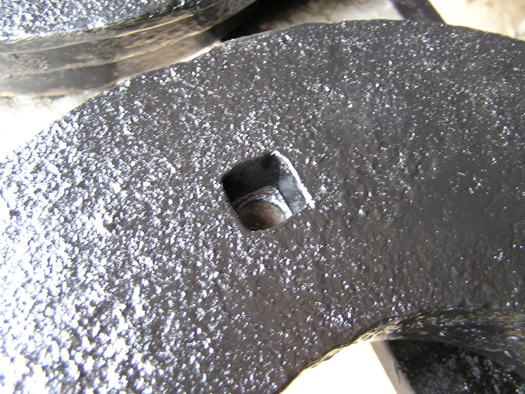

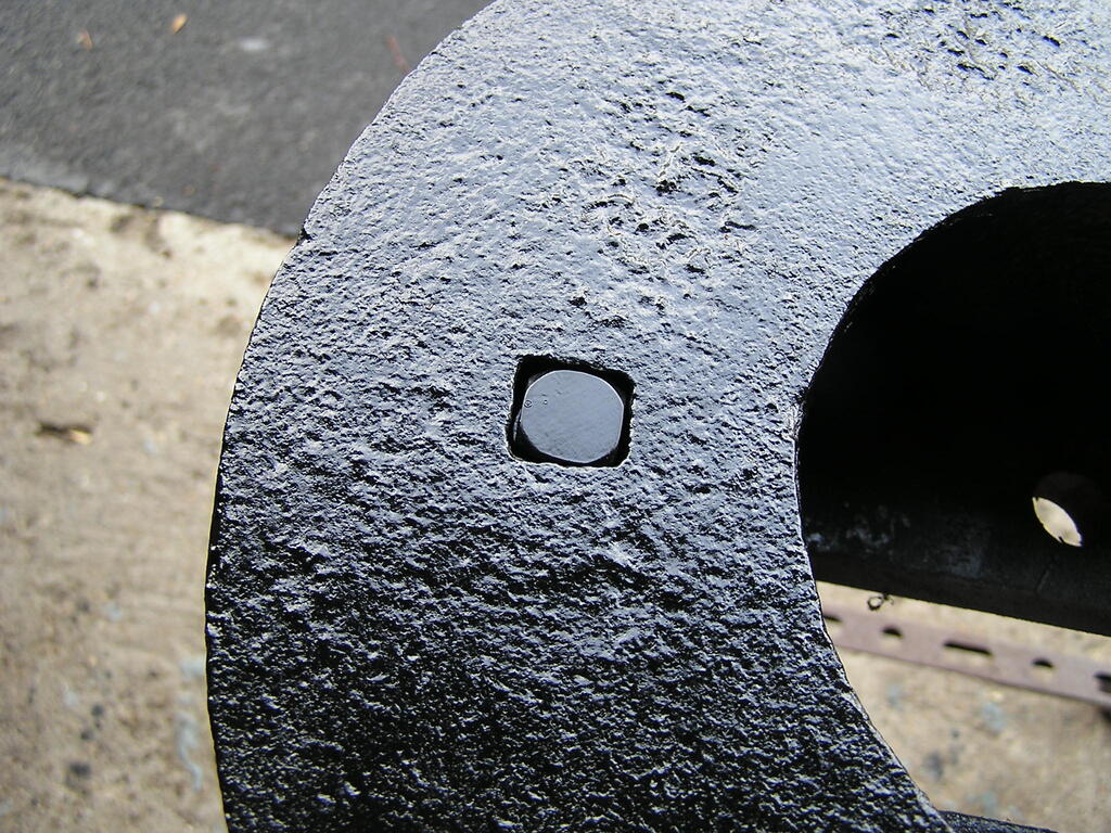

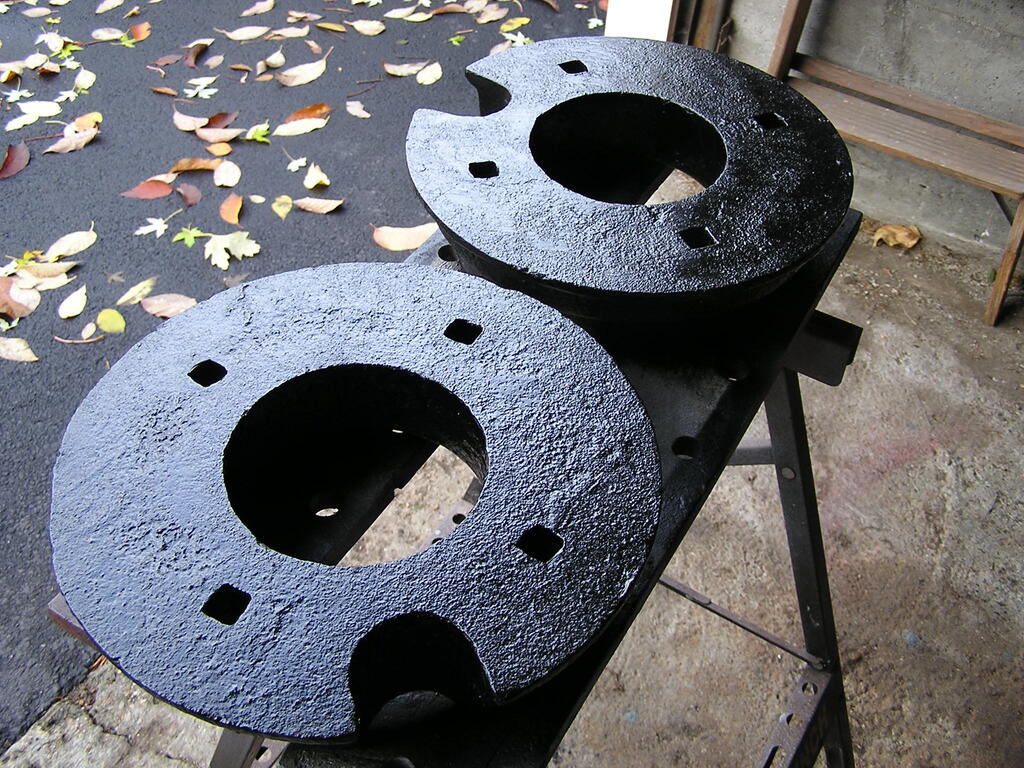

ri702bill 11,492 #131 Posted October 13, 2022 Steve - nice fit on the cast iron wheel weights I bought from you Saturday. Took the coating off the outsides with a needle scaler, three coats of semigloss black and they look great. Got a little creative with the hardware, turned eight 1/2" x 6" hex bolts into square head bolts to fit the 11/16" pockets. The bolts got a coat or 2 of black today. Thanks to you and your immediate family for making the WH family welcome. Bill & Chris 3 Share this post Link to post Share on other sites

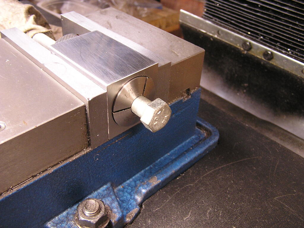

ri702bill 11,492 #134 Posted October 14, 2022 (edited) Patience, young Skywalkers .... like a couple of kids in a candy store ! .... I had to wait for the rain to stop to snap these pictures...... Machining the bolt heads down from 6 to 4 sides is super easy if you have the tooling - I have the matched pair of square and hex collet blocks. They use standard 5C Lathe collets and they are true for shape, position, and centerline height within .001 inch. Fixture the bolt, touch the end cutting tool to a top flat, zero the Z axis, move the part, advance the Z down .040 and lock it. Cut the first flat, remove the block, rotate it 90 degrees, clamp it and take a 2nd cut. Repeat for the other two sides, remove & deburr. The fixturing & milling machine do all the work - I'm just the guy working the handwheels.... Repeat to remove the raised text on the heads, using a large side cutting endmill... Edited October 15, 2022 by ri702bill Share this post Link to post Share on other sites
