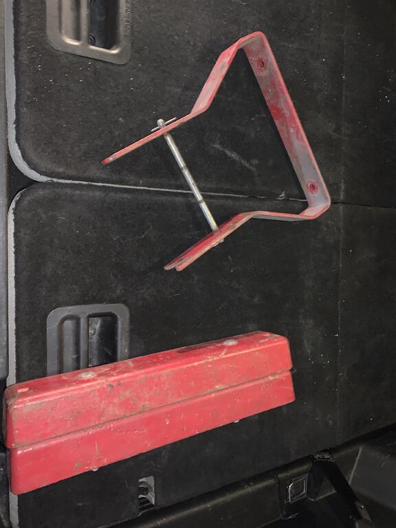

wh5208speed 677 #1 Posted August 14, 2022 Picked up this cast iron front weight bracket today. Need to find the special bolts for the frame, but this will help put some down pressure on the front tires while plowing snow. 5 Share this post Link to post Share on other sites

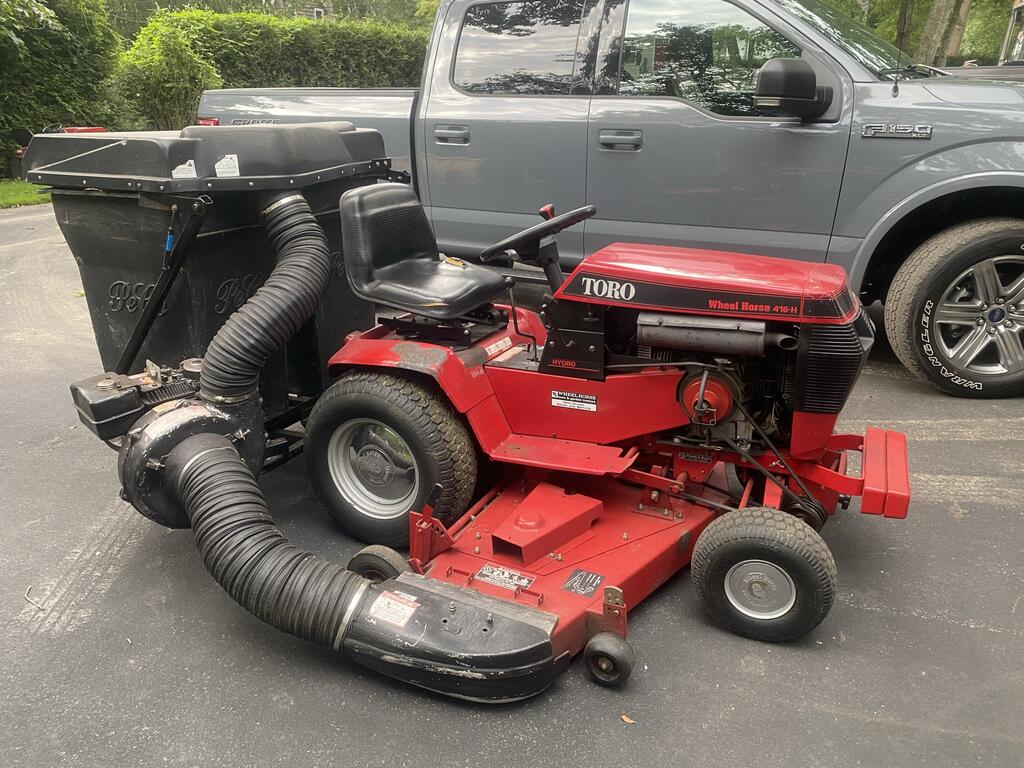

c-series don 12,126 #2 Posted August 14, 2022 I found one in a dealers basement a few years ago. Definitely helps with my vacuum setup and the weight of the loaded buckets of grass clippings. 5 1 Share this post Link to post Share on other sites

Pullstart 70,702 #6 Posted August 14, 2022 12 hours ago, wh5208speed said: Need to find the special bolts for the frame My front hanging weight simply has SBC exhaust manifold bolts pushed into the holes. The weight hangs on the frame and creates a leverage that doesn’t allow the bolts loose. I’m not sure if this will help you or not, but I figured I would mention it. Share this post Link to post Share on other sites
wallfish 20,219 #7 Posted August 14, 2022 12 hours ago, wh5208speed said: Need to find the special bolts for the frame No special bolts required? 3/8 x 1 1/4" should do it. Look at the manual pic gwest posted, the bolts are shown in the pic. Everyday 3/8 bolts with washers. It doesn't need to pass all the way through the frame like the bar with the clips is doing Share this post Link to post Share on other sites
SPINJIM 1,997 #8 Posted August 14, 2022 Someone at the Big Show sold me one of those brackets that he had custom made; perfect replica. Don't know if he is making them in any quantity, but there seems to be some demand for them. They're NLA from Toro, but when they were available, they were $125. The bolts for the mounting of the bracket are nothing "special"; just a high strength hex head that go through the holes already drilled in the frame of most models. Share this post Link to post Share on other sites
