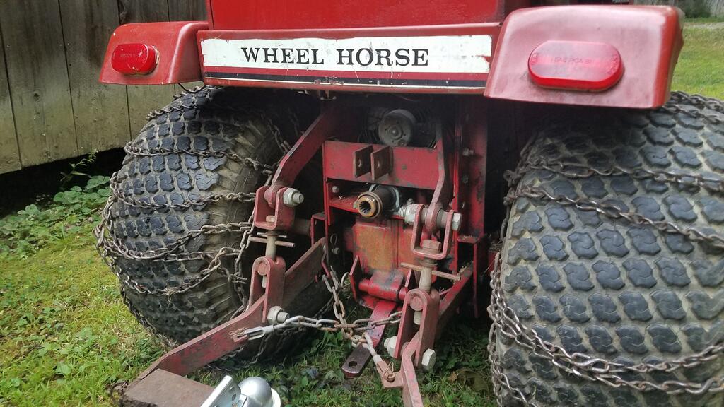

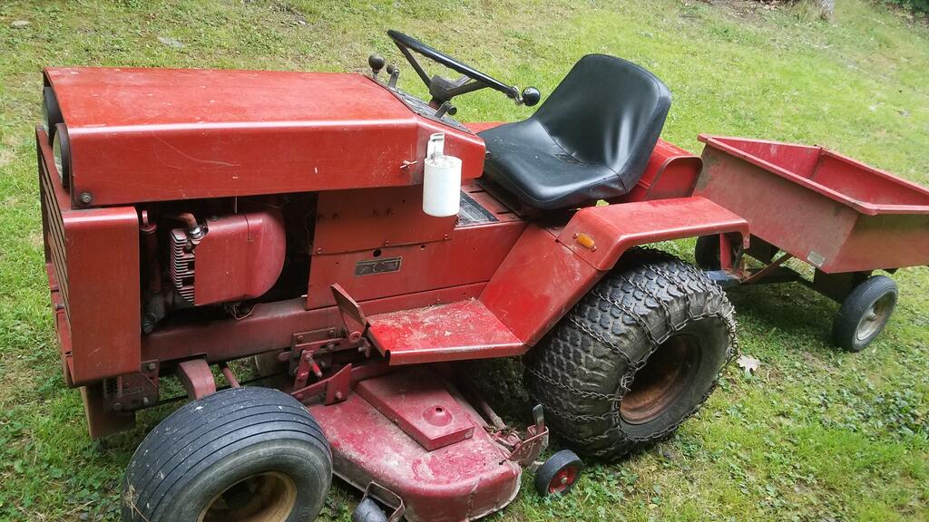

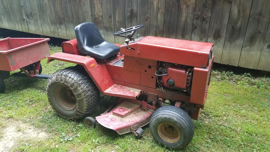

Forrest Carver 52 #1 Posted August 12, 2022 (edited) I have 1975 D160 which you all helped me troubleshoot and fix recently (thanks!) It has the hardtop cockpit, mower, plow, snowblower, and rototiller (for sale if anyone's interested, I have no use for it). My question is, are there any newer backwards-compatible or custom attachments that this model is powerful enough to run? I'm interested in a loader, shredder, chipper, sand/salt spreader, cement mixer, sanding tumbler, backhoe, sawmill, log splitter, ditch witch, forks, stump grinder, and possibly others. I know my tractor isn't powerful enough to run most of these but I'd be curious what it is capable of. Edited August 14, 2022 by Forrest Carver pics! 1 Share this post Link to post Share on other sites
ri702bill 12,170 #2 Posted August 12, 2022 Welcome! Please post individual ads in the For Sale section for each of the items you wish to sell - that way each gets the single attention. D160 - depends if you have a front, rear, or neither PTO for options you can EASILY use with this machine - pictures fron ALL sides will be necessary to give you better advise... Bill 1 Share this post Link to post Share on other sites

Forrest Carver 52 #4 Posted August 13, 2022 Pics are up! 1 Share this post Link to post Share on other sites
