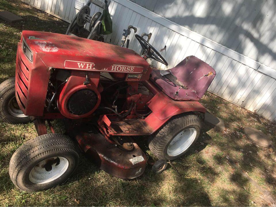

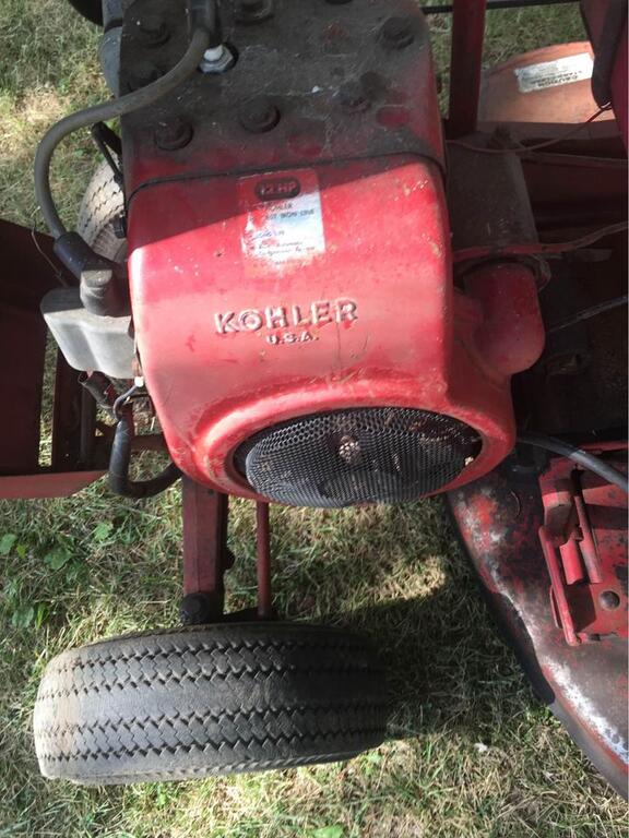

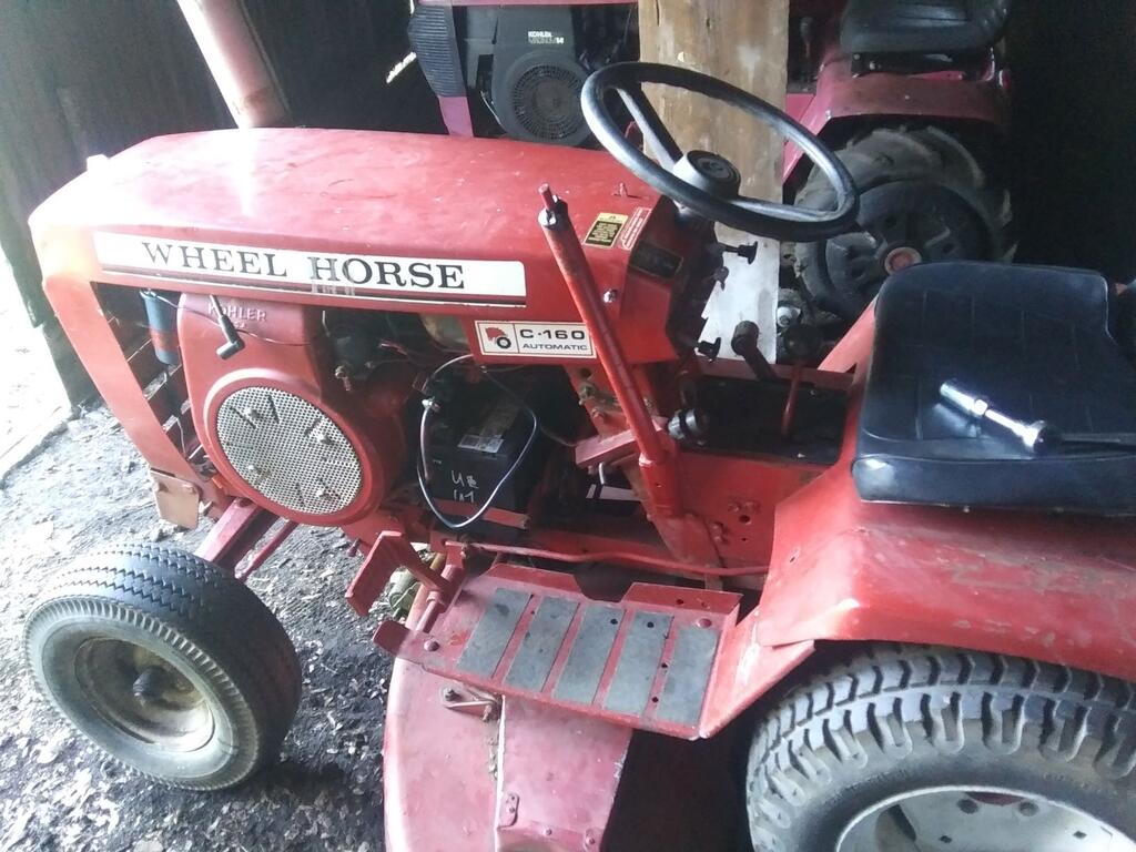

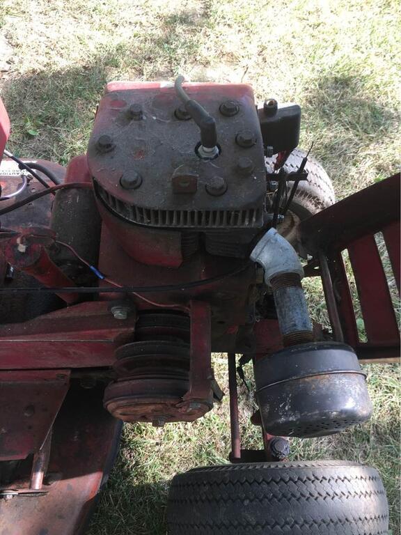

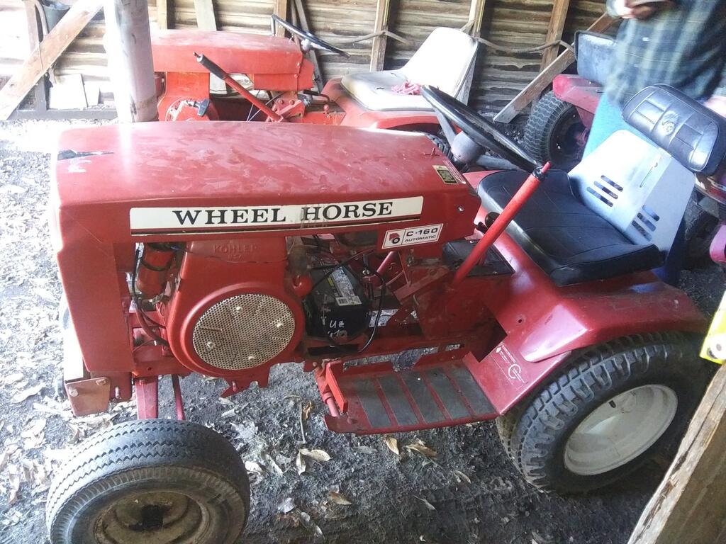

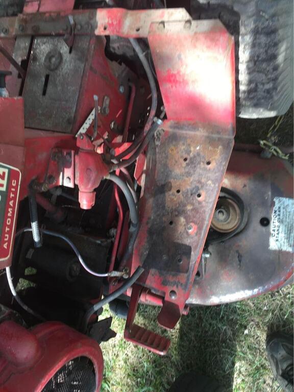

upstateyankee50 59 #1 Posted August 12, 2022 well guys I did it again as another horse in the sable ;I think I need to see a doctor as I can not stop this habit of having the horses ; the other day searching though the market place here in the Springfield Mo area a seller had a wheel horse listed for 150.00 so as with most collectors I jumped on it; it seems that he did have a buyer but he backed out ; odd really as a horse is a horse no matter the condition and this one really isn't that bad; yes it needs a little loving care like most 'so today I took the long 1 hour drive to check it out; yes it needs a seat plus a few more minor things but I thought for the price it was worth it; it needs a head gasket which is no big deal plus a fuel filter and a carb gasket which was ordered to day ;the filter is on plus the gasket for the carb 'the tires are all in good condition it has the electric clutch which works plus the breaker-less -ignition which has power but with the battery being so low it would beardly turn over but again there is power there' it is a 1970 elector 12 horse ;the model is 1-7255 tomorrow with a good battery I need to cross my fingers and hope it starts ;the deck is in good shape as it needs a good cleaning plus I will need to find the air filter cover 'so now I have one for each day but Sunday as that is a day of rest 9 3 Share this post Link to post Share on other sites
D_Mac 9,339 #2 Posted August 12, 2022 Nice find. Willing to bet with some starting fluid and a battery it fires. 2 Share this post Link to post Share on other sites
EB-80/8inPA 2,116 #3 Posted August 12, 2022 That’s worth $150 all day long, even on Sundays! 2 1 Share this post Link to post Share on other sites
Retired Wrencher 6,979 #5 Posted August 12, 2022 Good pick up. Enjoy it. Give it a good cleaning to see where you are at. Meaning oil/grease seals/ gaskets. Because it is a 1970 model. 1 Share this post Link to post Share on other sites

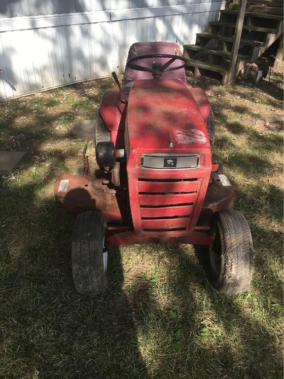

upstateyankee50 59 #6 Posted August 12, 2022 11 hours ago, Retierd Wrencher said: Good pick up. Enjoy it. Give it a good cleaning to see where you are at. Meaning oil/grease seals/ gaskets. Because it is a 1970 model. yep I always give them a good cleaning and grease every fitting 'plus oil changes and filters now I have a 66- 68-69 -70 73 no name and a 74 B-80 6 total and always room for a few more awesome really Share this post Link to post Share on other sites

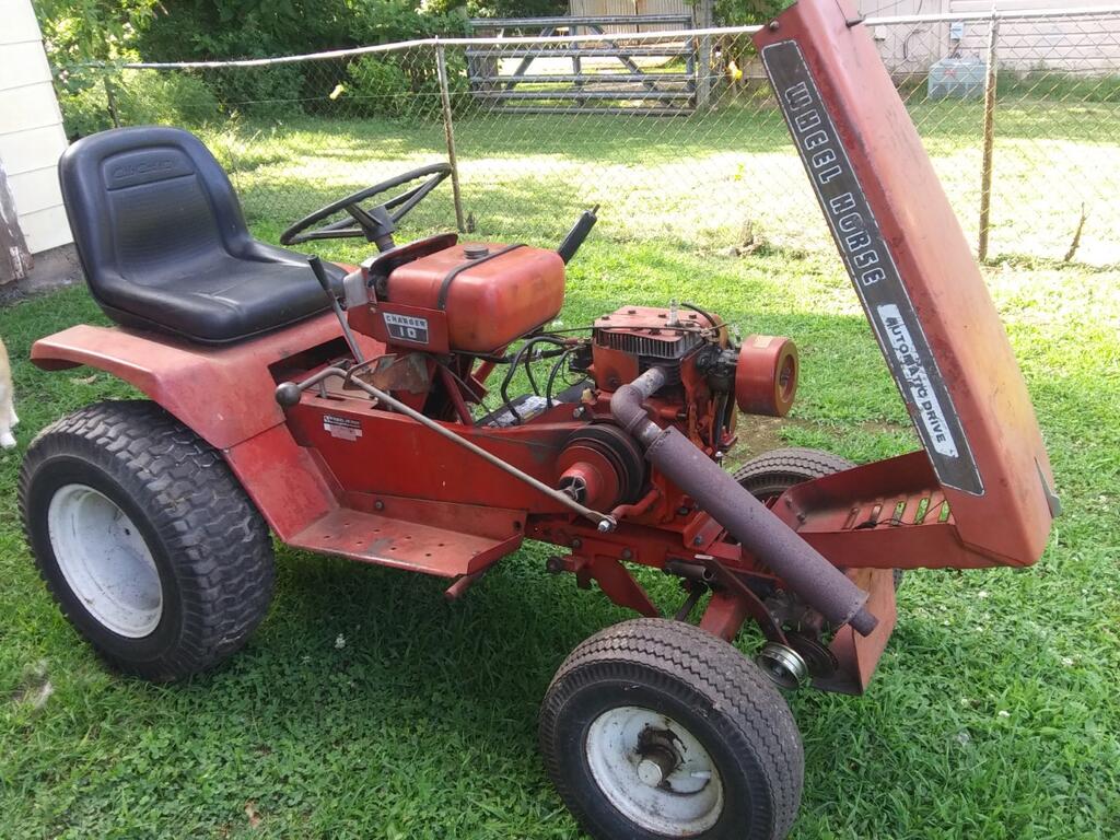

upstateyankee50 59 #11 Posted August 14, 2022 14 hours ago, Retierd Wrencher said: That is great. I had 73 no name 8 was not impressed with it. It had funky engineering. I guess a bad year. I hope you enjoy them all. for sure I will and the no name I have has the 16 horse Kohler heck for a 100 bucks I couldn't go wrong as the power it has Share this post Link to post Share on other sites
upstateyankee50 59 #12 Posted August 14, 2022 On 8/11/2022 at 9:10 PM, D_Mac said: Nice find. Willing to bet with some starting fluid and a battery it fires. yep today I put the carb on, hook up the choke and throttle cable and with help with the pick up as a jump 'the battery needs to be replace than a shot of gas in the front and the old girl started right up ; a ride around the yard and it sure does move ;every thing seems work but the head lights but that is a simple fix ; so now to find the air filter assembly as it didn't have it ; what a deal for 150 the seat is fine as they covered it with some material to protect it ' 1 Share this post Link to post Share on other sites
upstateyankee50 59 #13 Posted August 14, 2022 19 hours ago, kpinnc said: My Bronco 14 has that set up, and it's awesome. Basically a Magnum 14 with older tins on it. Mine has lasted a long time. OEM as far as I can tell. I hope it continues, because the module is crazy expensive IF you can find one. Nice find BTW. good solid machine! thanks and for sure a great fine ; I have to agree as the price of the module is top dollar if you can fine one 'but it seems I was lucky this time as it seems to be fine and has spark ;today I added the carb 'hooked up the choke and throttle cable and a shot of gas the old girl took right off and yes a test ride boy is it fast plus runs super fine ;now to degrease the motor and frame as so much crud built up ;then to grease the fittings and change the tranny filter ;;it seems I will have to search for the air filter assembly as it didn't have one ;really for a 150 price I did alright the tires are all up no leaks ; Share this post Link to post Share on other sites
upstateyankee50 59 #14 Posted August 14, 2022 23 hours ago, Wheelhorse#1 said: Nice find.No way Id pass that up either. There’s no cure.Just let it happen and buy more. always if the price is right ;thanks and I think I did fine ; today the carb was added ;hooked up the choke and throttle cable a jump from the pick up a shot of gas and it took right off and yes always a test drive and like most horses it ran fine plus the power it has Share this post Link to post Share on other sites

D_Mac 9,339 #16 Posted August 14, 2022 Are you missing just the air cleaner cover? Or the back plate as well ? Share this post Link to post Share on other sites
peter lena 10,047 #17 Posted August 14, 2022 @upstateyankee50 would love to be on the recovery of that , use a separate gallon jug of carb cleaning fuel to run , is there oil in it ? would easily bring it to life, no screaming needed, let it heat up , observe what's going on , would do a hot drain oil change , would use rotella 30 wt and rislone zink additive to the oil , note how quickly the oil turns color , its cleaning and salvation has many positive effects .drop carb bowl , clean out , refit , ran in a couple of engines like that , came out very well . would also give that paint a lubrication soak down , save that paint . do a thorough , lubrication drain / upgrade , take advantage of what works , and enhance every bit of that . good luck , questions ? just ask , pete 1 Share this post Link to post Share on other sites
upstateyankee50 59 #18 Posted August 14, 2022 11 hours ago, D_Mac said: Are you missing just the air cleaner cover? Or the back plate as well ? back plate and the air cleaner cover is what I need thanks Share this post Link to post Share on other sites

peter lena 10,047 #20 Posted August 14, 2022 @upstateyankee50 very glad you asked about the oil ! get some time on that oil , like hours , let it do its work and help flush out the debris when its hot and dark , should have the black coal oil drain effect . regularly give my horses a aerosol lubricant spray / rub down , done that for years , paint still looks very good . keep going , glad for you pete 1 Share this post Link to post Share on other sites

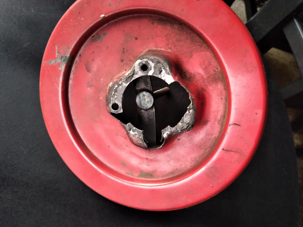

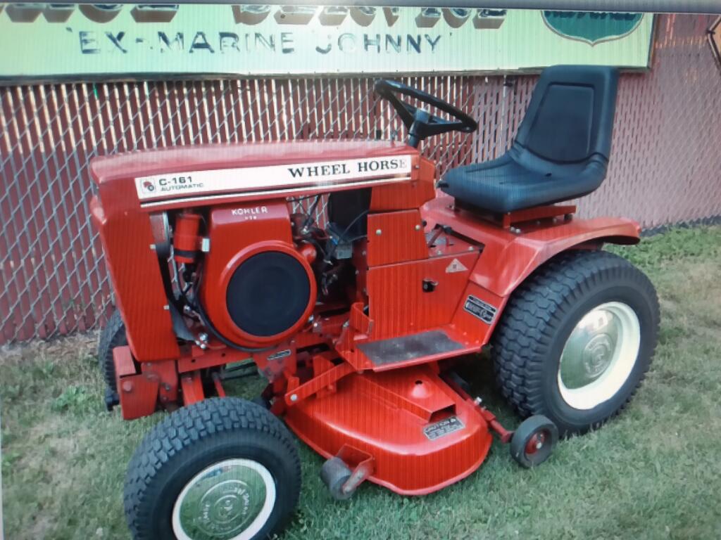

D_Mac 9,339 #22 Posted August 16, 2022 No ... I had a C-161 couple years back. I had to replace mine because of the shaker mounts. It vibrated so bad that over time it rip the sheet metal on the back plate where it screws onto the carb. Best thing I ever did to that machine was to change from the rubber mounts to solid mounts. Share this post Link to post Share on other sites
