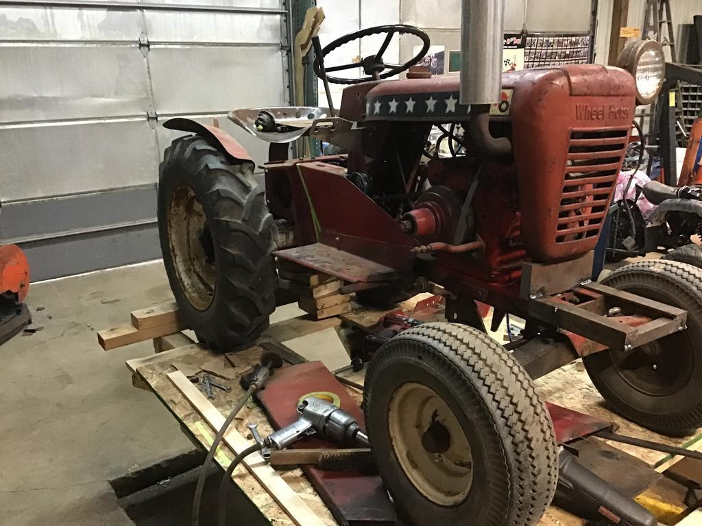

Handy Don 17,464 #4 Posted August 8, 2022 (edited) I've used, at different times, no lift, wheel dollies, jack stands, and a hydraulic lift table. Each with pluses and minuses. A lot depends on what you are doing. No lift and the dollies are convenient for simple stuff but are killers for my back. Jack stands are good and secure, and I can use my rolling stool, but it takes time to get the tractor jacked and unjacked and it cannot be moved while on the stands. Using the table I had very convenient access to everything above the frame but nothing under it. The table does have wheels that lock so I can move it easily and it's easy on/easy off. A few words of warning, though: be very aware to secure the tractor to the table so it can not slip and fall off AND pay attention to balance--the engine and transaxles are the really heavy items, but the front axle with wheels isn't light. Lifting or removing one of these could cause the table to tip. (I am considering a cradle and outriggers as table mods.) Edited August 8, 2022 by Handy Don 2 Share this post Link to post Share on other sites

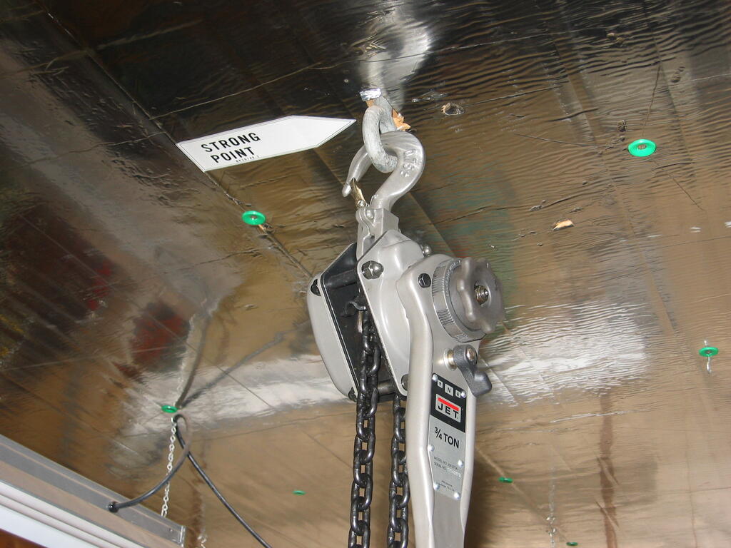

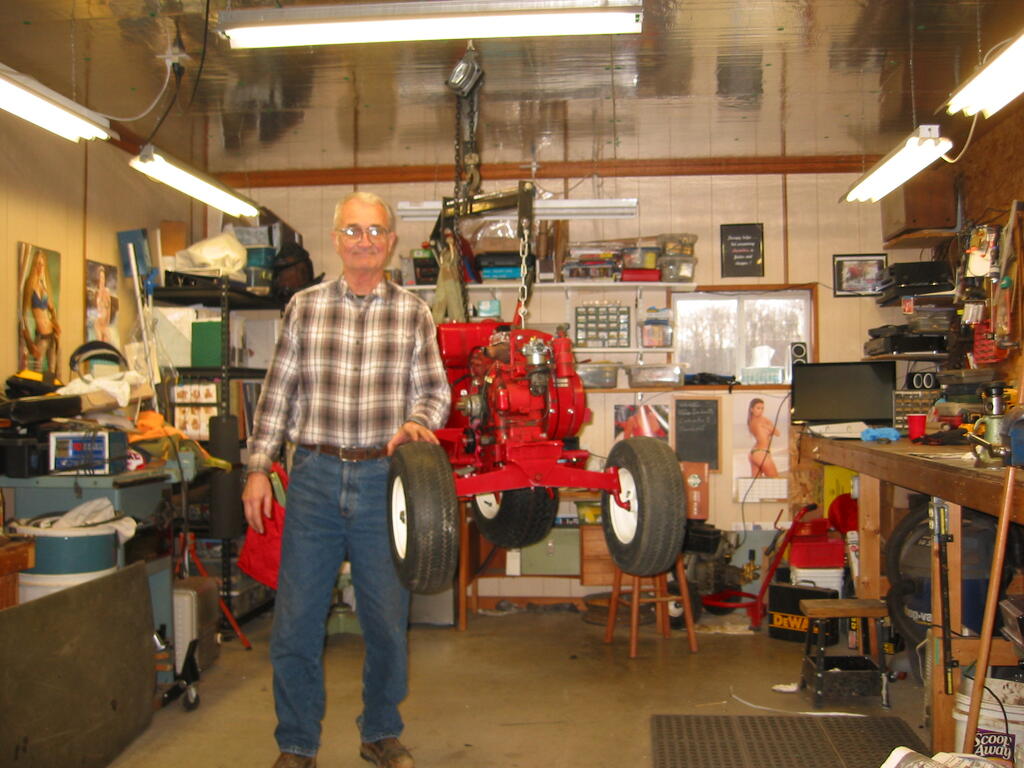

pfrederi 21,145 #5 Posted August 8, 2022 I like Airborne in this case it was a Commando 8 8 1 Share this post Link to post Share on other sites
Handy Don 17,464 #6 Posted August 8, 2022 1 minute ago, pfrederi said: I like Airborne in this case it was a Commando 8 If i had a reasonable cost way to put a strongpoint in my ceiling, I'd go this way too, though I must ask, what keeps it from moving around while you're working on a stuck nut or bolt? If would for sure make a good "Insurance" backup support when using another sort of lift! Share this post Link to post Share on other sites

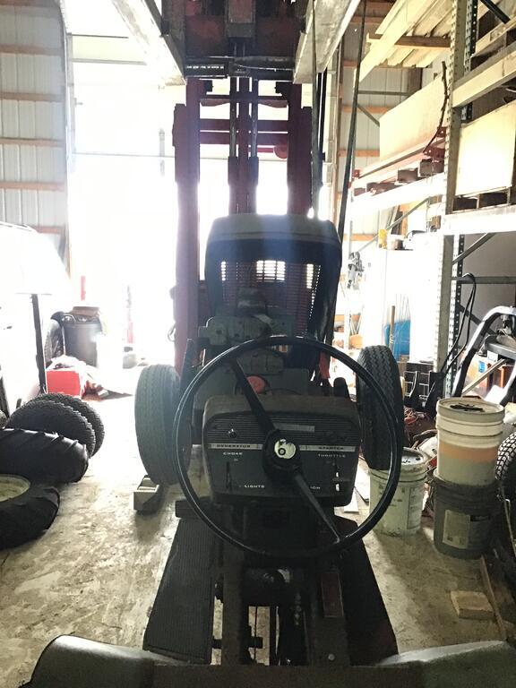

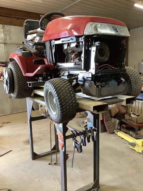

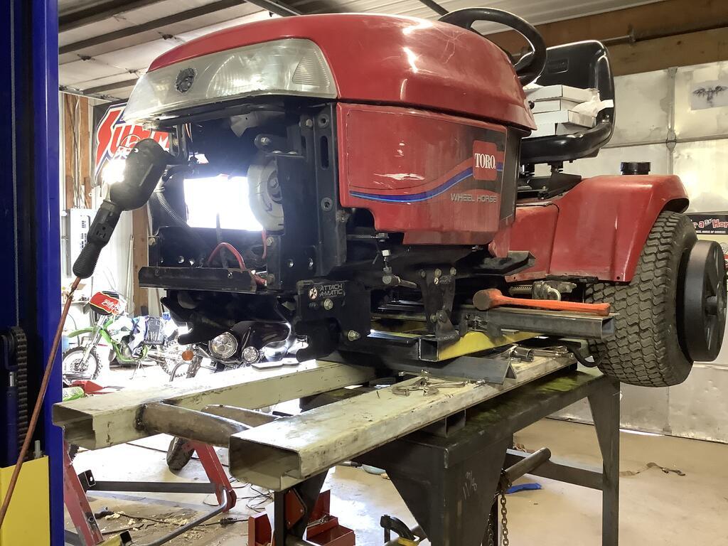

Pullstart 71,215 #7 Posted August 8, 2022 I have a couple ways, if needed. The white tubes here are my hilo fork extensions. Lift it with the hilo, set it on the table, back away. 2 Share this post Link to post Share on other sites

pfrederi 21,145 #9 Posted August 8, 2022 17 minutes ago, Handy Don said: If i had a reasonable cost way to put a strongpoint in my ceiling, I'd go this way too, though I must ask, what keeps it from moving around while you're working on a stuck nut or bolt? If would for sure make a good "Insurance" backup support when using another sort of lift! Actually I lower it on to my work table that I can roll under it. Share this post Link to post Share on other sites

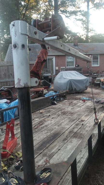

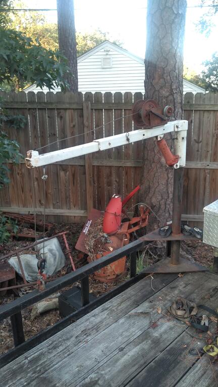

Wild Bill in VA 1,596 #11 Posted August 8, 2022 When it's gotta be lifted I use this ..... it has a two-speed winch, a brake and 1,000 lbs. lift. It swivels around and has have holes in the post so it can be locked in position with a bolt. there is a jack attached to the frame for support. Wild Bill in Richmond VA 3 Share this post Link to post Share on other sites

ri702bill 12,988 #14 Posted August 9, 2022 (edited) Kevin That stand looks a mite scary - and a tad narrow. All that weight "balanced" on close spaced "moose legs"' I would have left the hilo forks still into the extensions... but that's just me... Edited August 9, 2022 by ri702bill Share this post Link to post Share on other sites
