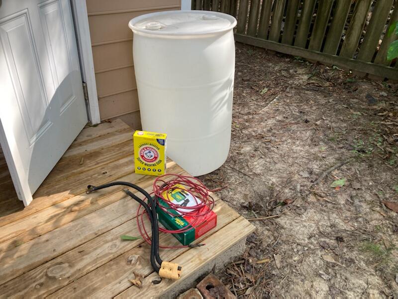

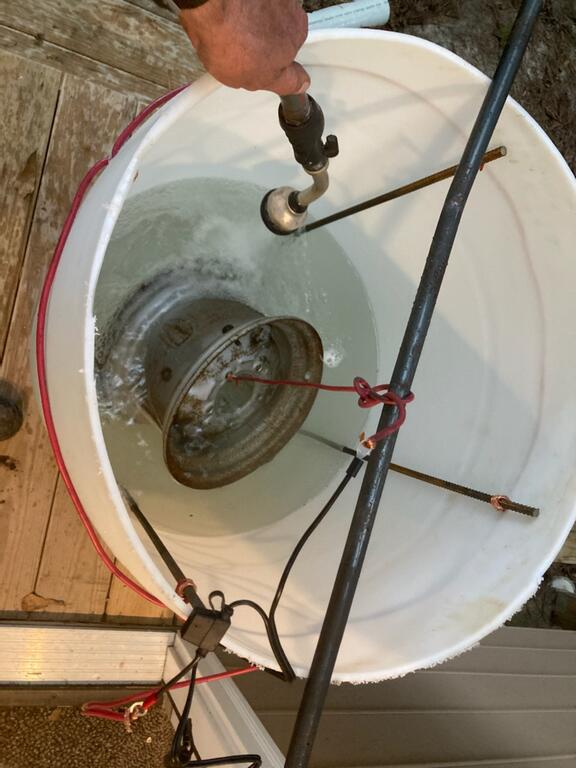

Pullstart 71,289 #1 Posted August 7, 2022 (edited) I figured I might want to start a thread instead of clouding up Mrs. P’s Ride Away Senior thread. A few key things here: 1) We are using electricity (AND WATER) to cook paint, rust, grease and grime away from metal parts. I’m not much of a safety guy and believe that sometimes you can’t fix stupid. Keep the fumes outside and we’ll ventilated. Don’t shock yourself. 2) WASHING SODA is not BAKING SODA. You want Washing Soda. Like laundry stuff. 3) Ground your part. Charge your anodes. The positive charge pulls the junk away from the negative. Like a magnet. 4) Don’t let your anodes touch your part. 5) Continue to be amazed time and time again at the ability of this low budget parts strippper! 6) No matter how gross the water looks, it never really goes bad. 7) We are using DC voltage to cook the parts. Direct Current. I.E. Batteries and battery chargers or 12/24VDC power supplies. 8) More voltage = faster results! Amperage is likely the same. 9) There is such thing as too much water. Don’t let your ground rod be in direct contact with the water. Only the part. 10) You can have any amount of anodes as you’d like. Anodes prefer a “line of sight” to the part. Any piece of the part that is not in direct “sight” of the anode is subject to lesser results. Edited August 7, 2022 by Pullstart 3 3 Share this post Link to post Share on other sites

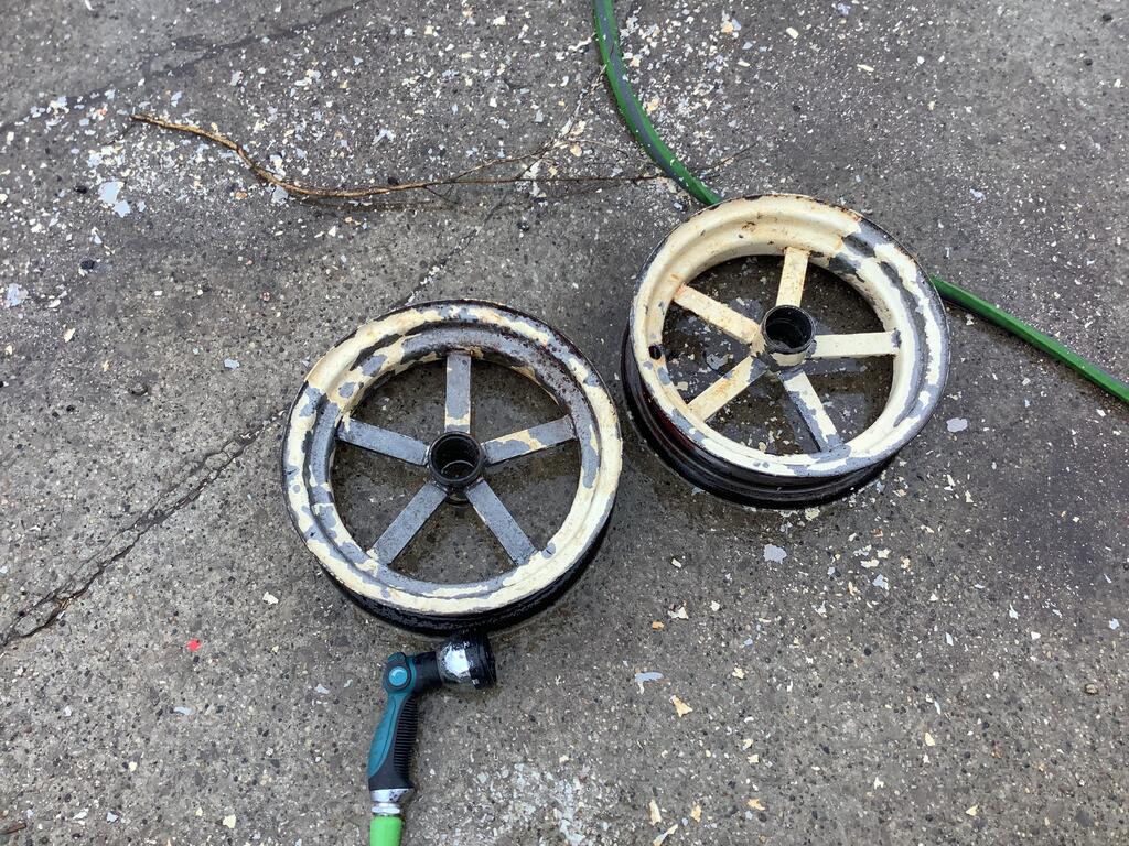

Pullstart 71,289 #5 Posted August 7, 2022 I just pulled the wheels out and shot them with some hose spray. No pressure washer! 2 Share this post Link to post Share on other sites

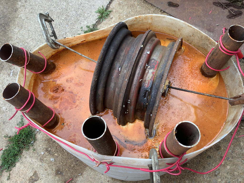

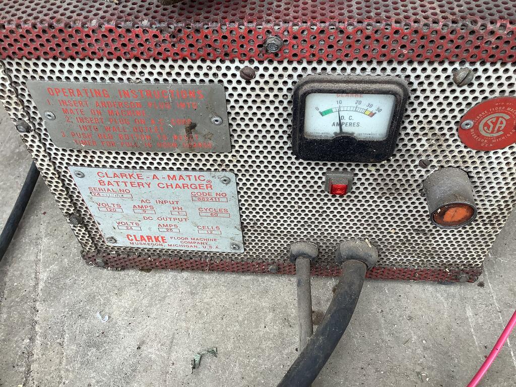

Pullstart 71,289 #6 Posted August 7, 2022 I then remembered I have a 24V Hilo battery charger! It runs on a 16 hr timer. The difference between 12 and 24 volts is amazing! 2 Share this post Link to post Share on other sites
Pullstart 71,289 #7 Posted August 7, 2022 This picture and all the bubbles is 12 minutes after starting the charger. 2 Share this post Link to post Share on other sites
Handy Don 17,484 #8 Posted August 7, 2022 That foaming looks much better. Extra juice helps, but at this rate I would check on it every hour or less--no value in staying in the tank once the rust is off. I'm using a charger that delivers 15.5v at up to 9 amps. I've been doing smaller parts are they are out of the tank in 1-3 hours. Also your anodes are not going to "reach in" to the center groove where it's facing down or away. I'd try to get the wheels laying sideways and fully immersed (suspend them with the rod from a temporary arch over the tank?) so that the groove faces an anode all the way around. 1 Share this post Link to post Share on other sites

oliver2-44 11,758 #17 Posted August 8, 2022 7 hours ago, Pullstart said: 9) There is such thing as too much water. Don’t let your ground rod be in direct contact with the water. Only the part. Just curious what you mea by this Share this post Link to post Share on other sites
Pullstart 71,289 #18 Posted August 8, 2022 14 minutes ago, oliver2-44 said: Just curious what you mea by this When I started the e-tank on Mrs. P’s front wheels of her Senior last night, the ground rod that the wheels were hanging on was submerged partially in water. I removed 2 gallons of water to get the rod out of the water and it increased the electric current through the part instead of through the water. Share this post Link to post Share on other sites

Pullstart 71,289 #20 Posted August 8, 2022 In cleaning up the place, I found my old anode. It’s thin as paper… except the rotor I welded to it! I liked the anode being under the part, to get maximum cleaning area. I’d like to at least lash together a couple of the rods with some scrap cut to length and some more copper wire. Share this post Link to post Share on other sites

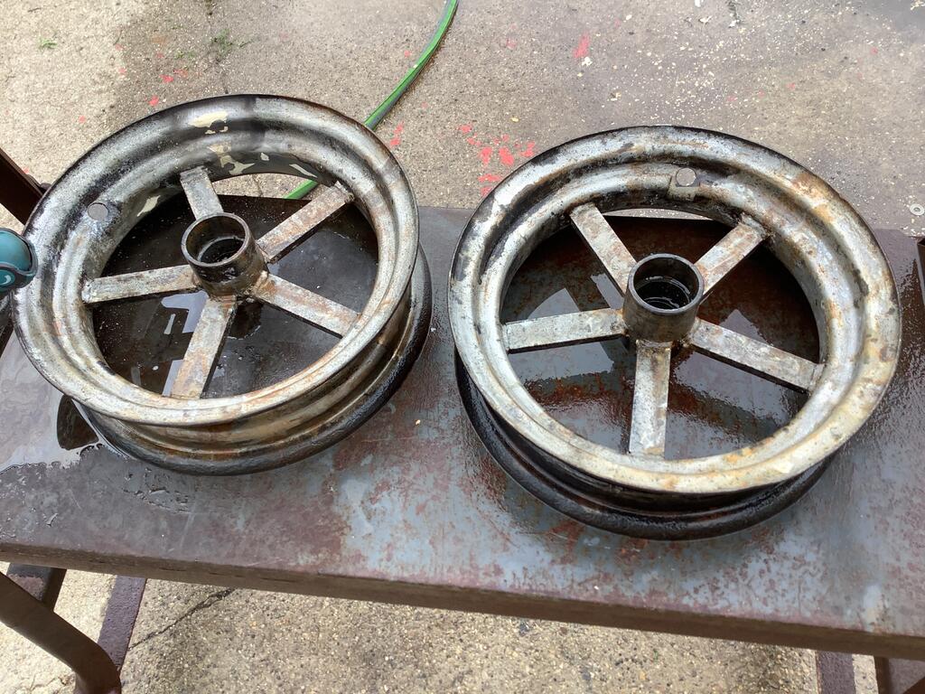

Pullstart 71,289 #23 Posted August 8, 2022 These wheels are ready for some soapy water wet sanding, a good rinse and dry, and prime and paint! 2 1 Share this post Link to post Share on other sites
